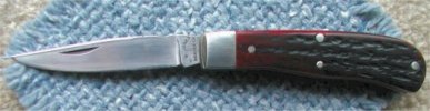

Ok, let's talk bolsters. This is going to be hard to describe here, but how do you grind a nice round bolster? I know people with good 2x72s will grind the curve of the bolster on a slack belt, but I use a small Craftsman 2x42 and I can't really let any tension off the belt. Can anyone describe how they do this or do you just have to "feel" it.
You are probably better off using a file, it really doesn't take long and you have alot of control. I paint the edge with blue (or magic marker) and draw a line for the curve to end. and start rounding with a file. (I leave a small flat edge all the way around so that when the handle material is matched it is not ground to a fine edge. Check the thickness of your handle material first to make sure you dont take off too much. If the two are close to the same thickness then file round and leave flat in the middle so you know you are not taking off too much.
Once you have the shape I use 1 x 30 belts by hand to complete the sanding up to 320, no reason to go any farther until its pinned.
Just for info, I will rough shape the bolster and then glue and pin the handle in place, and then finish the shaping. At that point I should not be removing much material from the bolster. The handle material should be just a little thicker than the bolster. Remember that if you have your handle material too thick there will be a steep angle to the bolster. Sand the back of the handle until its only about 1/32" thicker than the bolster.
I think this picture shows the flat on the edge and the angle of the handle material to the bolster, looking now I think I left it a bit thick. Let me me know when you get ready to pin the handles and I will discuss how I do it.
