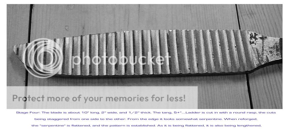

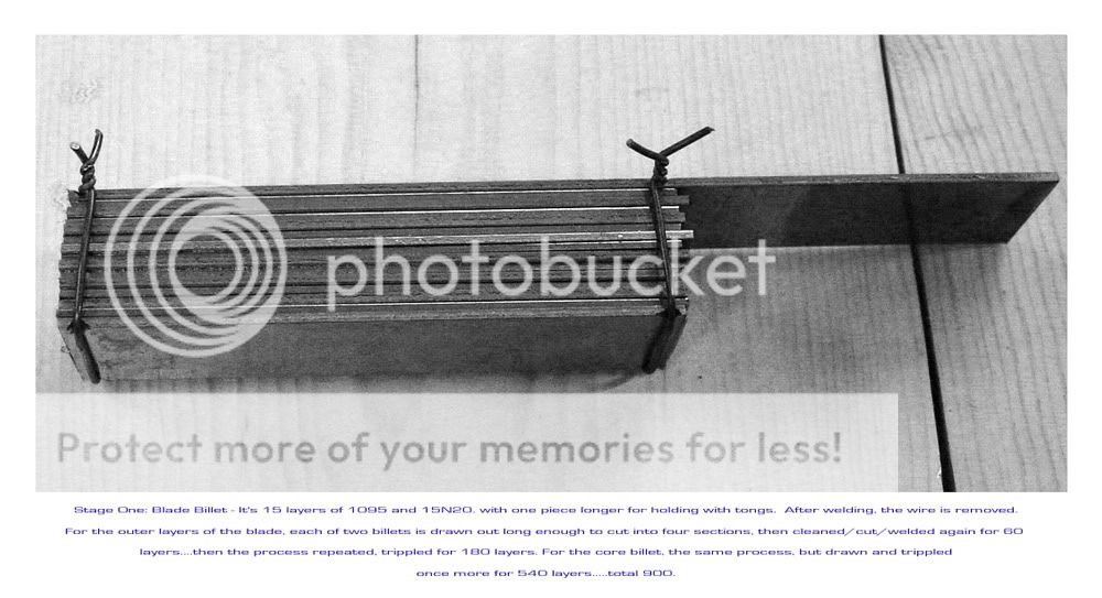

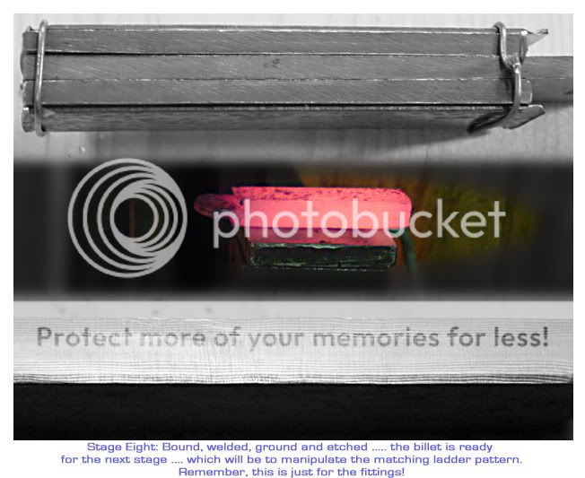

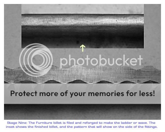

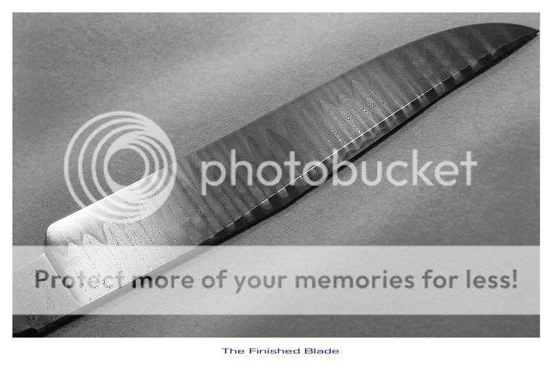

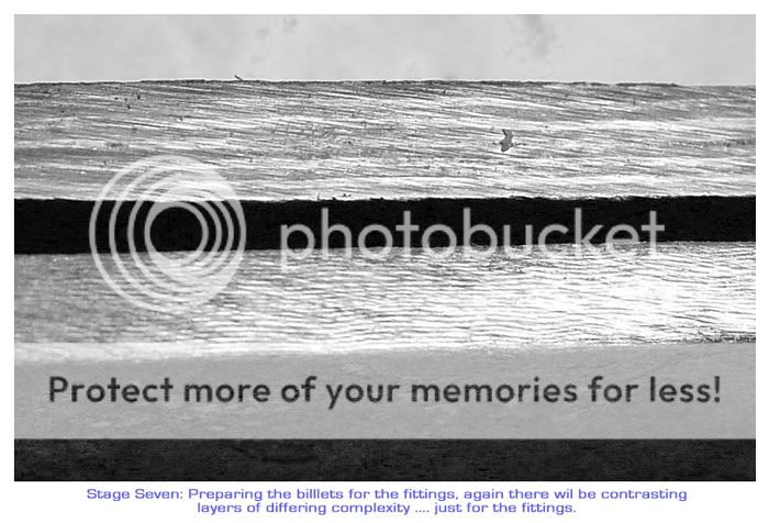

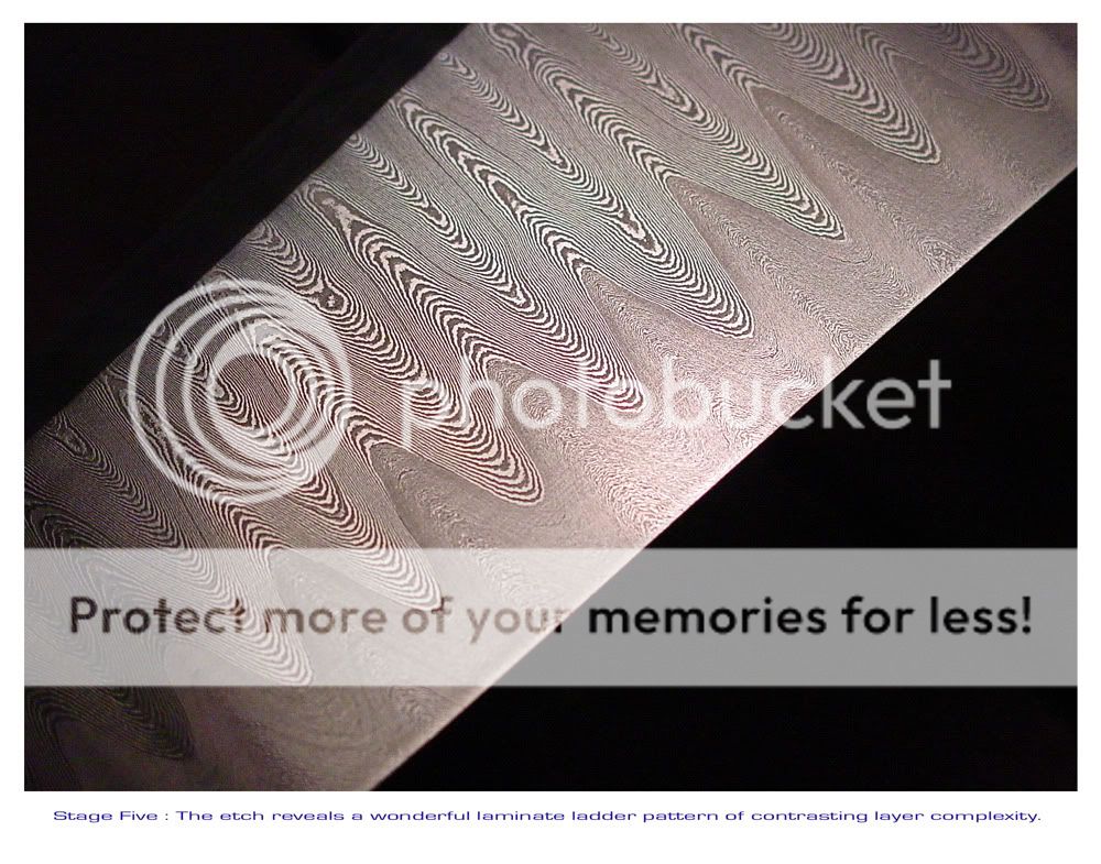

Last year I took delivery of a rather fine Sub Hilt from Mastersmith Russ Andrews ....... at the time Russ made exact profiles of the piece so that he could make me a damascus version. This thread will show key stages in its development over the coming week or two.

Beautiful demonstration with a wonderful end result!

Okay I was wondering why Russ went with the differing layer counts. Now I know.:eek::D
Most excellent my friend - that is going to end up being one heck of a pair of subhilts. I'm loving this pattern from Russ.

You never cease to amaze, nor does Russ. Fantastic steel. :thumbup::thumbup:

That steel is really something else...can hardly wait to see the end result.

Russ is taking his damascus up a level. Totally awesome. :thumbup:
