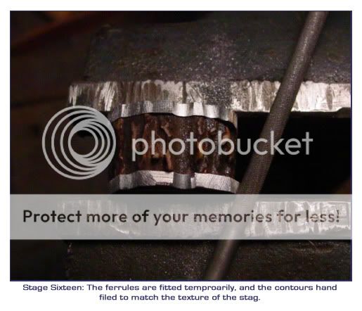

How do you know where to router from? It strikes me that you can't see where you're going with the stag from the top, so how do you get it to match up with the hole in your ferrule? Do you work the stag spacer from below so that you can see where you're going?
Seems like magic to me.
Hi Lorien,
I work the handle material first, then file out the
ferrule material. What isn't shown in #26 is the Roto-Zip
held upside down in a bench vice. The plexiglass plate
is my modification. It allows me see what I'm doing,
so as to keep the depth of the cut even all around.
The stag is hand held.
