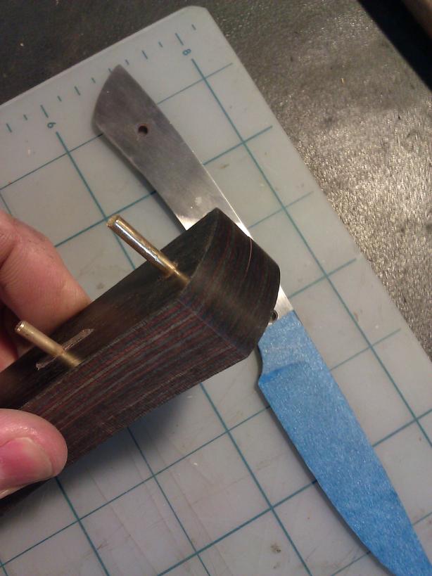

For DJ: finishing the front of the scales first.
These are rough-cut blocks, much larger than the tang. They are drilled, then pinned together to finish the fronts. Then they get glued to the blade and the finial shaping begins when the epoxy is dry.

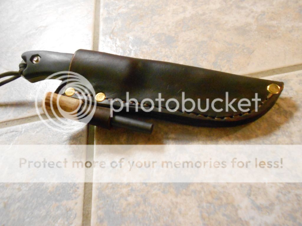

I've been dabbling in leather sheath-making too. Did this one yesterday:
First class as always daizee. I could use a few of those.
Thank you, Sir.
I'm slowly working my way through the naked axe collection. A pattern is made for the 1-3/4lb Warren, so that's next. It will get the same style.
Here's the back - the focus just came out great in this picture. I love how the texture of the leather seems to match the texture of the steel in this picture. at the mercy of the phonecam as usual...:
I need to get into that. I just pick up old forged hatchet heads at flea markets. You are quite the perfectionist.
