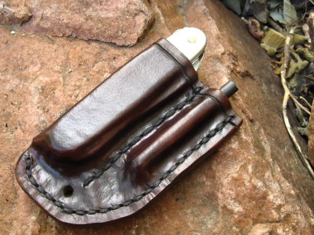

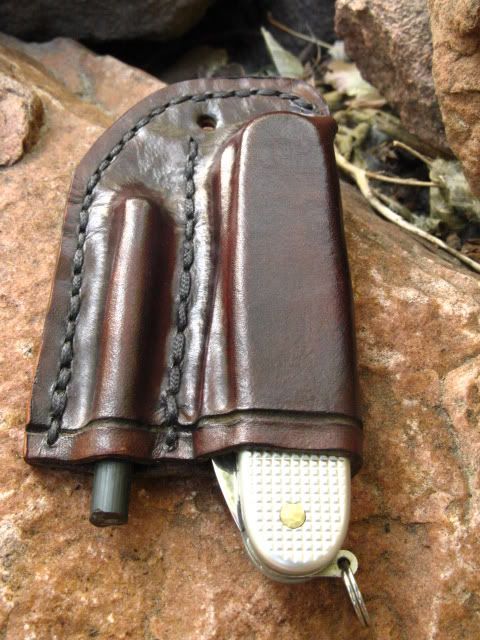

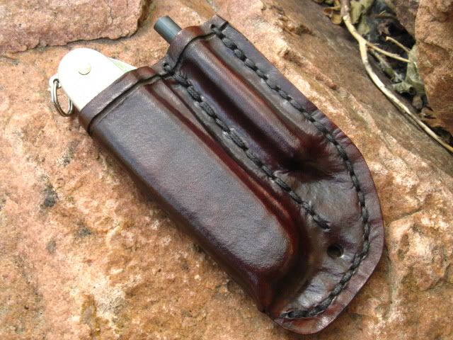

Here is a janky version similar to what you have shown. I made a regular belt pouch for a SAK Farmer the other day and decided to make up a pocket sheath for this 2 layer Farmer and firesteel. Cutting out the little notch was a great tip. I didn't do that on the first one but after seeing this thread I tried it out.
I originally though about making this a horizontal carry but in the summer I wear a lot of shorts without belts...so a pocket sheath works well for me.
Got abunch of folders that need sheathes....so I'll have plenty more experimenting to do.
Looking good there, I'd recommend stitching around the bottom of the
knife as well, even with glue, repeated inserting the knife may work it
lose, so stitching will help keep that a very snug fit.

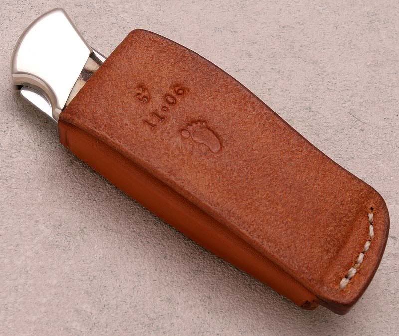

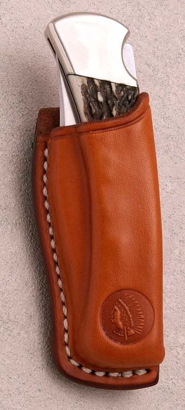

I really like your work, and I'm planning on making a sheath for my buck 112 out of 5-6 oz leather. how would suggest I make the belt loop on a fold over sheath like the one you made in your photos? (vertical sheath) any help would be much appreciated.
Mike
Thanks Ricky and Mike;

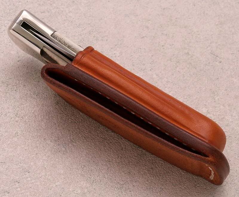

And Mike, as to the belt loop, I was going to add that to this how to but haven't
gotten time to take some work in progress pictures yet, in the mean time here
are some shots of a 110 sheath I made a while back;
Basically one piece of leather, wrapped snugly around the knife for good retention
and then the belt loop is folded down tightly against the back and stitched along
the bottom, this allows you to tilt or raise the sheath when you go to sit down or
draw the knife.
I form, dry, dye, emboss, glue, make the holes for the stitching, stitch down the side
until I reach the corner, then I pull the thread BACK through the top so now both threads
are on the same side
Then I glue the belt loop down agains the back of the sheath, nice and snug so there isn't
too much play, this will keep the knife closer to you.
Once it's glued in place, I use the make shift awl and hammer through the holes to get
through this extra layer of leather.
I use the awl to enlarge the first hole so I can get the one piece of thread back through
to the other side.
And also enlarge the two next to the last holes so I can back stitch two places to lock
down the thread and continue sewing around the end.
