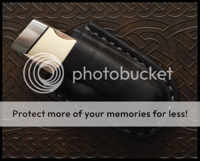

Sand down, dye and burnish the sides
finished sheath

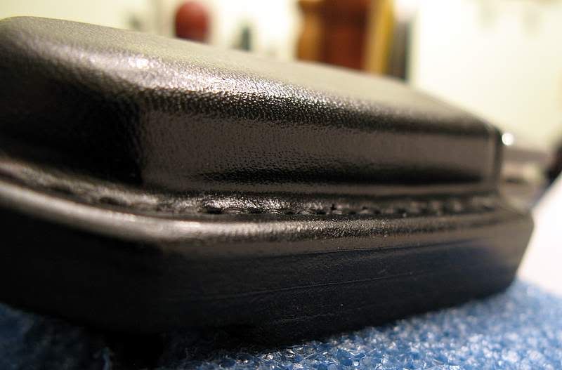

A quick question about the above pics: The edge on the finished picture looks impossibly different from the first pic. How did you you get that rolled edge after cutting?

As for the edge being rounded, good eye, that's something I've started to do a bit more in recent years
I've always knocked down the edge with an edge beveler, but now I do a bit more dangerous thing by
CAREFULLY, VERY CAREFULLY grinding down that edge on my sander, the drum roll one, and then dye
it and then burnish with the bone folder, then apply some Gum Trag and lightly sand and repeat with
the exception of the grinding down part, just do that once to get the corner knocked down as evenly
as you can, I'd suggest gluing up a few scraps and experimenting before committing a finished work
to the grinder though.
When I grind that edge down, I do it longitudinally, (paid $5 for that word ;) ) but basically I have the
edge perpendicular (that word was on special this week, $2.50) to the sanding drum and I bring the leather
up and down to sand off the sharp corners of the work. Some guys will just use a larger edge beveler
but sometimes those can 'chatter' and cause it to look not so nice, so I do the grinding way myself.

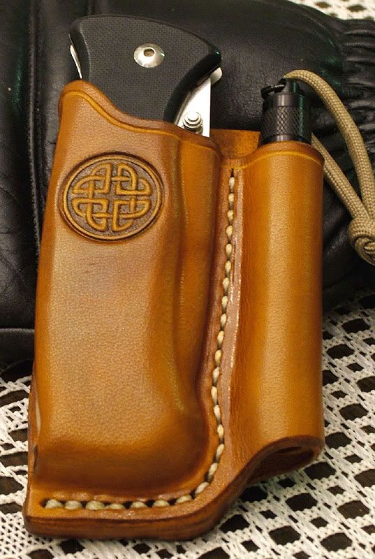

Very early on in this tread you show a picture of a combination sheath (knife-small flashlight ) .
Do you have any other pictures of this , or advice ?

Hah, leisure, well, I guess laying around all day might fall into that definition ;) but I don't feel like it, the ankle is still stinging, the incision has leaked some but I think it's stopped, insurance runs out around the 16th, hopefully the doc will also allow that I can go back to work, but doubt I can put any weight on that leg yet, a lot of healing still to go.
Now, as to the 'combo sheath' I've made a handful of them over the years, but they are a bit tricky to keep as tightly made the way that I do it, since I am not able to work leather right now, and the fact I'm not looking to make another one of these :) I'll try to give a written overview of the process involved, here are a couple images of what Ken is talking about;
OK, the sheath part is the same as for a vertical sheath, you have the wrap to go around, but in this case, make it quite a bit longer, this is where the bubble wrap comes in handy so you don't cut up too much leather or too little either.
The wrap around the knife will still have the cut out at the bottom to allow it to fold down tightly, I would continue to wrap around the flashlight as well, keeping it tight to the sheath, but it won't be fastened down yet, just to make sure you do have enough leather, the wrap will go behind the knife almost to the other edge, I cut a bevel down on the leather to make it blend in smoothly. Once you are sure you have enough leather to wrap around, you can forget the flashlight for the time being.
Continue the forming process for the knife, get it nice and tightly formed, once dry, emboss as you want and then dye the leather to the colour you like, do the light section too.
Now, go ahead and GLUE down the knife side to the sheath, and punch in your holes down and around the bottom.
I stitch the sheath from the top down to the bottom but not around the bottom of the knife, BECAUSE, I'll be REMOVING the thread once I have the light's section formed to where I want it to be.
The light side isn't really wet formed as it just forms a tube, but I want that tube to be snug up against the knife to keep things tight fitting. I'll wrap the light with the leather, fold it along the back, mark the back side where the leather ends with a pencil and then I'll remove the light and REMOVE the thread I had sewn for the knife. The knife section will still be retained by the glue at this point so it should be safe to take the thread out now, I had sewn it for protection against pulling as I formed the light's section.
NOW you can wrap the light's side of leather around and glue into place, let it set and then punch in the holes down through along side the knife...again ;) as you need to make the holes through the light's section now.
Go ahead and sew down through and finish as I've shown to finish off a vertical sheath.

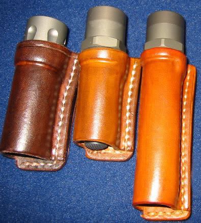

And here are some flashlight sheaths made, you can see that I formed around the light lens to make sure it doesn't slide through.
Hope that helps you some?

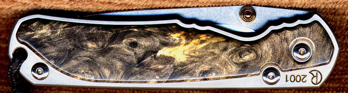

Do you have any pictures of sheaths you have made for CRK Seb knives other than those knife flashlight combo's ?
Have you made any horizontal ones ?

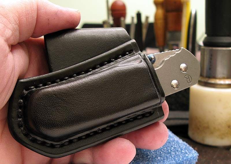

For a time, all I made were the horizontal style sheaths, and most of those were for Sebenza's, I had quite a stable of Sebenza's in my collection, alas those have all gone to new homes :( one of my most favourite Sebenza was this one, got it shortly after 9-11 and I considered the image in the wood as an eagle flying through billowing clouds of smoke, I called this one Freedom;
Seems that while I made a lot, I didn't get time to photograph very many of them :) this one is indicative of how they are formed, from the tutorials;
