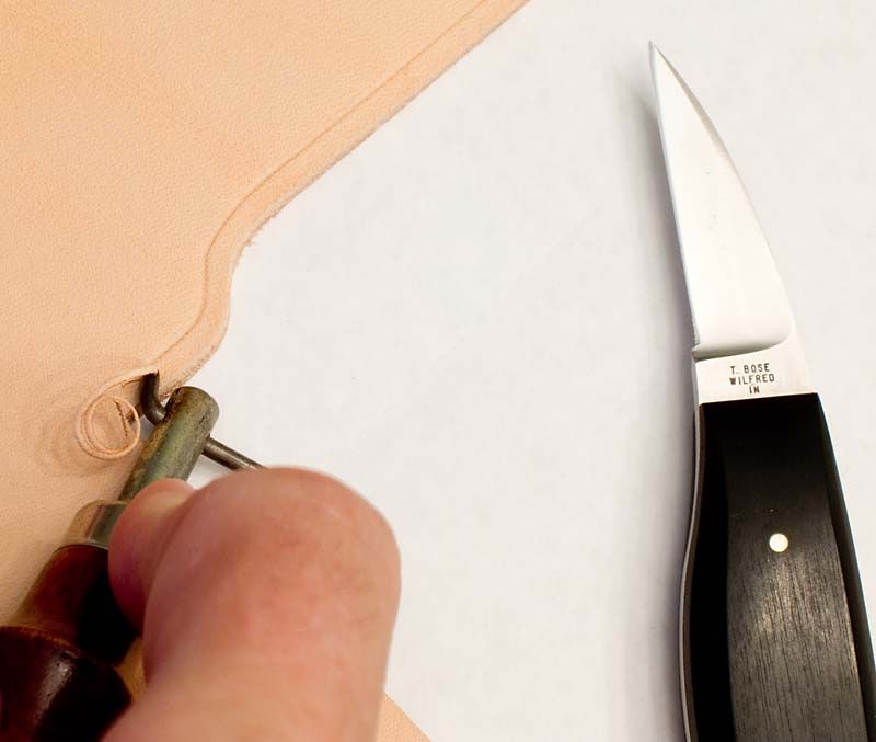

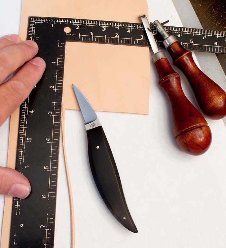

Starting with a block of leather kind of in the shape of a cleaver
I use the square to trim straight the one side, using a VERY nice
knife made by the one and only, Mr Tony Bose, thanks again Tony!

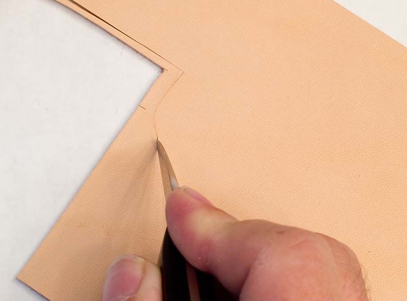

I then set the knife on it's spine so I can measure how thick the handle is
this will be how wide I make the front curved section so it's more flowing
around the spine to the side of the knife, I mark the leather with a small cut;
Then I start at the point where I cut down straight and free hand the curve
with that cut point as a reference where to slope down a little bit;

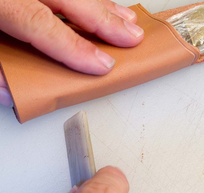

I wrap the knife with plastic wrap, to help keep the wet leather from transfering any moisture to the knife.

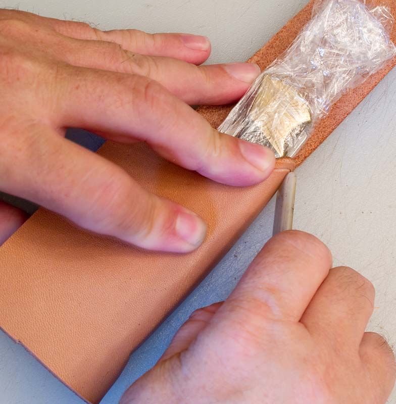

Here I've folded the leather around the knife and with a bone folder, start forming
along the spine of the knife

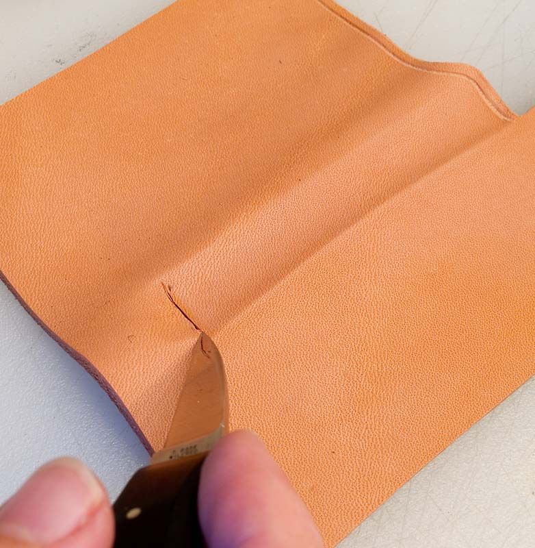

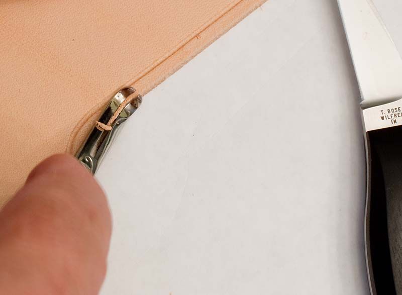

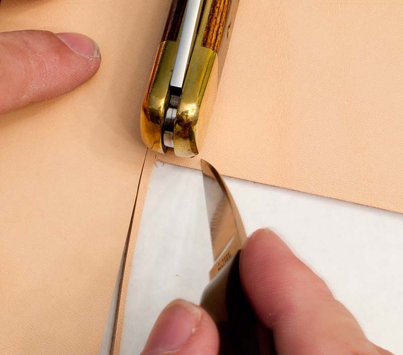

I make an indentation at the end of the knife, this can be tricky so take care
where you cut, you don't want to be too high or too low

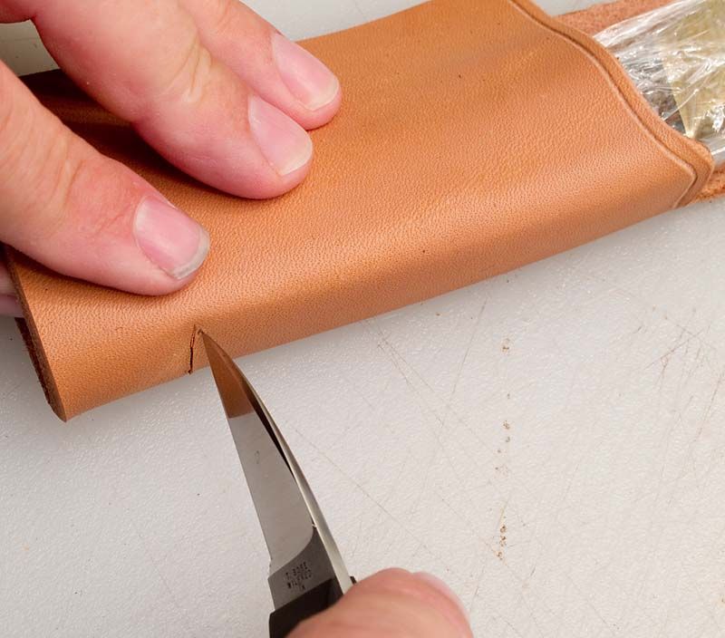

then, again using that wonderful pointy blade, slice a line into the sheath
Then opening the sheath up so you can cut out that area, this is necessary as
you are folding the leather around the knife at this point, if you didn't you would
end up with a very larger pucker of leather sticking out
continued in the next post, 10 image limit rule
G2

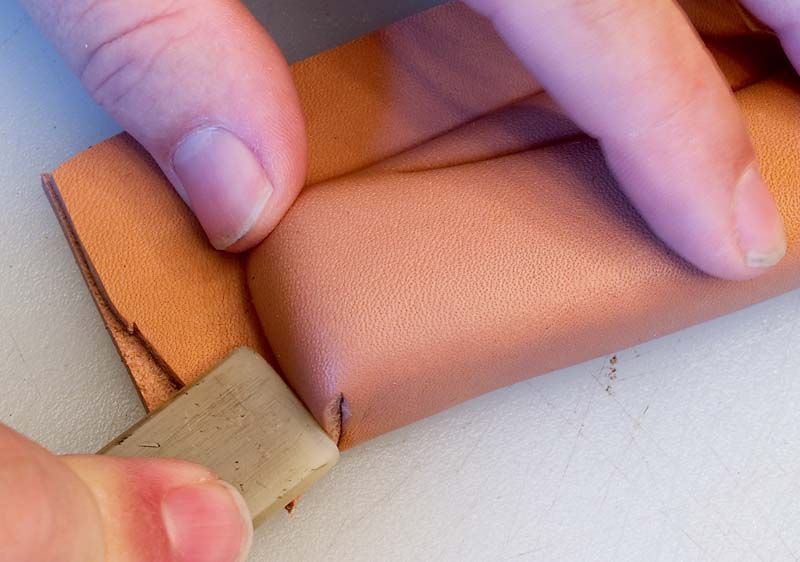

Here you can see that now I can form around the end of the knife, folding
the leather up against the end of the handle, you do end up with a small
slit there, but as there isn't any pressure against that part, it's never been
a problem to have it like that.
Notice how my fingers are pressing down on the leather as I'm forming with
the bone folder along the blade's spine? you want to be as in control of the
forming as you can, because as you press one spot, another area wants to
move too, it's all connected but you want to STRETCH that leather so that
later on it will retain it's shape for a long time and not grow to be loose.

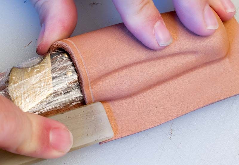

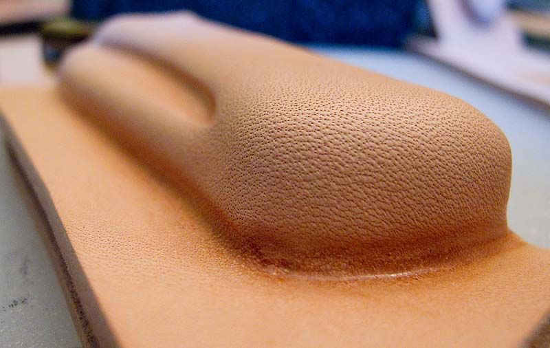

A shot of the forming, some people had thought you just sew up a pouch like
sheath and then shape it to the knife, that would just end up being pouch like
again and not retain it's shape well at all.
and tightly around the end of the sheath as well

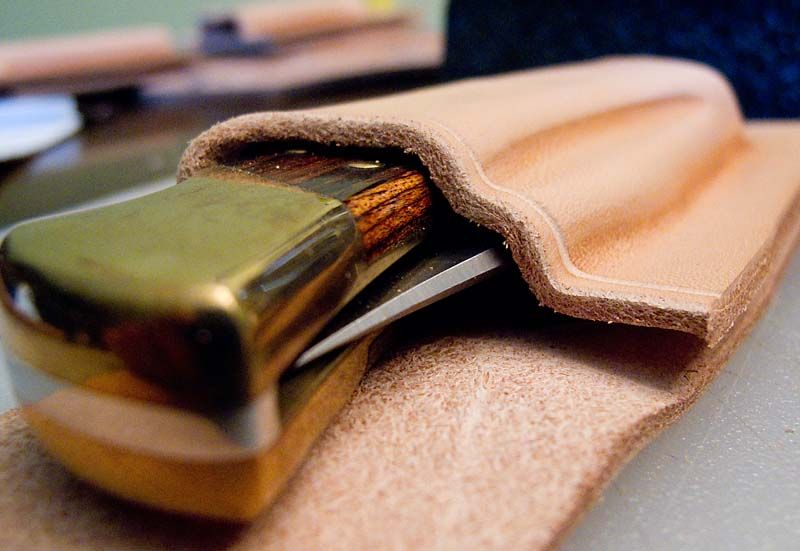

More to come, drying time takes, well, Time :) one very important thing to remember
you need to put the knife back into the sheath and keep forming/stretching
it about every 1/2 hour or so, as the leather will want to move back to it's
original shape otherwise, so keep doing this while it's drying.
I do not put the bone folder on the very top of the sheath, just where I need
to form along the edges, as the bone folder will compress those areas and that
makes dye harder to penetrate, you can see the pores of the leather in that
end shot of the sheath, where the bone folder presses down you can see
that the leather has a burnished look to it now.

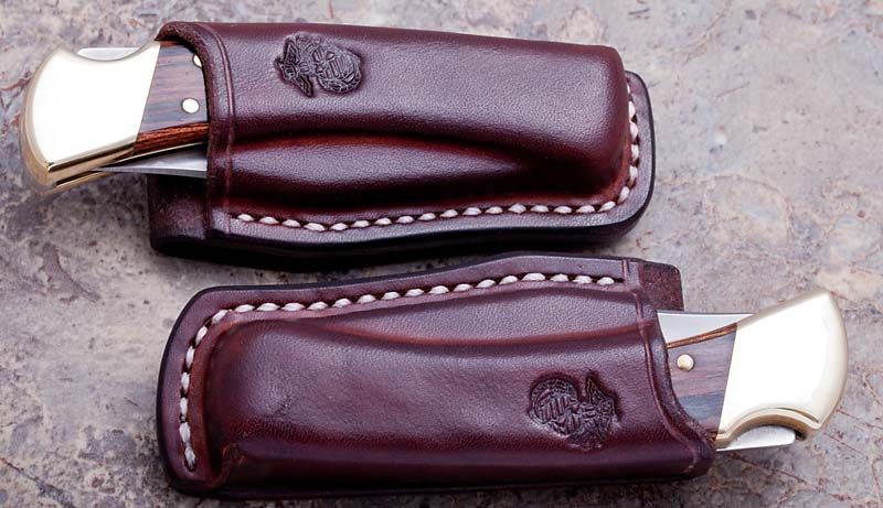

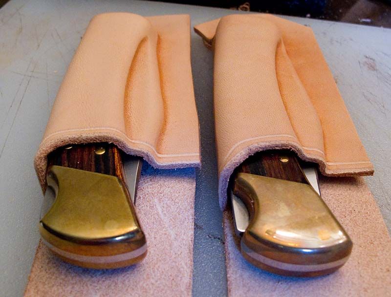

Here's a shot of the two sheaths, they'll be heading home on Monday...
I've always asked folks for their knife in order to a fitup and with the Buck 110
I tell them that the knives can vary from one to another and it proved itself
in this case, one is slightly thicker than the other.
