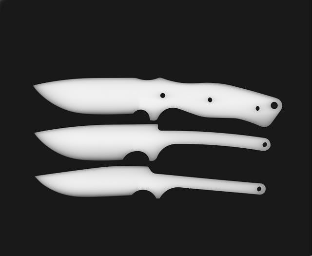

Here is a X-Ray pictures of the HRLM, 2nd Gen. Howler and SS4 for reference:

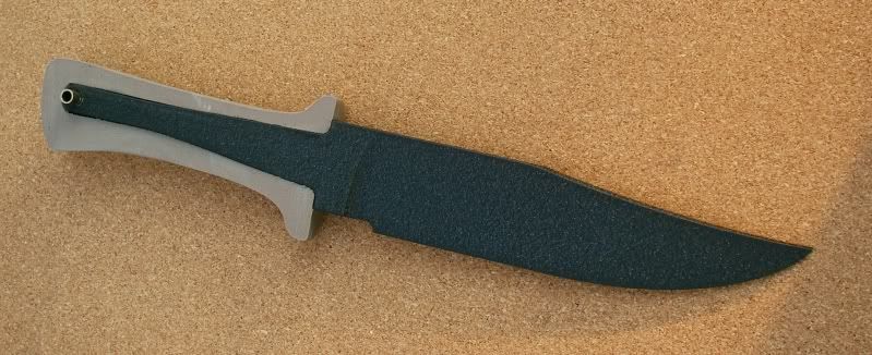

Swamp Rat tang & handle cut-away:

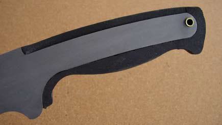

Regulator's tang & Handle cut-away:
S5CG's tang:
Notice the significantly thick and beefy radius between the ricasso and tang. Most other knife makers have a square/thin/non-radiused transition from ricasso to tang. Busse's technique is WAY tougher and stronger.
Most knife makers square of the transition from the ricasso to tang so they can add a seperate guard piece. But, here is a common problem with squared off (not reinforced) transitions from ricasso to tang:
*** I have never seen one of the Busse and kin tangs broken yet.
