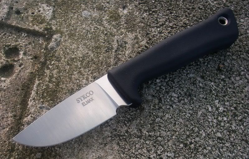

Scrapmax 460 3.45oz
Scrapmax Blade 2012 original release 3.25oz
Scrapmax 340 3.40oz
Kill Devil Sniper Hawk with G10 22.50 oz
ScrapMax 460 dimensions (AZTimT gave the weight at 3.45oz):
Blade length: 4.6" from handle with ~0.4" choil
Overall Length: 9.4"
Blade width (belly-spine): 1.06"
Stock thickness: 0.09"
Jerry posted the dimensions of the ScrapMax 460 with blade at 4.5" and OAL at 9.1875", so I will keep Jerry's numbers on dimensions as he posted. 4.5" - 4.6" in the blade doesn't seem like much, but over 0.2" in the OAL seems a bit more than normal variance for Busse and kin blades. I don't know why. But, I will leave Jerry's posted dimensions.
There always seems to be a little variance here and there in weight. 0.05 ounce to 0.1 ounce variances are pretty small variances.
I have weights given for the 460 ranging from 3.25 - 3.45 ounces and the 360 ranging from 3.3 to 3.4 ounces. Both average out to about 3.35 ounces. If the dimensions posted by Jerry are accurate, then I am a little surprised that they both weigh about the same. They are both stated to have thickness of .095". The 460 is longer, but the 360 has a wider blade. I guess those trade-offs in dimensions are enough to keep the weights about the same (???).

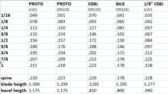

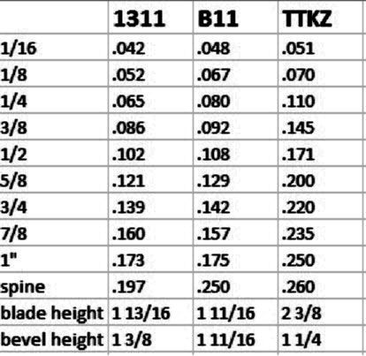

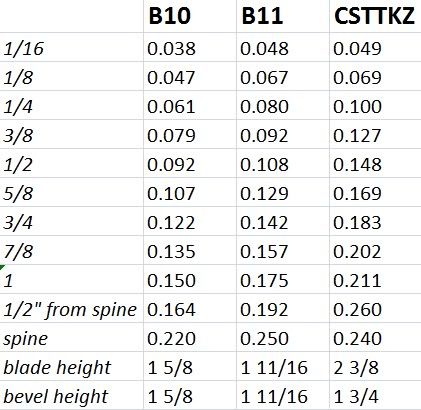

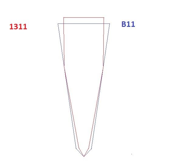

Info on the Scrap Yard 1311: weight on mine is 1lb 2.8oz. Steel is sr101, the bevel on the straight edge is set at 21 degrees per side from the factory, and around 36 degree's per side at the tip. (This is found by holding flat on an edgepro professional model sharpener, where 1mm on the swing arm's angle guide = 1 degree. 11mm below the 25 degree mark is where the stone hits the cutting edge at the tip). The methodology is as such:
These measurements show the thickness from the edge towards the spine. I initially did the measurement on the first knife I measured at 1" above the edge because thats what seemed practical. I should have done it from the edge all the way to the spine, but at the time I didn't have a set of calipers, all I had was the anvil type micrometer which limited the depth I could measure to 1".
This information can be used to give a rough idea of the difference in geometry from different models such as the B11, as shown by this rough sketch:
from an earlier post I made about it: "The 1311 is taller than the b11 with a thinner edge. The 1311 ends up at full thickness right at the same point where it becomes the same thickness as the B11, so that the 1311 continues upward at the same thickness while the B11 continues upward to become a full .250" thick at it's spine. Personally I find the 1311 to be a better geometry for cutting, even though the 1311's primary bevels are at a higher angle (so that media spreads apart faster as the knife enters it) the media spreads out significantly less spread apart. You get a better initial insertion to help sink the weight of the knife in. "
More models using the above spreadsheet format:
