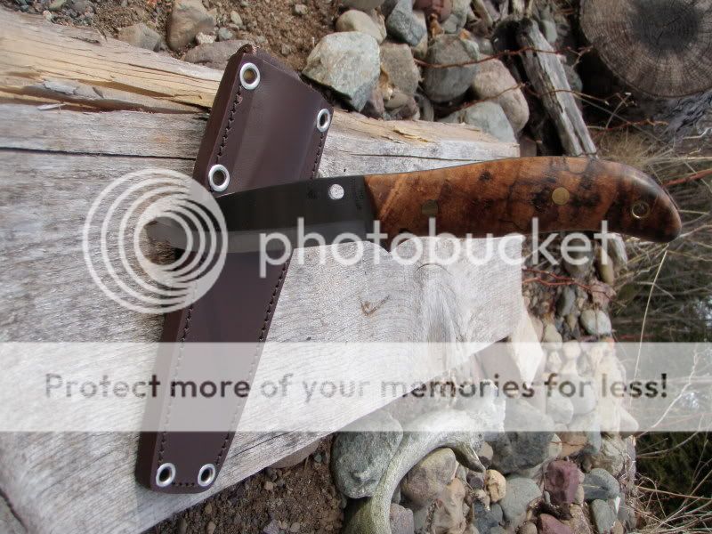

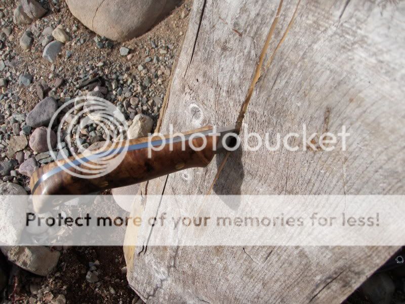

I was out getting some beauty shots of my new knives RC-4 and my Spyderco Bushcraft today.Posing them and the like .I decided to do some batoning.I chose an old board for the sake of ease of batoning and for photo impressiveness(the huge pile of split wood looks cool with the knife).I started fine the edge carved through the wood easy.I noticed the scales started to buckle so I started backing it off.When i grabbed the blade and pulled it up it snapped off clean.The skeletonized handle broke off at the first set of holes.it was a clean snap no warping or bending at all.being a factory second I'm stuck with it so I'm going to have my neighbor weld it.Hell It can't get much worse than this.
I was really shocked at this.I've batoned a lot of knives through a lot of shit wood throughout the years O-1,1095,A2 all without any issue.If anything would have broke it would've been my NWA Sierra scout on the Fundy Footpath last spring.I beat that knife for all I was worth spiting wood and it's still smiling.

A shot of the broken ends as close as I could while keeping it clear.

Wow, that is shocking. I never knew why they really skeletonized fixed blades anyway, if you're carrying it I doubt an ounce or 2 would make that much of a difference. (Not sure if that is why it broke, but..)

It won't be skeletonized when I'm done.I'm going to have the whole front hole and cracked section welded into a solid piece.No repeats.
From what i understand, the reason why these knives were sold as factory seconds, is the problems with the handle material. The steel should be of top notch, and i'd recommend you to send an email to Spyderco anyway. It isn't covered under the warranty, being a factory second, but Spyderco is a stand-up company. If they don't know about problems, even with factory seconds, then how can they make better knives?
cold steel use to skelotonize the handle on their famous tanto and gave up doing that because of broken tangs.
i assume they skelotonize the bushcrafter to achieve a better balance?? Many customs are taperer tangs to keep the strenght but get better balance but that would probably not be cost effective for a production knife.
The scales I can see. The blade snap is a head-scratcher for sure. I wouldn't expect a much different outcome if you weld it though.
