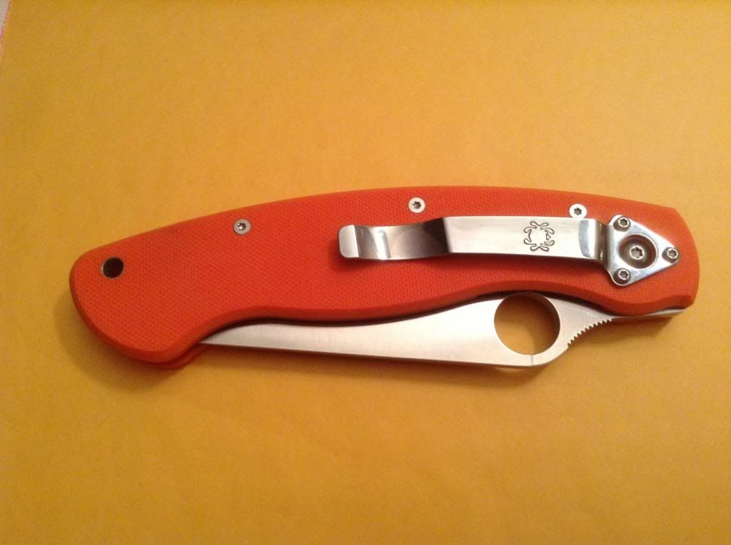

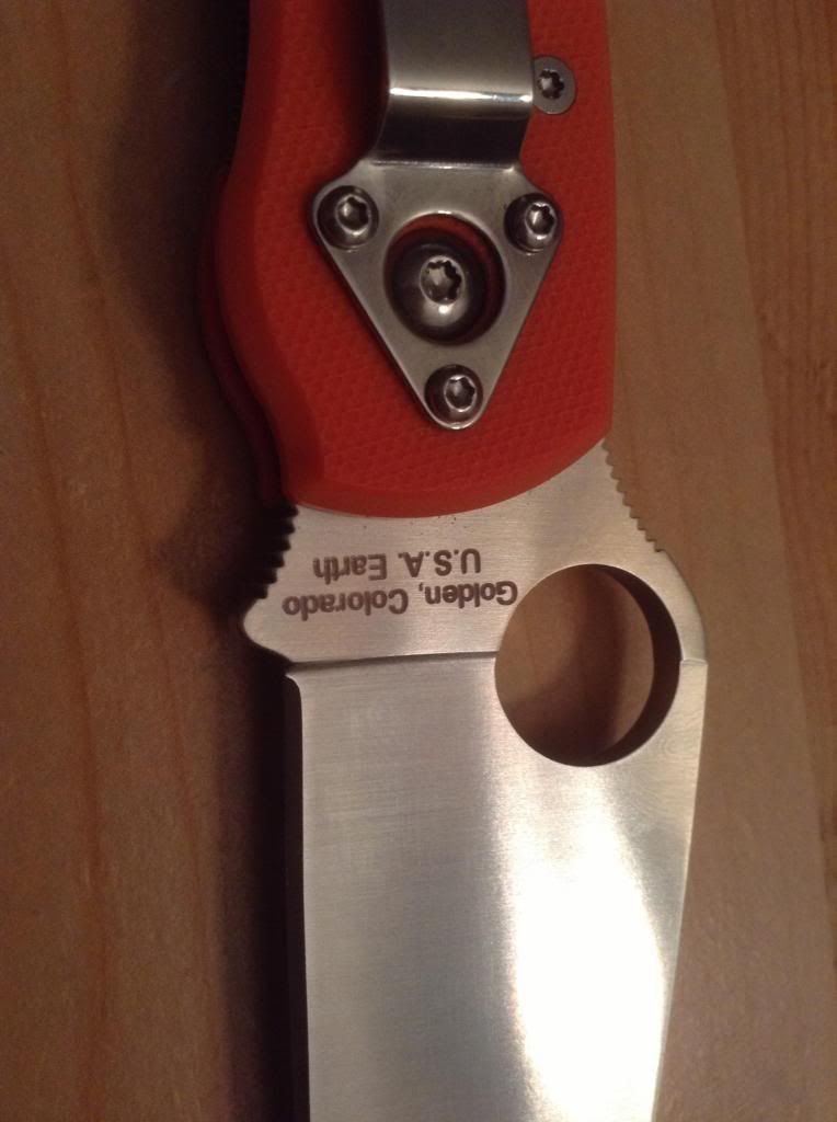

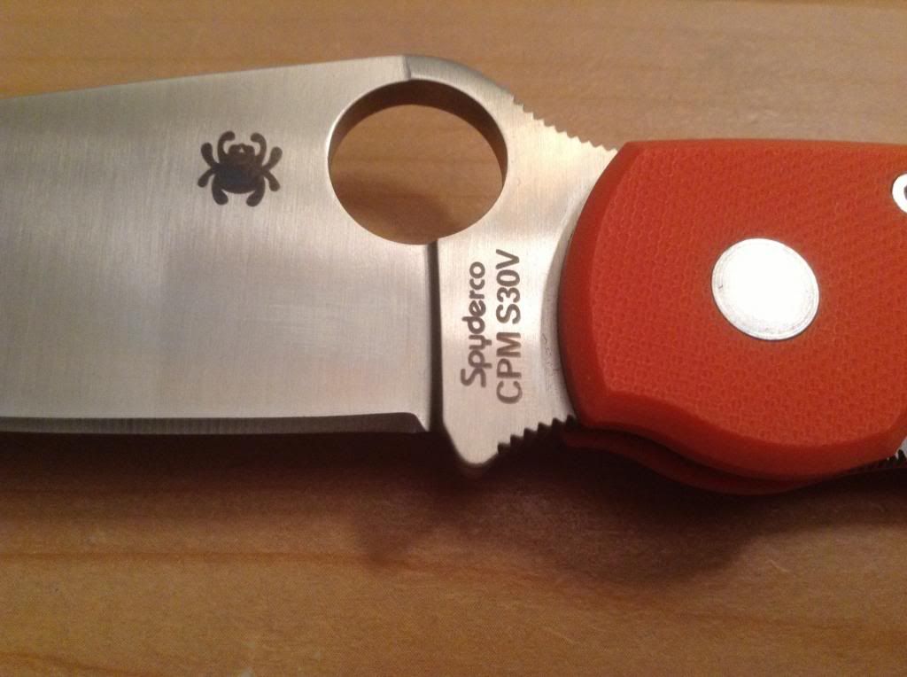

Ok guys...i got hit! Fake Sprint Military rescue orange. This thing a real scary..."real" looking scary.

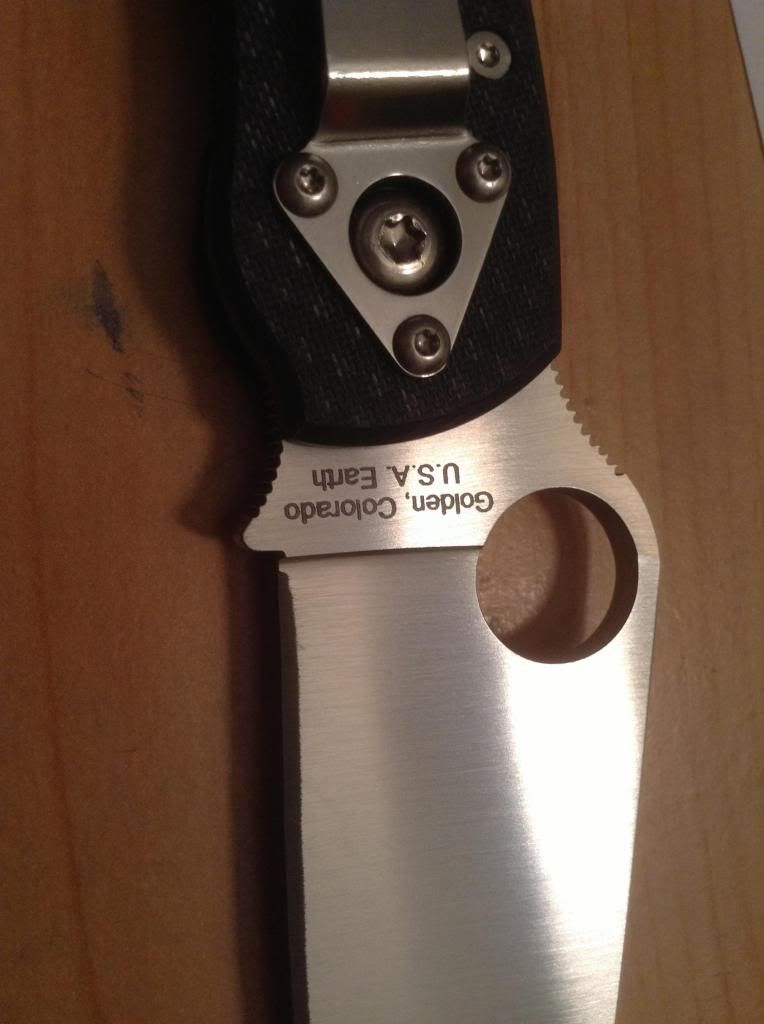

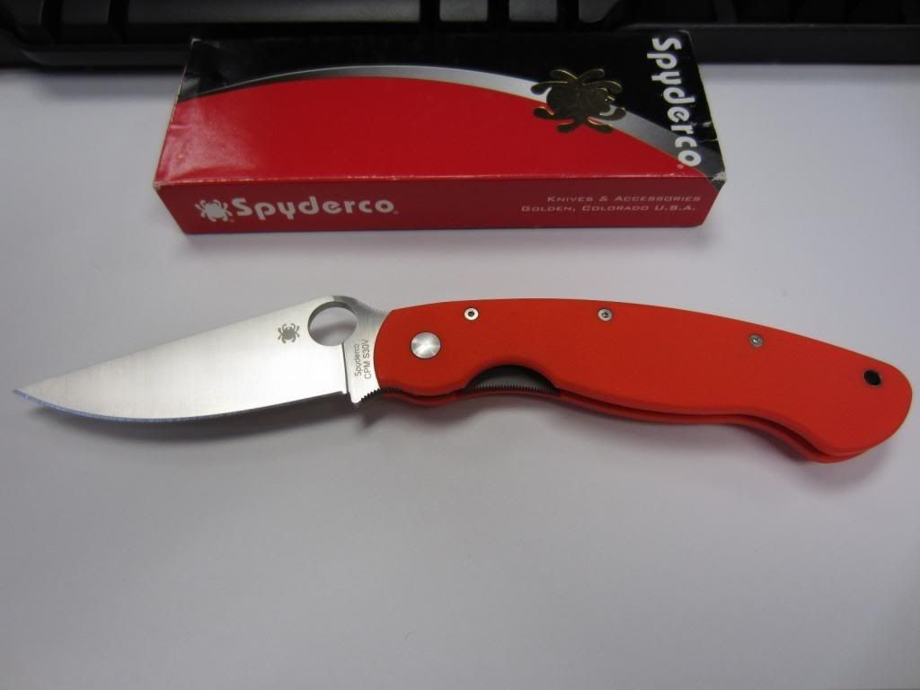

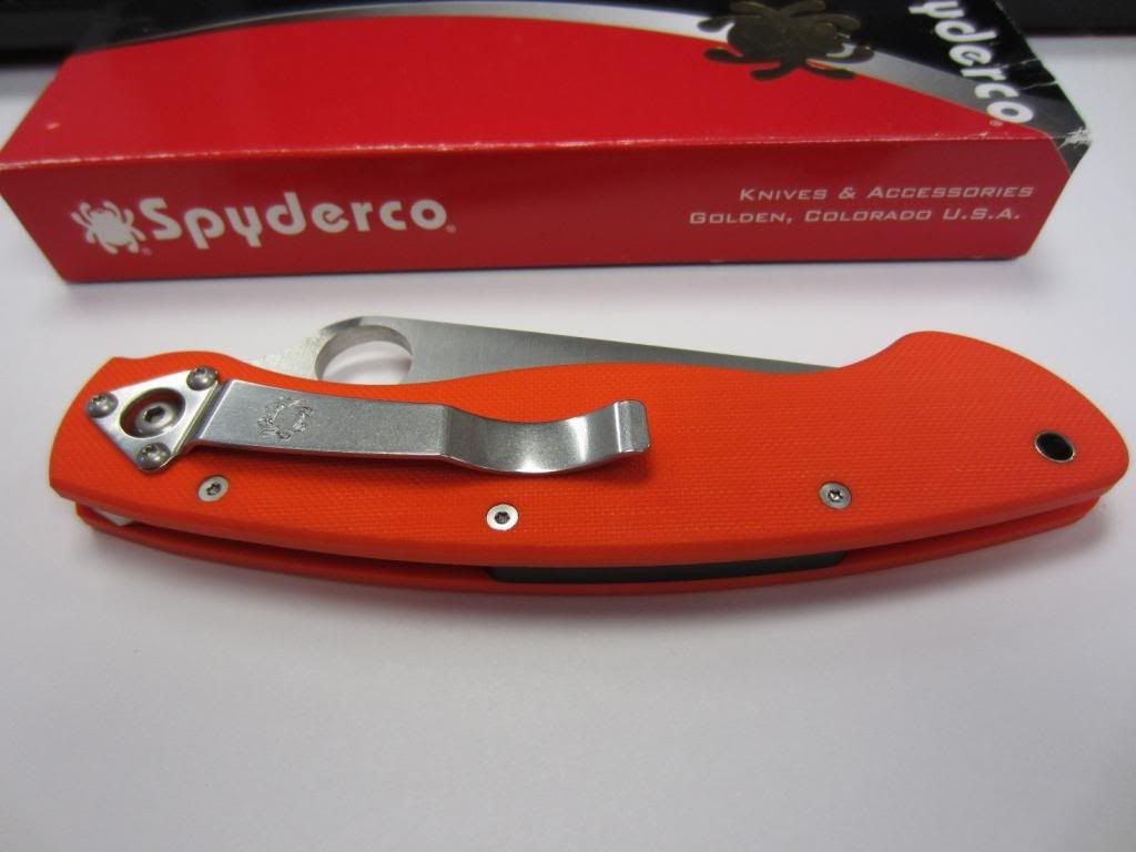

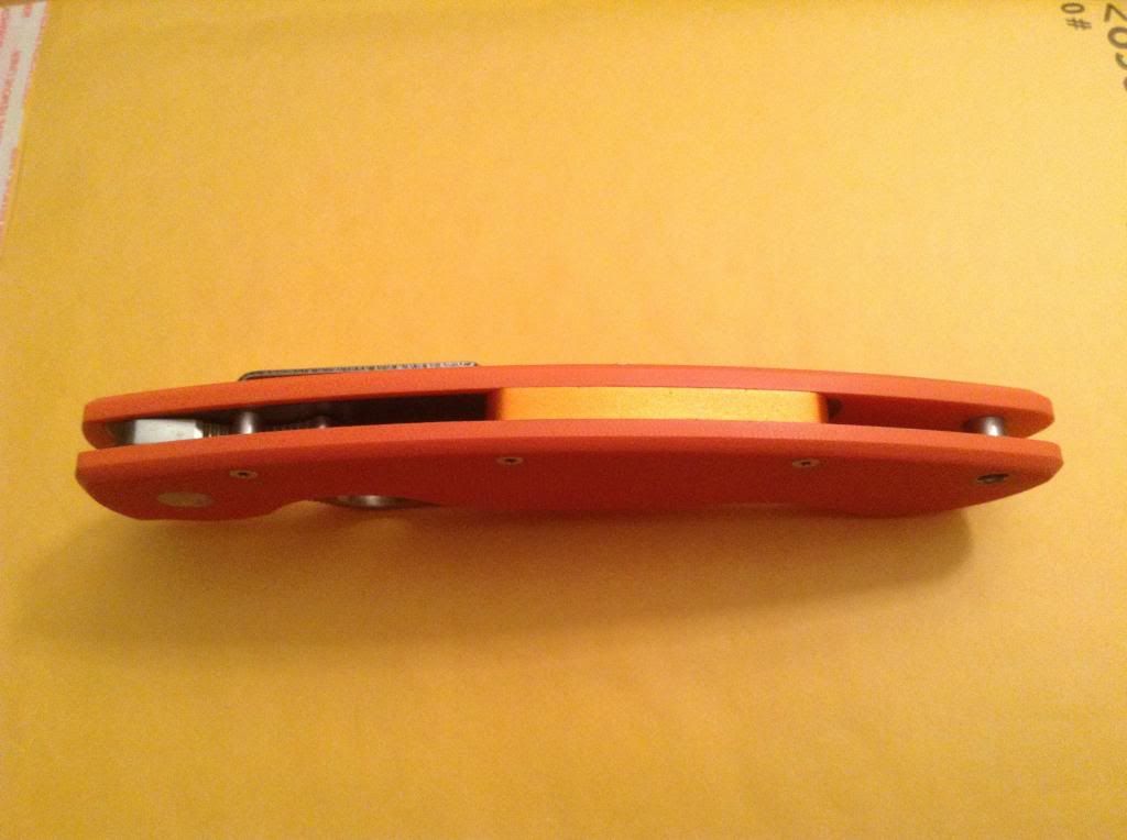

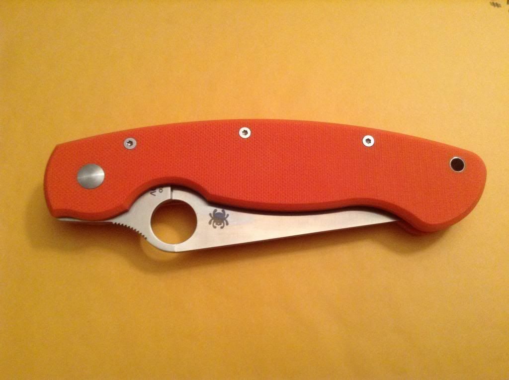

Second sign..the lettering in thicker...i put a real sprint side by side. And you can see the belly of the blade. The real one has a square Vs. the fake one slants off. Weight on the fake one is obviously heavier.
Fake:
Real.
Best way to tell is the belly of blade. Real one is square/flat , fake on just slants off.
Real:
Fake:
Man it's getting scary buying from eBay I am so new to collecting I am afraid to get taken. Where else should I stay away from? Oh and what models should I be leary about.
the only way i can tell is by looking at the words while closed. in my really genuine ti millie and a "genuine-looking" g-10 digical millie, i can see part of the 'e' and then 'rco' at the top, and and part of the '3' and then '0v' at the bottom.
but yes, the butt of the choil is different.
