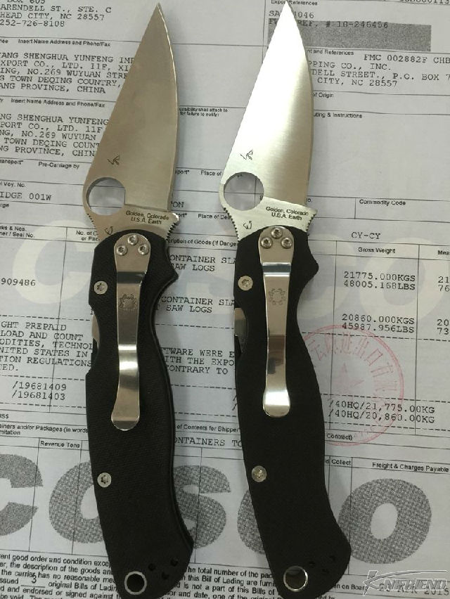

Hi, everybody, I'm new here. Thanks for this forum, I learnt a lot from everyone, recently I just bought a PM2, and searched much knives website, I know something about fake PM2, so I want to show them to everyone who want to buy this type. (Sorry, My English is very limited, if you find any mistake, please tell me, I'll correct it, thanks!)
(1)True one has a very tiny patterns on the scales, fake has bigger patterns;
(2)True's back liner plate, at left coner, it's a steep turn, fake is a smooth turn;
(3)True's back clipper is polished, fake is drawbenched;
(4)True's packing box, on the small white paper, the mumber [0] is very strong, like a rectangle shape, but fake is smooth 0, like a ellipse;
(5)The blade on the top, rear place, for press thumb, there are many sawteeth, true's should be dissymmetrical triangle shapes, but fake are standard triangles;
(6)The manufacture quality is different, fake is more sticky on deployment;
(7)True's must be used some blue glue on every bolts, but fake use transparent glue;
(8)True's blade, near the axis hole, has printed propduction date, but fake has no numbers;
(9)At scales' edges, true's has very thin chamfer, about 0.8mm, but fake has wider chamfer than it, about 1.5mm maybe;
(10)From top of the knife, we can see sections of two liners, true one left side is shorter, right side is longer, but fake are the same lengths;
(11)Every hole and shapes of liners have one starting point, for lazer cut, but fake has no this symptom.
Left is fake! notice it's G-10's parttern and sawteeth.

Left one is fake.
