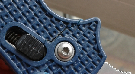

I need a little help/advice for a friend of mine who lives in Europe.
He purchased used Manix 2 with CPM S110V.
This is the way he got the knife:
He was very happy to have it and to use it, but unfortunately the knife broke in this area ( his actual picture):
Also unfortunately, he lives in a place, where there is not a big chase to have a Spyderco CS taken care of this...
He loves the knife and I'm asking in his behalf if you can give me idea how we can obtain another set of scales for it ?
I live in Florida and will be happy to purchase those from Spyderco and find a way to send it to him, otherwise if Spyderco mails those to Europe the shipping price will not justify the repair...
I thought I can ask here before I call Spyderco, maybe somebody already had such problem and they will give me some idea how to proceed, other than calling the manufacturer...
Thanks in advance, best regards!

It would seem there are two different stories about this knife (two different forums and two different posters) and a lot of confusion about how the damage occurred. Unfortunately, we do not have scales to send for repair and the only way we could evaluate the knife would be to receive it here for W&R to review. We can't make sense of the inconsistencies between the two posts and the two stories so unless we can inspect the knife I'm sorry to say there isn't much we can do.

I understand, and have no problem with this at all. I didn't post anywhere else, the pictures are from his post in another European forum.
He contacted me, asking if I can get some info about repairing the knife, I did not discuss anything than this, nor how the knife was cracked/broken.
I'm just trying to help that guy, everything else is out of my picture, but thanks for letting me know, I would be interested to see who else is posting same pictures and where.
There are people that like to make sensations out of everything, I can assure you that I communicate directly with the owner of this knife and he did not post in other forums.

A fellow member of a Bulgarian knife forum posted this today:
result of carving hard wood wedge for axe head
not the hardest of tasks for a folding knife but any knife can be broken especially those with skeletonized plastic handles
110V steel fiberglass-reinforced nylon (FRN) handle
the translucent bd1 steel version has FRCP (fiberglass reinforced co-polymer)
in this case
30v blade mounted on a 110v version frn scales
it is some kind of customisation job so I am pretty sure the warranty is out of the question but case like this can start discussion about improving the design with at least small 1/3 metal liners or full length like the endura's

I've studied the photos of the broken handle and I've tried to think of what combination of forces would cause the handle to fail in that location. (I'm a structural engineer so I know a lot about stress analysis.) First of all nobody knows exactly what happened except the person that broke the handle. The rest of us are speculating, or in my case I'm going to say that I am making an educated guess. My educated guess is that there was more force applied to the handle than you would expect for carving a wedge, and this is based partly on the effort that people put into removing the S110V blades from the handles and partly on my faith that Spyderco tests their knives beyond normal use before putting them into production. To cause the handle to fail where it did I think would require a combination of lateral bending and torsion (twist) to concentrate tension stress in that location in the handle. I think the fixed metal piece that forms the top part of the lock strengthens the top part of the handle and so a failure is more likely to occur in the lower part of the handle.
Trying to interpret this: A repeat of instances where the blade bit deep and the angle of the blade inside the wood was pointing into the wood instead of out, and simultaneously the cutter tried to pop/snap the shaving off using pressure and the torsion of the blade instead of stopping the cut or finishing the cut all the way through.
I think he's basically saying someone tried extracting the blade by prying the handles apart. That's how I interpreted it and also what I think happened.
