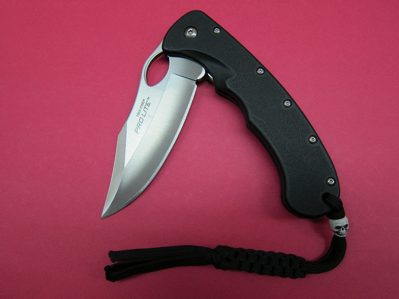

It is less efficient because it requires a greater "thumb reach" from the simple fact that the thumb "sinks" into the hole, shortening its reach, whereas on a stub it is stopped much sooner and in effect makes the thumb "longer". It is an obvious effect, and I noticed it from the very start...
Also the stud, being smaller in diameter, can have its center closer to the pivot point, meaning a smaller arc, all else being equal.
There is no doubt in my mind the Spyderhole simply asks for significantly more reach and motion to open.
The big advantage of the Spyderhole is it affects the function of the knife not at all, offering no protrusion, and that is why I still like them. Also, in my experience, the thumb stud being a protrusion, it can be tugged at by the pocket fabric or other items, making it a poor combination with a typical liner lock, due to the risk of partial opening. A Spyderhole and lockback is the safest possible combination, while a thumb stud and liner lock is the worse.
The most efficient "Spyderhole" I have seen was a variation of the design I have used for years on the Cold Steel "Pro Lite" series, where the hole was squeezed into an oval, which greatly reduced some of the height/reach issues:
That particular range of knives were to me the best folders I have ever seen or used, and I usually hate liner locks...
I have big hands, so if the reach issue is noticeable to me it should be noticeable for most...

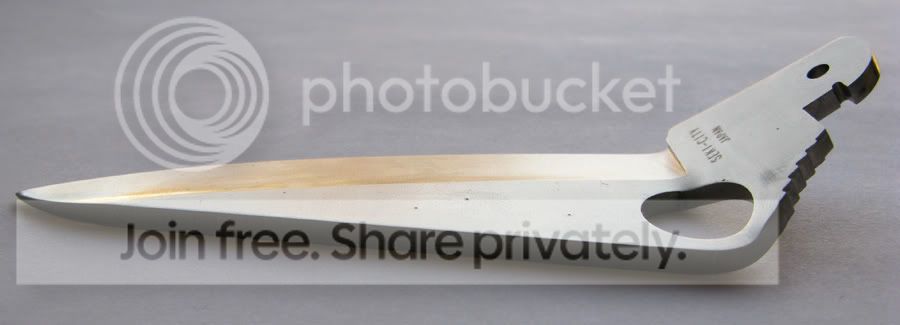

Also; a bad example of a wannabe spydie hole. ( Sorry fox, it doesn't work LOL.) :thumbdn::grumpy::rolleyes:
