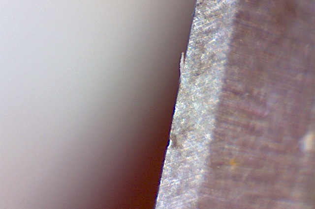

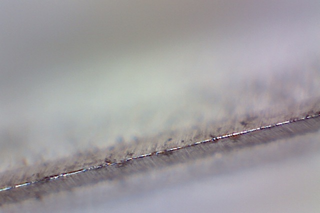

I just got the microscope I was waiting for, it's a fairly cheap USB version, but should allow for a closer view to help see what's going on. Below I've attached some images take of the edge of my EDC blade (I'm still at work), these were taken handheld.
Note again, that these are not photos of the test blades, just a quick test of the microscope. Once I get to the shop tonight I will be taking photos of the edges of the test blades.

Yeah I agree. I've used the exact same edge geometry in the past (including during the first round of testing) and it has shown itself to be quite robust. I'm sure it could be tweaked, but I'm fairly sure that whatever issues are happening right now is quite likely to be an issue with the heat-treatment...
