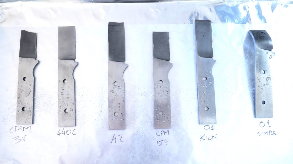

Basically I put all the blades on a piece of aluminum foil, then a piece of waxpaper on top of that to prevent any possible issues with galvanic corrosion. I then sprayed the whole batch with plain water from a spray bottle every few hours. They were kept wet the entire time expect for just in the early morning when I forgot to get up and re-spray them...
So here we go!

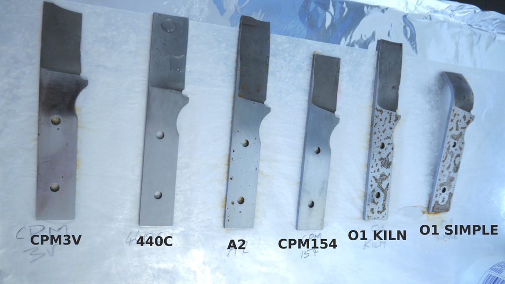

The difference between O1 and A2 was huge. The O1 pitted badly and almost immediately. The A2 had only minor pitting and that took quite a while to develop. The difference between A2 and CPM-3V was significant, but nowhere near as big a leap. The CPM3V only has 3 small pits on it after cleaning, whereas the A2 has about 8. The CPM154 formed small amounts of rust on the sandblasted part of the blade, as well as on the reverse side in the engraving. The 440C simply refused to rust, there wasn't a spot on it anywhere.
I was surprised that 440C beat CPM154. Perhaps saltwater would affect them differently, but I'm not hugely interested in testing that.

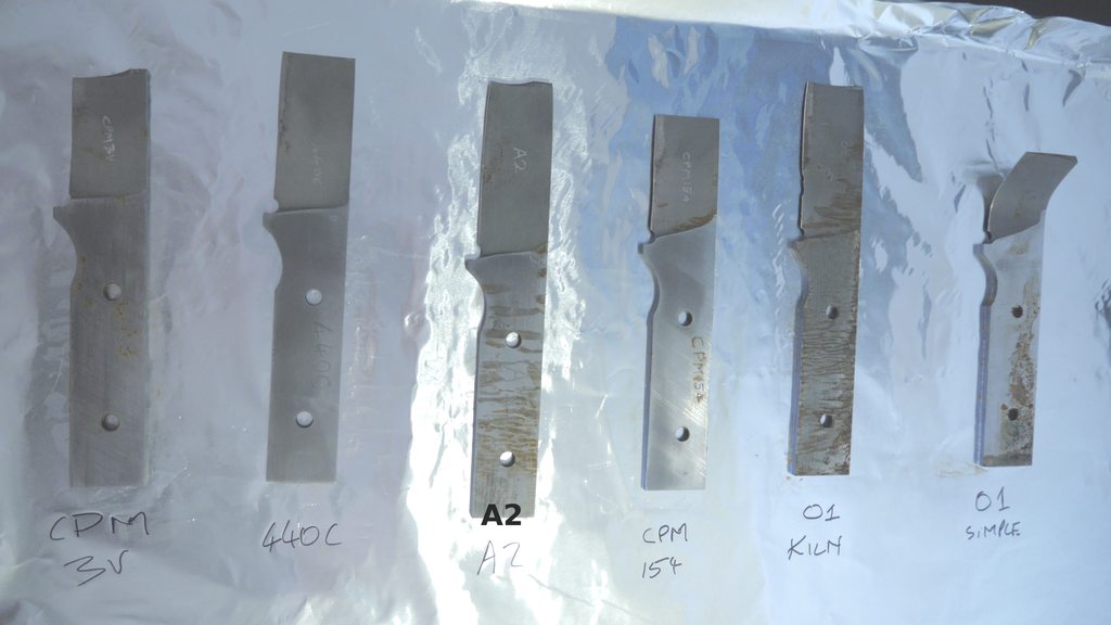

The top side of each blade was polished to around 400 grit, then finished with a 800-1000 scotchbrite belts. I deliberately left the finishes much less than perfect as I wanted to test what would happen after a user had scratched up and used the blade. The bottom of each blade was finished to 120 grit and left there.
Before:
After 24 hrs (top which is finished somewhat finely):
After 24 hrs (bottom which is finished to 120 grit):

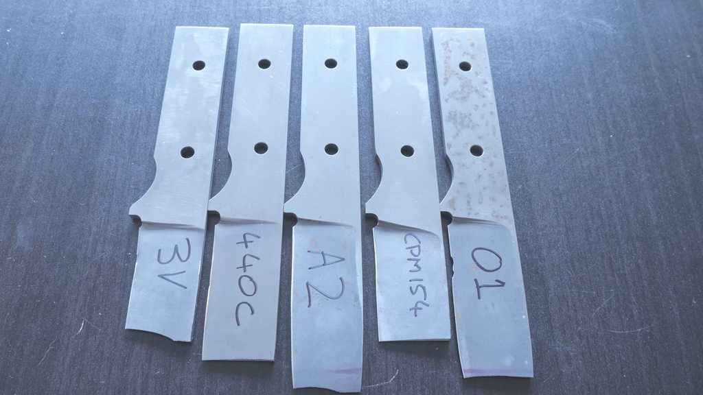

Then I wiped each of them down with a green scotchbrite to differentiate between pitting and just surface rust. You can't see it very well but the A2 blade has about 8 minor spots of pitting. The CPM3V only has 3. The O1 is covered as you can see, and the other blades were not affected at all.
Personally I'm somewhat surprised that A2 and O1 are so different purely because I had never given the subject of corrosion resistance in non-stainless steels much thought. I have found O1 to unmanageable in kitchen blades (at least the way I treat them) but I would guess that A2 or CPM3V would both be fine for my use.

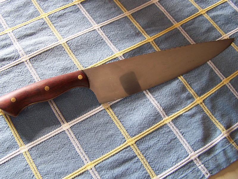

This is an O1 chef's knife after 4 months of daily use. This was the 1st knife I made with a known steel, after giving up on scrap steel.
Nice! I think the main part of the problem with the knife that I made for myself was that I didn't finish it to a high enough polish. I'm sure that with a bit more finishing it will be much more stain resistant. That blade was intended as an experiment to see how hard it was to finish after heat-treat... Turn out if you're finishing by hand you shouldn't leave a blade at 60 grit! Now that I've got the grinder I'm sure that re-finishing that blade is much more practical.
