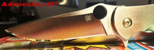

Thanks man! I still need to invest in the 1500 diamonds, apparently it’s night and day? Can you attest to this?^^ Looks outstanding!
Not sure .. I don't use them but guys on the WEPS forum seem to like themThanks man! I still need to invest in the 1500 diamonds, apparently it’s night and day? Can you attest to this?

Always a pleasure viewing your work Scrim!
