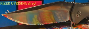

I'm not sure I understand the mirror edge thing.
Because an edge is shiny doesn't mean it's sharp. In fact, it could be incredibly dull.
If done properly a mirror edge can be hair whittling sharp..plus I’m one of those that believes a mirror edge in fact does hold longer than a “toothier edge”
15 DPS makes a big difference.
It does, and I did wipe the blade down with rubbing alcohol and a microfiber cloth to remove any residual gunk just before I shot the video. But it is what it is, a well used edge (for a few days at that point) that's holding up nicely. To be honest, I haven't taken this one out of the (edc) pocket yet. I'm surprised at just how much I'm liking this particular Kizer. I also took a little tension off the lockbar and love the action. Now it's as smooth and as drop-shut as any Shiro or Thorburn (my smoothness benchmarks) that I own. Hate to sound like a McDonald's commercial, but...I'm lovin' it.
