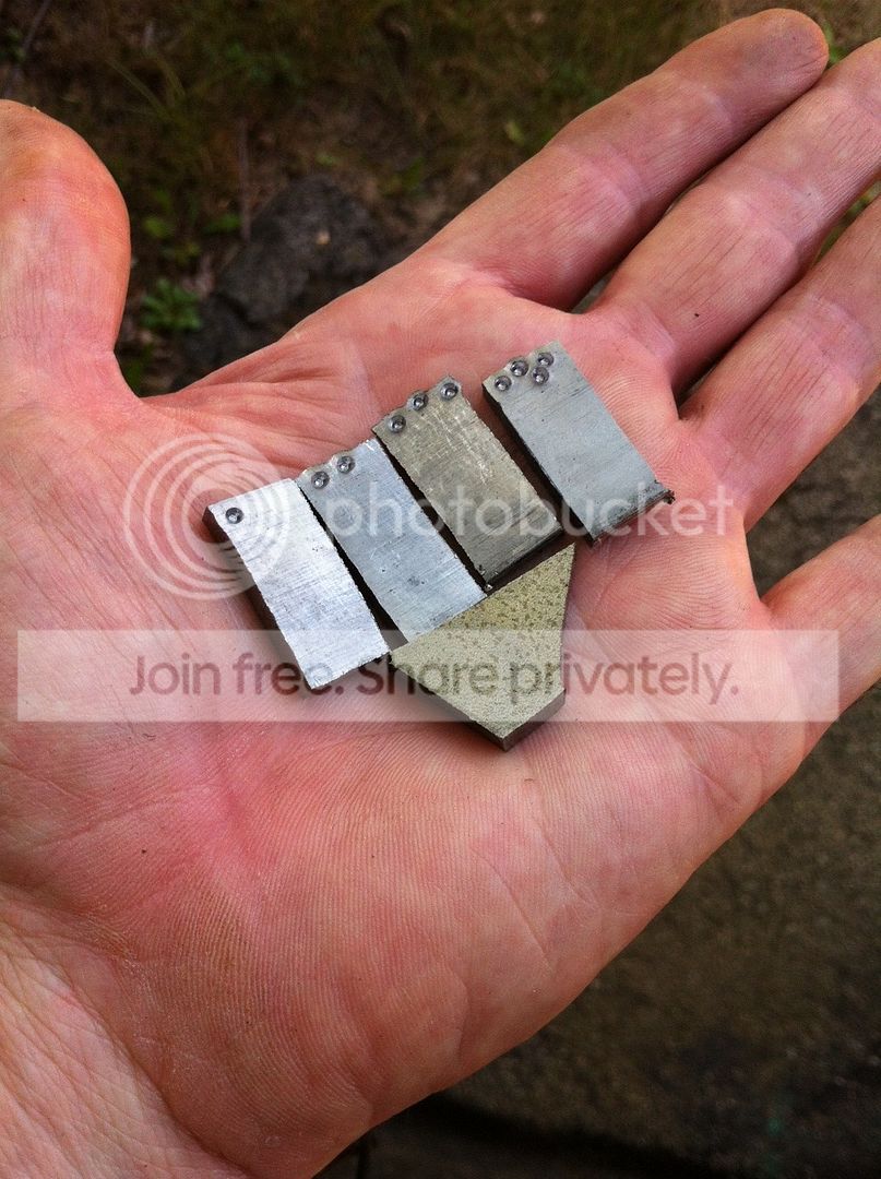

Anyone who read my thread on testing 1095 with different quench mediums will know that I realized after I normalized my test pieces that the decarb layer was much thicker than I realized so I couldn’t go back and retest the sample pieces to see what the hardness was deeper below the surface.
So I thought I would revisit that test taking hardness readings at various depths on pieces quenched with different quenchants. Because 1095 and W-2 are both shallow hardening hypereutectoid steels with the same heat treat I decided to use W-2 on this test because I had scrap pieces left over from cutting out my knife from bar stock.
Sample pieces punch marked.

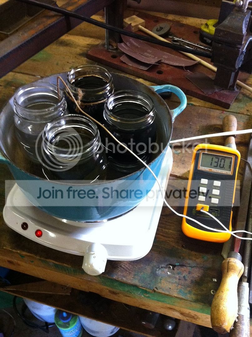

Quenchants all at 130F.
I assumed because they were similar steels the hardness tests would be very similar but I was very wrong. The original thickness of the steel was .207” and after heat treating and skimming off the scale the original test thickness was still .207”. I removed accurate amounts of steel and retested at various depths.

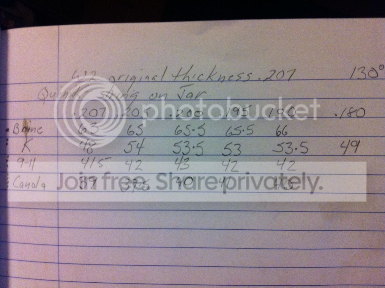

No matter how well I line up the columns once I post they don't line up but hopefully it's pretty easy to decipher my readings?
Thickness .207 .205 .200 .195 .190 .180
Amount removed 0 .002 .007 .012 .017 .027
Brine 63 65 65.5 65.5 66
Houghto-Quench® K 48 54 53.5 53 53.5 49
APCO 9-11 second oil: 41.5 42 43 42 42
Canola Oil: 39 39.5 40 41 40
Because my columns don't line up I included a photograph of my notebook showing my readings lining up properly.
The Brine results were about as expected in both hardness and verifying that brine hardens much closer to the surface than other mediums. Also I find the Brine results verification that my methods are sound because these are about the hardnesses expected.
What was very disappointing was my Houghto-Quench® K results. This being a 7 to 9 second oil like Parks 50 I expected my results to be very close to the Brine results. I find this surprising because I did get 65 hardness with 1095 using Houghto-Quench® K once ground down to a depth of about .020” and I thought these two steels were very similar in their hardening requirements.
It did show however that canola seems to be about a 9 to 11 second oil as it performed very close to the industrial oil of that rating which of course are both even more inadequate than Houghto-Quench® K for W-2.

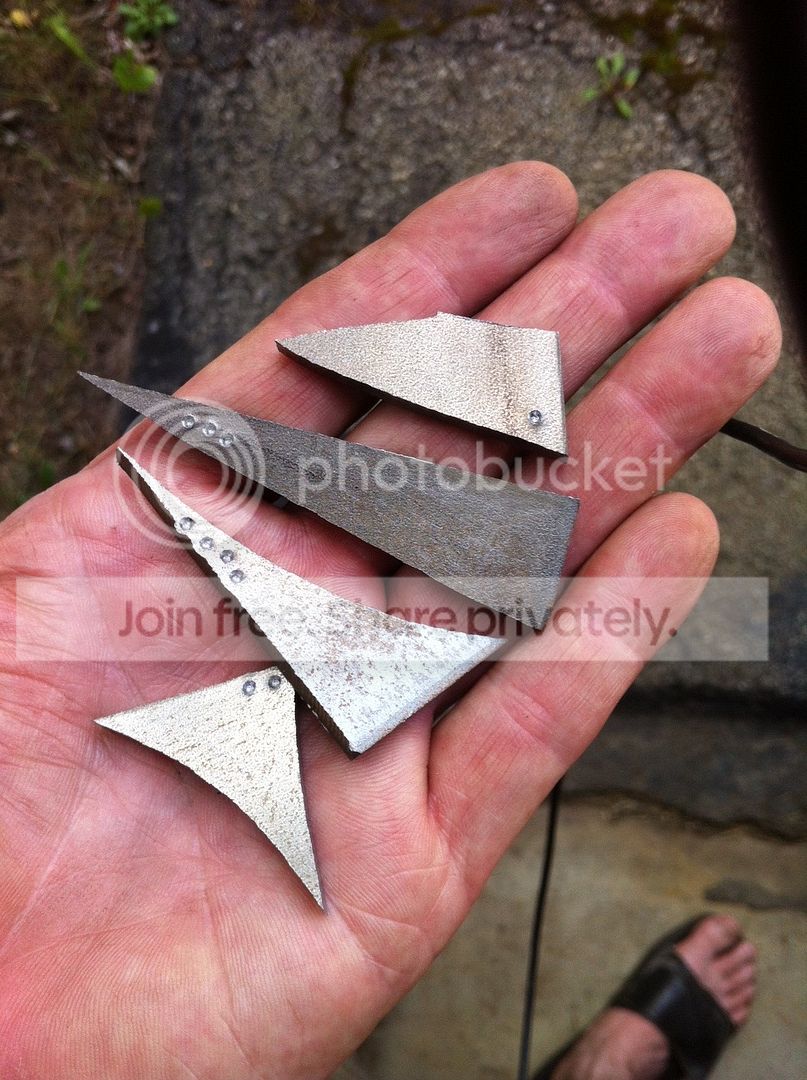

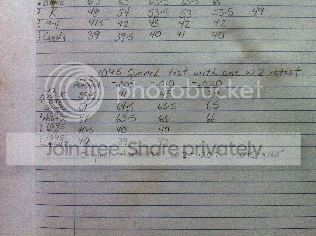

I performed the exact same test today on 1095 that I did yesterday on W-2 using different quench mediums. At the prompting of David Stifle I included one sample of W-2 that I again quenched in Houghto-Quench® K to see if my previous test on W-2 in this thread was valid.
Four new test pieces of 1095 and one of W2 to retest in Houghto-Quench® K.
The results:
I think from these results its pretty conclusive that Houghto-Quench® K is capable of hardening 1095 but not W-2. The W-2 and 1095 were both heated to the same Aus temp together and quenched in the same way and 1095 hardened and again W-2 did not.
I am really kicking myself for not having Parks 50 shipped across the border from Texas because although it and Houghto-Quench® K are both rated as 7 to 9 second oil they are not the same and Houghto-Quench® K is inferior or slower anyway.
And on the sample of 1095 that the Houghto-Quench® K was able to harden to 66 it actually had a soft spot in the middle of the sample which wasn’t even in the 50s. So although technically it did quench it to 66 it didn’t do it uniformly. Maybe a bubble developed there possibly I am not sure but I don’t even trust this stuff now for 1095 and really wish I would’ve gotten Parks 50.
I am using 16 ounces for my test pieces and after quenching it didn’t even go up 2°F. My test pieces were only 1” x 0.5 of an inch and if you scale that up to the size of a knife I think it would be like using over a gallon. And that is the same amount of quench oil I used for the 1095 that did harden to 66.
