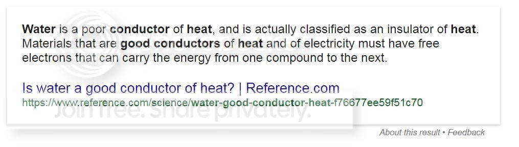

There have been several references to the volume of quenches that I have been using in these tests and I have ignored them because I don’t want to be argumentative and I just considered it a non-issue but since it keeps being brought up I guess it has to be addressed.
The main reason and I think most convincing argument that the amount of quenchant I am using is adequate is the fact that all my samples are consistently being hardened by 1 pint of brine and my 1095 samples have been hardened by 1 pint of Houghto-Quench® K so I don’t know how you can argue that’s an issue when my tests have proven it simply isn’t.
Also once this was raised I checked the temperature rise after quenching and it was less than 2°F. I can’t see that insignificant temp rise making any difference at all in my quench. And it takes several minutes for this temperature rise to show up so obviously the heat is migrating to the full volume of my 1 pint container long after the hardening has occurred.
And besides that with these steels the hardening is accomplished in less than half a second. It was mentioned that the heat needs somewhere to migrate to but how far do you think that heat can migrate in less than half a second. I doubt there is any temperature rise in half a second more than a quarter inch from the sample so it seems logically to me you could quench my samples in a shot glass.
And finally I did a Google search on if water is a good conductor of heat and this is what I got so obviously in less than half a second the heat is going to migrate almost not at all and the cooling is done by the liquid in a shell directly around the piece.
One can disagree with my reasoning but I don’t see how one can counter the fact that already in my tests 1 pint of quenchant is hardening the samples. The proof is in the pudding.:)
