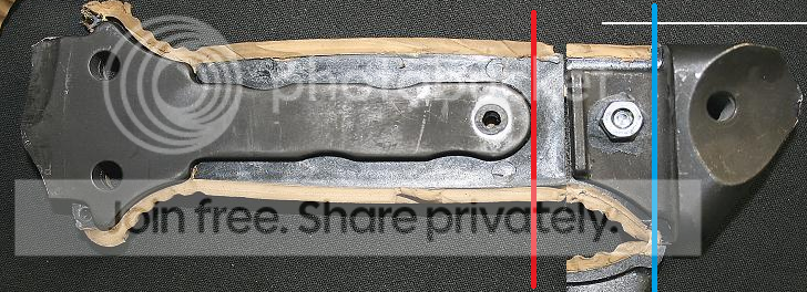

no they are absolutely not, I've seen pictures of the LMFII, not only is it a hidden/concealed tang, but id doesn't even go the Length of the handle.
Full tang doesn't just mean it goes all the way through the handle, otherwise craptastic thin stick tangs would be called "full tang"

how, by still being wrong about the LMF II?
Between the red and blue lines is HANDLE (not pommel) without the tang extending through it.

I will admit the definition I've always been taught about different tang types may be "wrong" in regards to a full tang extending the entire width of the handle, however I am right on the fact that the LMF II is not a full tang.

I will admit the definition I've always been taught about different tang types may be "wrong", however I am right on the fact that the LMF II is not a full tang.

To everybody regarding the argument on the LMF II tang. Between the tang and the pommel there is a SMALL gap which is for shock absorption for when you use the pommel.
Actually the main reason for the gap is so you don't cop a boot through the pommel if you have to cut through live electrical cable.
Wow that picture of the disected LMFII is an eye-opener. Now I want to take the handle off of mine and make a spear :D Ever since I was a kid, I wanted to take the blade off of a knife and make a spear...my mom freaked out and that was that...40 years ago I mean.

I recommend you watch Noss' D-Test of the knife (where that tang picture originates) before commenting further on its theoretical capabilities. And note from the Destruction-test (and that picture) that the tang held up just fine.
