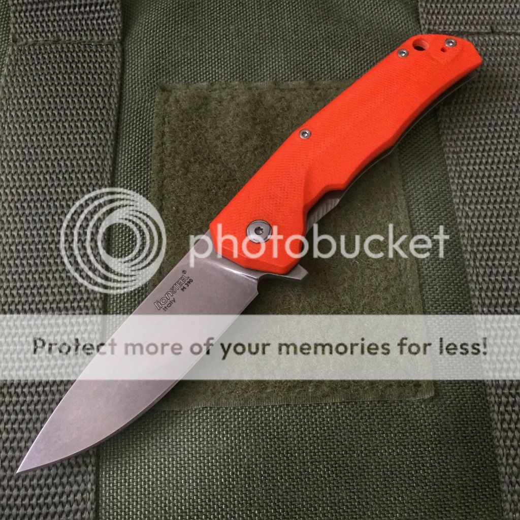

I got the Orange flipper in today from Lamnia and I am very impressed. The knife feels more substantial to me than the specs suggest, I think it's because of the chunky blade stock they use. The machining and work put into this knife is really impressive.
My example has no lock stick and flips smoothly, it doesn't flip as hard as a 0450 but the form factor, fit and finish and smaller size make up for this in every way. In fact I sold a ZT 0450 to fund this knife and I am happy I did.
