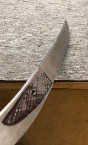

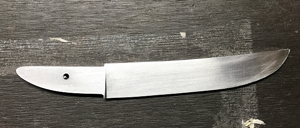

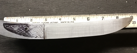

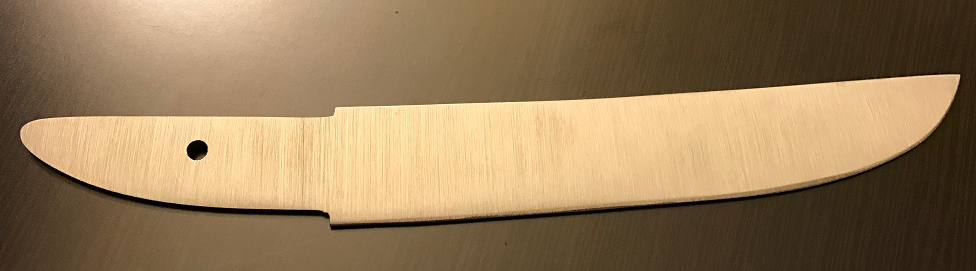

Took Stacy's advice (i think) for v4.0
I hope this looks more alive than my previous attempts. On to the iori-mune. I think i'll do it by hand so i can slow down.
Any feedback on the geometry/proportions is much appreciated.
That banana shaped blade you have made is an exaggeration of the form. The link shows what a real Tanto looks like. When working from a forging the lines and planes of the mune are the first things defined. The rest of the shape of the blade are proportioned from that.
https://upload.wikimedia.org/wikipedia/commons/b/b9/Tanto_Hyuga_Masamune.JPG
Thanks Carcara. I'm seeing conflicting degrees of curvature in my research, but I can definitely reduce some of that exaggeration. I certainly don't think "i nailed it", but some Hira Zukuri have a flatter mune and some have a more curved mune. maybe less curvature at the kissaki? Do you think its too late to shape the mune?
Your designs will continue to be refined as you progress, but I think your latest design is pretty much within historical parameters:
Your curve does appear to be greater near the tip (sakizori), but there is historical precedent for that. You are off to a good start, and I don't have anything else to say about your design at this point. Finish it up and see how it turns out.

Thanks Hesparus. I think i'm ready for HT. JT, i sent ya an email!
I got a bit skiddish re: the mune. I'm going to save that for a future blade and maybe practice a bit on scrap. Things also got hairy near what would be the ricasso, but i'm going to grind that out post HT once i have a file guide. It's hard to conceptualize where the blade ends and the tang begins...

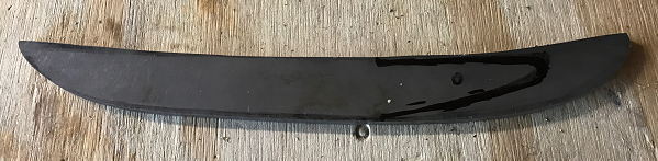

Jut got my tanto back from JT's heat-treat. After a bunch of research and mocking up a habaki, i realized that plunge line had to go. Onward i go to habaki-ville!
Looking good! Make sure (if you haven't already) that the nakago tapers right from the machi all the way to the end. Otherwise the habaki won't fit right.

Thanks Hesparus. I think i need to tweak that taper just a bit.
