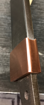

i can't believe this thing fits the tanto again. i think i'm almost there. all finishing suggestions welcomed.
re-shaped the nakago just a touch. hit the habaki w/600 grit belt then scotch-brite belt. i have a couple of issues...
1. no room for a tsuba based on my mekugi hole
2. the forward angle (from spine to blade) of the habaki is slanted, and i'm not sure its right/wrong or correctable
Your habaki is similar to most first habaki. It is way to thick and sticks out from the blade too much at the ha-machi. The bottom should fit like your top does. I think you followed Jesus Hernandez's tutorial, which is good, but it is not a habaki for a tanto. That type habaki is for a larger blade.
On a tanto, the habaki sits mostly on the blade, not the nakago. The mune and ha sides are generally cut out back to the machi-gane to alloy the habaki to slide forward along the blade. If it is a four sided habaki, it needs to be very thin on the edges. As yours is right now, it will be difficult to insert the blade into the saya. Adding bevels to the ends can help this. Also thinning and tapering the habaki a lot more than you have will improve the look and fit.
I like the part that sits on the nakago to be half of the habaki or less. The machi-gane (part that stops on the shoulders) is only about 1/8" to 1/4" on some habaki. At a minimum, I think one should have half the habaki on the blade of a tanto. Others like a short habaki with a smaller seat.

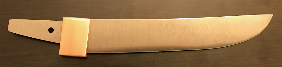

Ok Stacy, i worked on your suggestions. i see what you're talking about now. your advice will definitely be on my mind when i make the next habaki. i'm not sure how much i can squeeze out of this current habaki. i kept having newbie-knife-maker-flashbacks of decent work being rendered junk because i don't know when to quit. i'm shocked my solder joint is still in tact. the micro adjustments are challenging. i think im satisfied w/my 1st habaki.
Very good looking, glade you are having fun and making progress. Makes me want to make one.

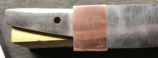

That is a lot better fit at the ha machi. I would suggest cutting it in half (top to bottom cut) to make it less wide. As it is, you have a very short nakago, and the mekugi-ana is really close to the habaki. By the time you add the tsuba, the hole will be at the front edge of the tsuka. You almost surely will need to drill a new ana.
If you look at the last photo of the habaki on the blade, you will notice a slightly dark line down the middle from top to bottom ... that is where I would cut the habaki in half. Save the cut off piece to make a habaki for another tanto blade.
i agree with stacy, you can half the length, then cut your top and bottom slots a bit deeper so it slides up the blade more and you should have enough room for a tsuba. looking good !

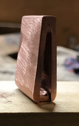

Stacy/John - great advice. I'll do it. I only have a hacksaw and that lil sucker gets tricky to position. Last time i had it in my vise i think the opening closed up on me a bit...and it was a bear to get it back on to the blade. suggestions?
Are you aware that copper could be made soft again?
Just heat it to dull red and you are good to go...you could even quench it to cool it quickly.
Yes, but i guess my issue is confidence. Confidence that i can get that cut from top to bottom straight while my habaki is squirrelly in the vise because i dont want to overclamp. Also, a hacksaw blade seems pretty thick. i guess a jewelers saw would work?
sure a jewelers saw would work fine. a bandsaw would work too if you have one. that way you would not need to clamp it.
OK, I had a few extra minutes this morning while setting some diamonds, so I grabbed a tanto blade from my run bag and made a habaki for it. I started with a pipe coupling, annealed it, flattened it, opened it up enough to hammer ( brass hammer) it up the nakago, then started fitting it. Once the basic shape was formed, I cut the piece in half. At this point I silver soldered the joint at the ha. Next, I added the machi-gane, cleaned the inside up a bit with some needle files and a ball burr. Then I cut the mune-machi slot to fit the machi. Once it was fitting pretty good, I cut the piece down a bit more from the back side to remove some dings and make it narrower ( I had been striking the back of the habaki with a flat block of steel as I fit it), and started the final filing and shaping. Once the surfaces were clean of dents and dings, I beveled the very front bottom corner at the ha at 45 degrees, and beveled the front edges on the sides. With the bevels on all forward edges, when a finger or the saya is run up the blade against the habaki there is no appreciable stop at the sides or top/bottom to snag. At this point, I reduced the metal sticking out past the ha until it was about 1mm thick. This is plenty for strength, but projects very little. Once the rest of the habaki is sanded smooth, all sides will be about 1mm thick, with the back being a tad thicker. This is plenty to grip the saya, but not enough to affect the knife in use.
From here it will just be some sandpaper and it is done. Finished width is about 12mm (1/2"). On a tanto, the habaki is much shorter than on a sword.
