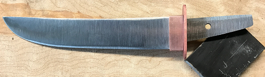

Trimmed my habaki as suggested. I agree, it looks more proportionate and allows more room for tsuka.

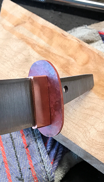

Made a copper seppa. I toyed with hammer marks on the visible part, but don't think it turned out well. The nakago shape looks a bit wonky, but it surprisingly fits snug despite some over-zealous filing. I also may try to force a patina on the seppa with the boiled egg trick (need to stop spending money on this knife so i'll save the liver of sulfer for another day). My favorite color of copper is after it has been annealed. Any way to preserve that color? I presumed that I don't want my seppa to be "soft" copper.

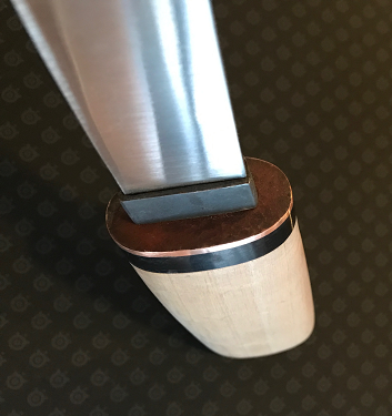

They're made even tougher when you realize you didn't drill the mekugi hole (still mekugi an when referring to wood section?) in the handle before you glued up. MBurks gave me a nice piece of alder, and thankfully I was able to get a serviceable tsuka -- i wasted much of it. I made so many mistakes with my crappy stanley chisel (not discounting my horrible lack of skill). I need to make/buy a saya nomi before i do another tsuka. For tanto #2, I'll try a saya/tsuka on the alder Stacy gave me.
I ended up using liver of sulphur on the habaki and seppa. While working the buffalo horn i thought it would look good to grind the patina off the outside ring of my seppa. I like the contrast.

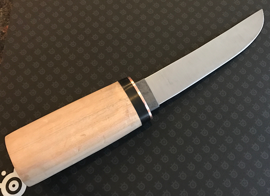

I think it's looking great. Glad the alder helped.
The metal-dark wood-light wood looks fine. The handle looks much too fat. You can make the saya and grind both down together.

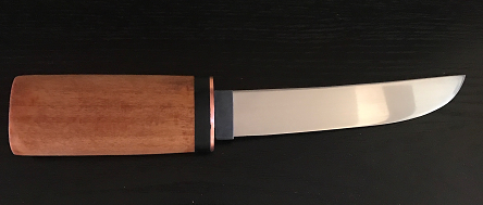

Here's the latest. Stained the tsuka "gun oil" and polished blade to 2k grit.
I made this tanto for a friend/co-worker who is an avid martial artist and fan of Japanese culture. We're parting ways and I couldn't get the mekugi finished in time. I hope to reunite w/the tanto and finish the mekgui situation one day, although he insists he likes it just as it is. It felt really good to make something and give it away to someone who appreciates it. To my surprise, he even bought me a saya nomi after i explained the difficulties of carving a tsuka w/a standard chisel. i'm not so sure he didn't get the bad end of that deal...
I made tons of errors, and there's still things that aren't perfect, but I never thought I could turn out something like this on my first try. I already have plans for tanto #2, and this time I intend to hold on to it as a gift to myself...clearing all time constraints. I suppose i'll keep updating this thread as not to junk up the forum w/more tanto madness.

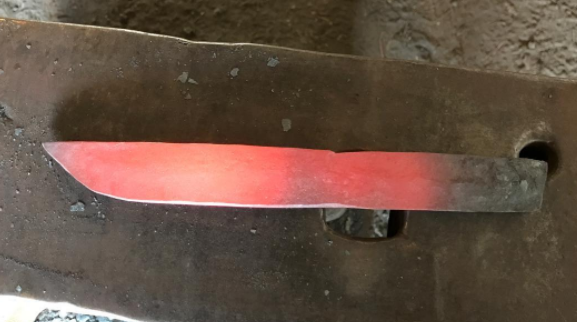

I had an opportunity to start forging a tanto today -- I've been doing a few clip-points, but nearly jumped out of my shoes when I was asked if i'd like to try a tanto. I had some course correction (aka experienced smith get me on the right track) along the way, and enjoyed the difference in how the point is created. I'm using Aldo's 1075, and plan to try a hamon.
I didn't finish, but i did; hot-cut the point, set the bevels on edge and nakago, taper to point and to end of nakago. I set the mune-machi (although its not as pronounced now after working the taper). here's a pic of where i left it after a normalizing heat.

Looking good, it's rather rewarding to forge isn't it. Don't take this the wrong way I'm just asking a question. Why hot cut the point. I see people do this and it just baffles me. You forge so you can move metal where you want it. I watched a guy hot cut a point on forged n fire and it left me scratching me head. Maybe I'm weird but I like moving the steel around to where I want it. What do you do with the little waisted bit of steel you cut off. One thing I love about forging is how much blade you can get out of so little steel. If you have a chance thy forging the point, I think you will find that it goes rather quickly.
It is best to leave the machi for doing the final filing on the blade and nakago. Trying to assign them too soon will just limit your finishing.
JTknives JTknives , very rewarding! Re: the point, i'm not exactly sure to be honest. I've forged the point on my previous 3 clip-points. This point was hot-cut, and then reversed the other way. It seems to be part of the Japanese tradition...but I don't know the reason.
