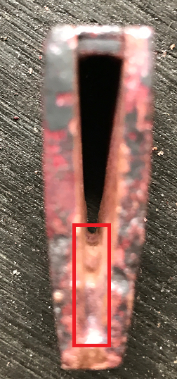

Started the habaki, and was on a hot-streak. then i decided to solder. it was my first attempt and it was sloppy. now i have a habaki that wont fit to the tanto. that "gunk" in the red box aside from being ugly is preventing the fit.
Any suggestions to remedy this, or is it start-over time?
i used the following with my bernzomatic torch:

is it hard (silver) or soft solder ? you could probably get most of it out with a hacksaw blade, thin file, and sandpaper wrapped around a piece of thin sheet metal, using it like a saw.

hard solder. i'll give the hacksaw blade and sand paper a try. i was hoping to save the habaki. thanks for the reply john.
You always have to file fit the habaki after hard soldering it together. It would end up very sloppy otherwise. You do the inside first, using a needle file, ground down piece of hacksaw blade, and small burrs in a Fordham/Dremmel. If necessary, adjust the tang and machi a bit to make a good fit. Then when the habaki is a snug fit on the blade, finish and shape the outside of the habaki. The little bit of metal left inside the habaki to seat against the shoulders ( machi) is called the machi-gane.

thanks Stacy. I've never handled a blade/habaki. Should the habaki slide on easily or w/some light manipulation? Also, is light hammering of the copper a no-no at this point?

Hammering the habaki as you fit it is the normal way to sneak up on a perfect fit. You want to end up with a habaki that slides on fairly snug - not too tight, not loose at all. If it is loose, just squish it from the sides (while not on the blade) a bit and it will snug up when slipped back on the nakago. If tight, a few taps with a small ball peen or brass hammer will move it. About 75% of the habaki should be past the machi. Sometimes, I fit it so 90% is past the machi, and only a little is seated on the machi. A steel "guard fitting tool" can be made by welding two pieces of 1/2X2" steel bar with a 1/2X1/4" spacers between them. Assemble with a clamp so the nakago (tang) will slide between them. Once arranged so you can move the nakago in and out, weld the spacers to the heavier bars. Grind the ends flat and square. This can then be slid down the nakago and slapped against the habaki to seat it firmly and shape the machi-gane to be a perfect fit. The same tool (or one like it) can be used to seat a slotted guard or tsuba on a tang.
To allow final filing and fitting, I always leave plenty of extra metal on the habaki ends and in the thickness of the metal used. On the tsuba end, it allows the end to be filed smooth after being seated to the machi. On the blade end extra thickness in the habaki and extra on the end allows beveling and making a perfect fit to the blade where it enters the koi-guchi. Extra metal in all dimensions ( length, width, thickness) makes all final shaping and finishing simpler. The rule in every language is the same - "It is far easier to remove excess than it is to add on even the smallest shortage."
