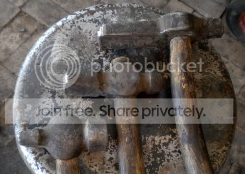

Here are some of the hammers I styled it after. The one on top I forged when I had my power hammer set up, and have used it for the bulk of my hand forging ever since. It’s styled loosely after some Mexican raising hammers I’ve seen. It’s closest to the size of the new design. The middle one I forged from a ball peen, and the bottom one I picked up in a trade, not sure what it is, no marking.
