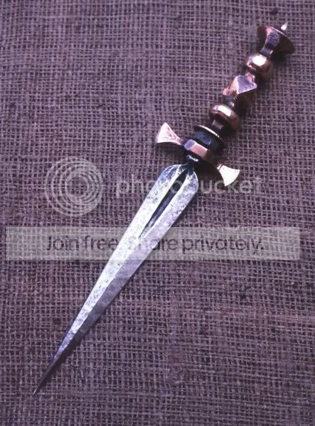

Here's an example of what can be done with a sharp face/nose, the edge of the anvil, and a few other goodies...
The handle is from a piece of copper pipe... I used the sharp "corners" of the hammer faces a lot... just a series of very simple, well thought out and controlled,... "dents". :)
"Denting and scratching" is all there is to it! LOL :D
