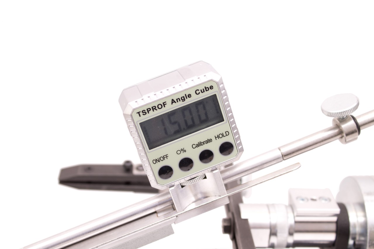

On this week i want to show you our new digital protractor with TSPROF logo
Also, soon i will introduce new clamps, angle gauge and other interesting stuff!

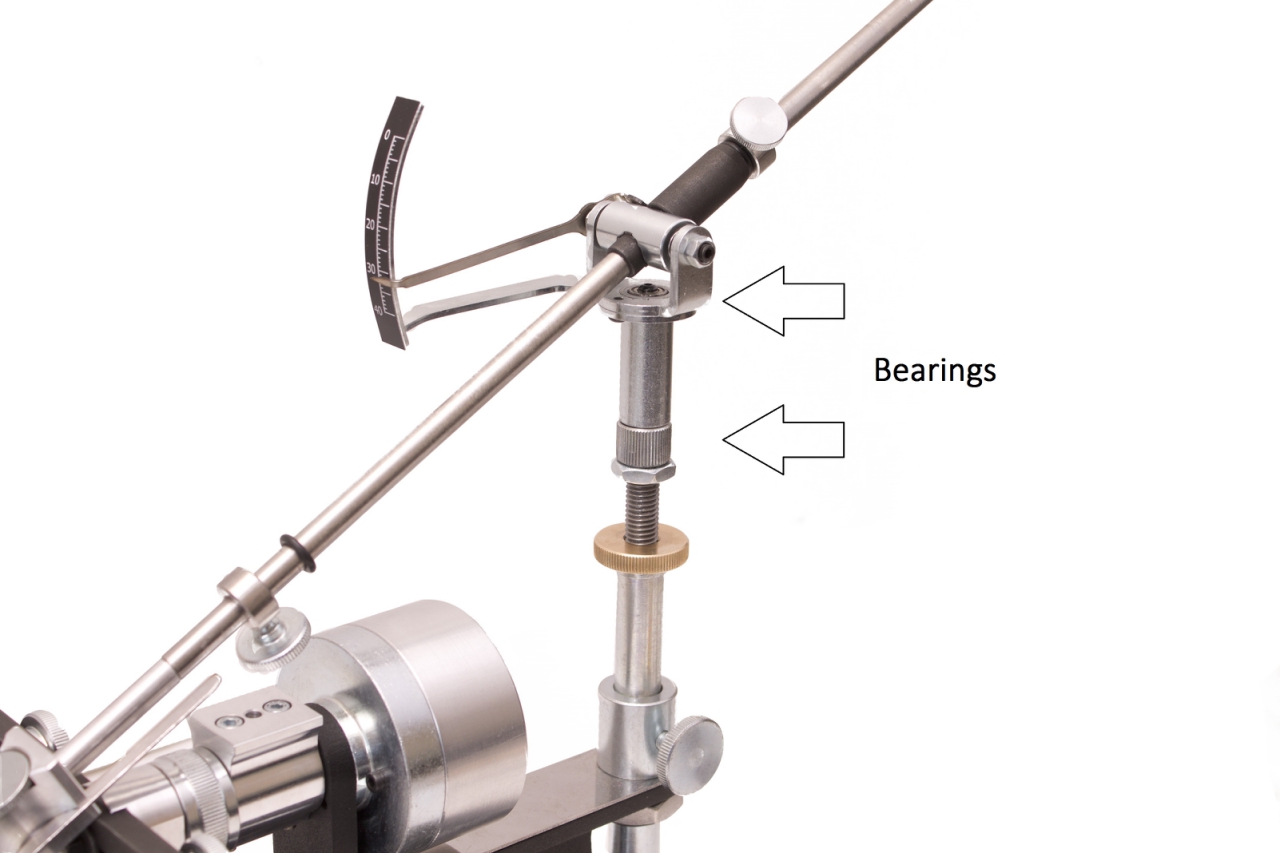

We have reviewed the design of vertical angle bar with gauge for models К01 and K02.
Removed the technological gap between the vertical sleeve and the sturt by modifying the design of the bearing node.
Significantly reduced the backlash and no longer need the sample and setting backlash shaped nut and lock nut.
