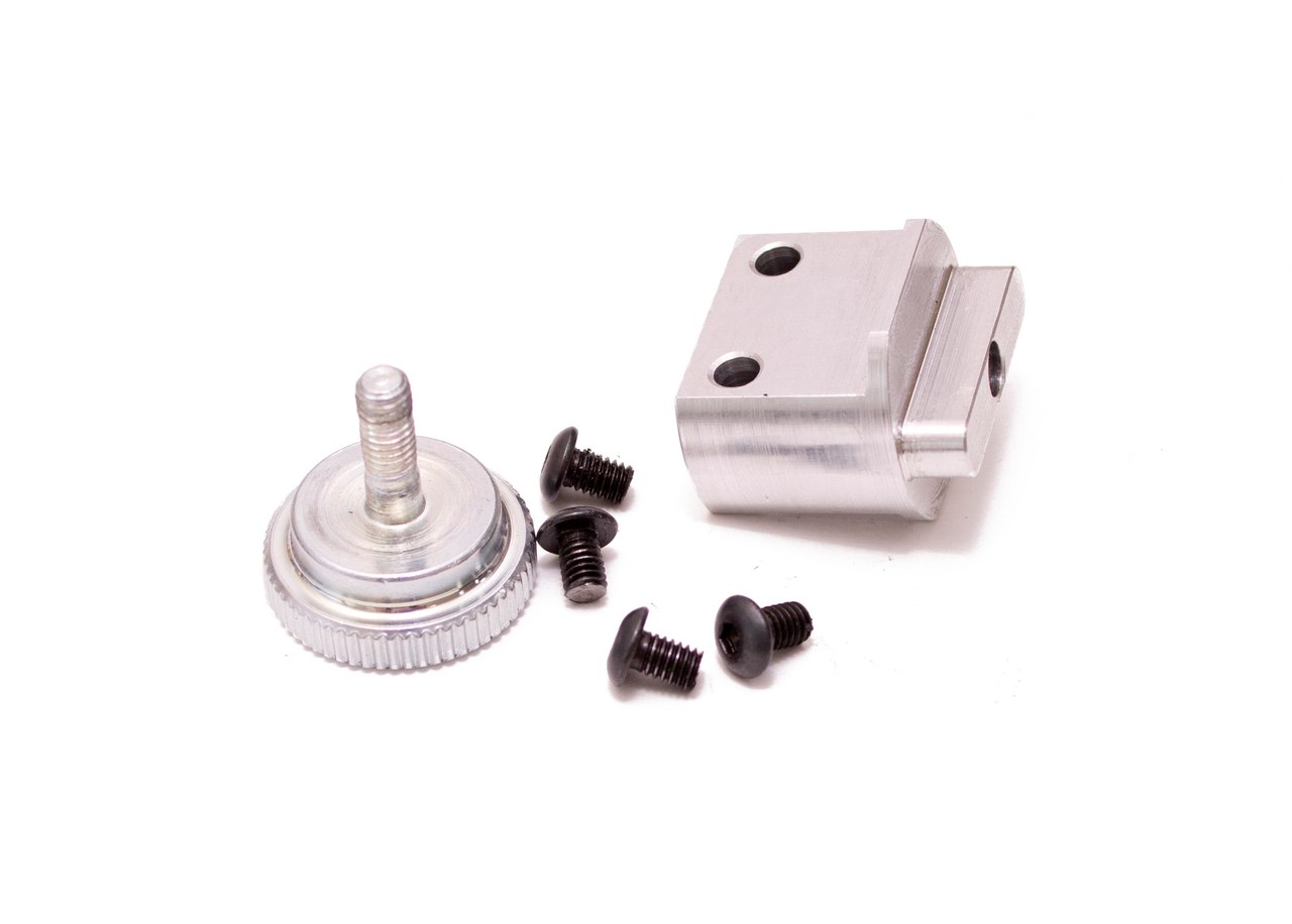

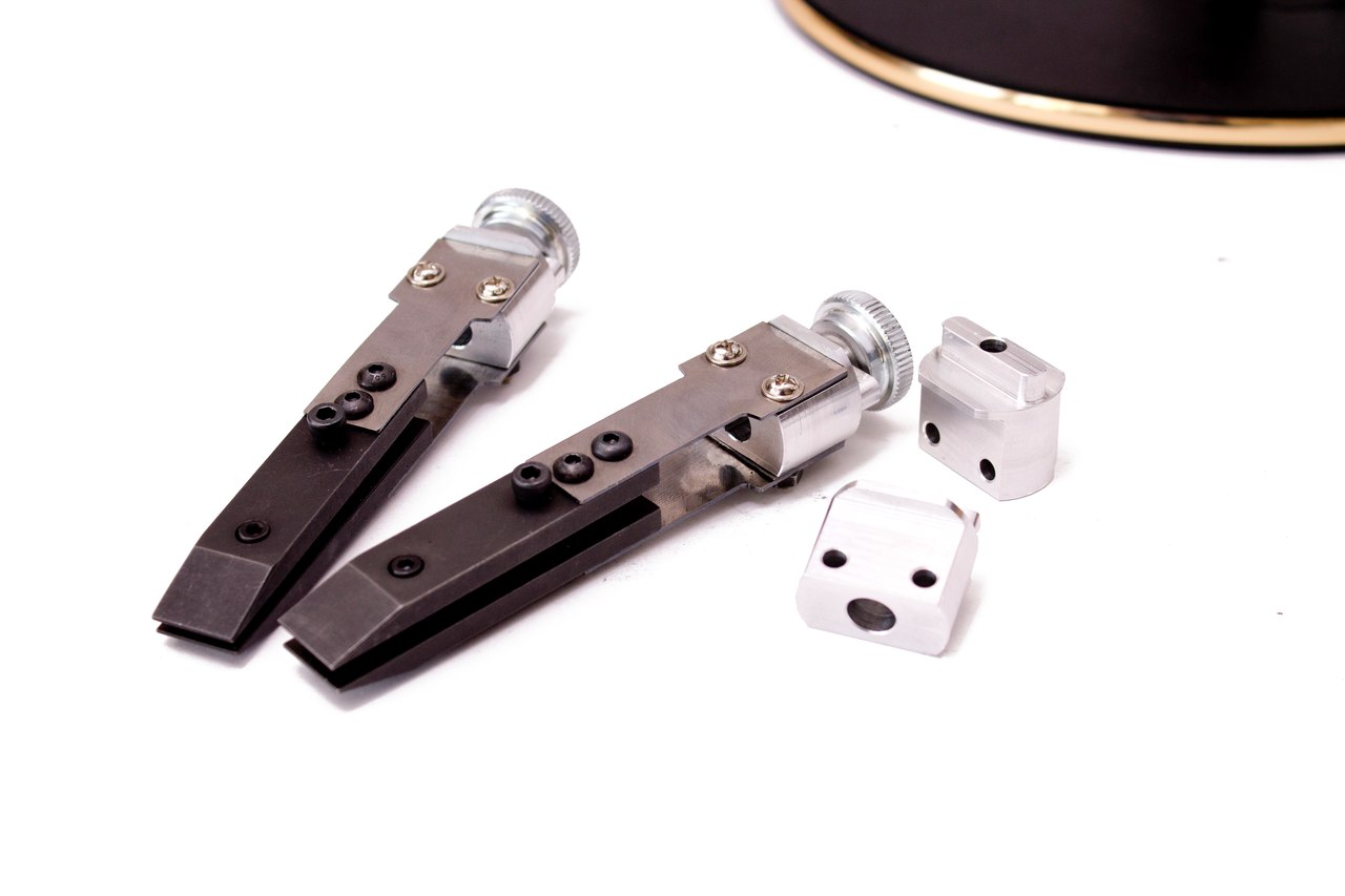

New fixing unit.
Replaced the old welded construction of steel on the new one-piece fasteners from alloy D16T, manufactured on precision CNC machines.
- Increased the area of contact between the base surfaces.
- Due to the geometry of the unit is now more accurate positioning of the entire clamp on the frame and increased resistance to stress.
- Removed unnecessary excesses of springs for clamping thicker blades, due to the increase in the thickness and shape of unit. Distance between springs increased from 10 mm to 14 mm.
- Added possibility of separate adjustment of the springs, which greatly facilitates the centering of the entire clamp.
