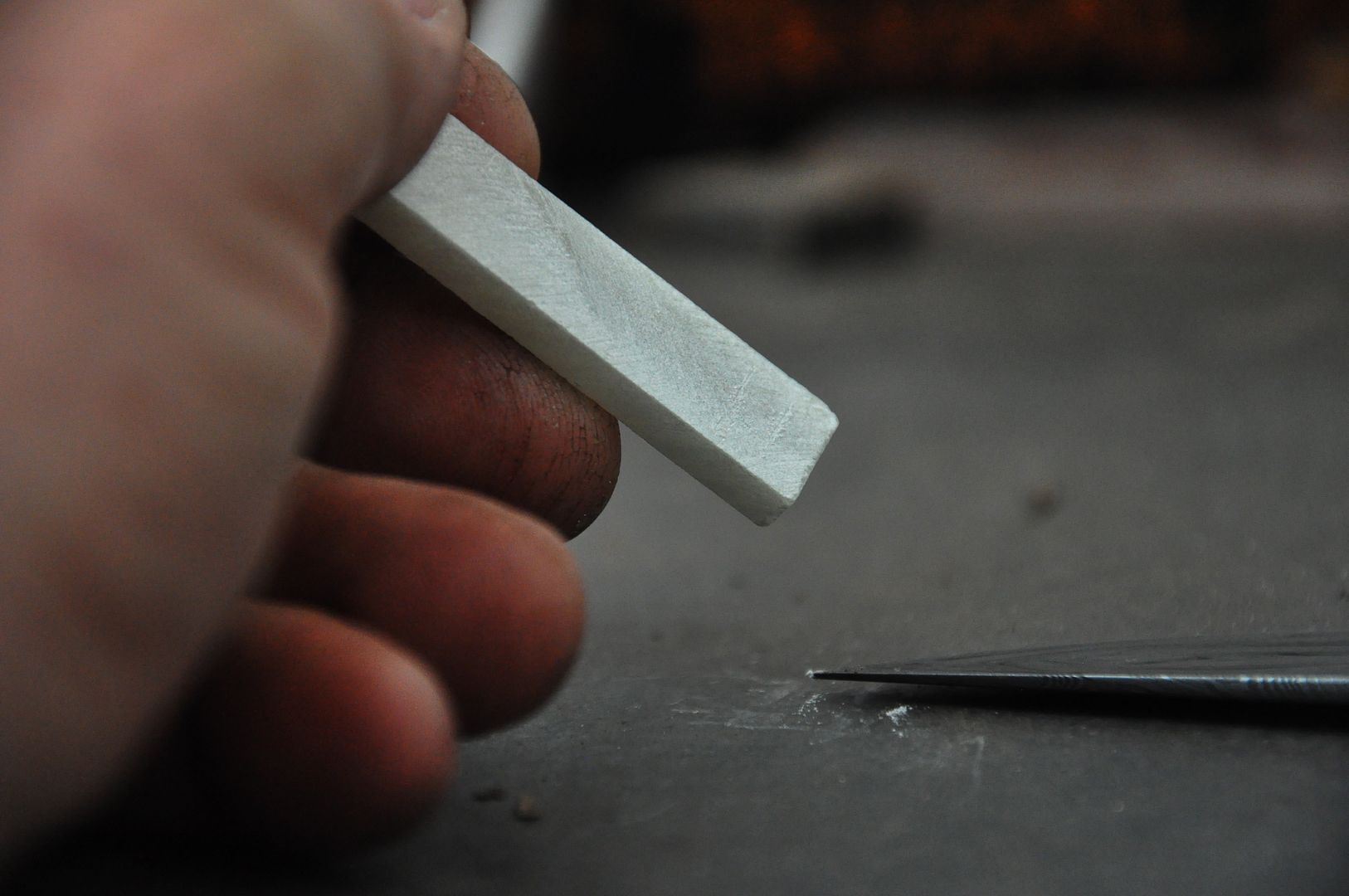

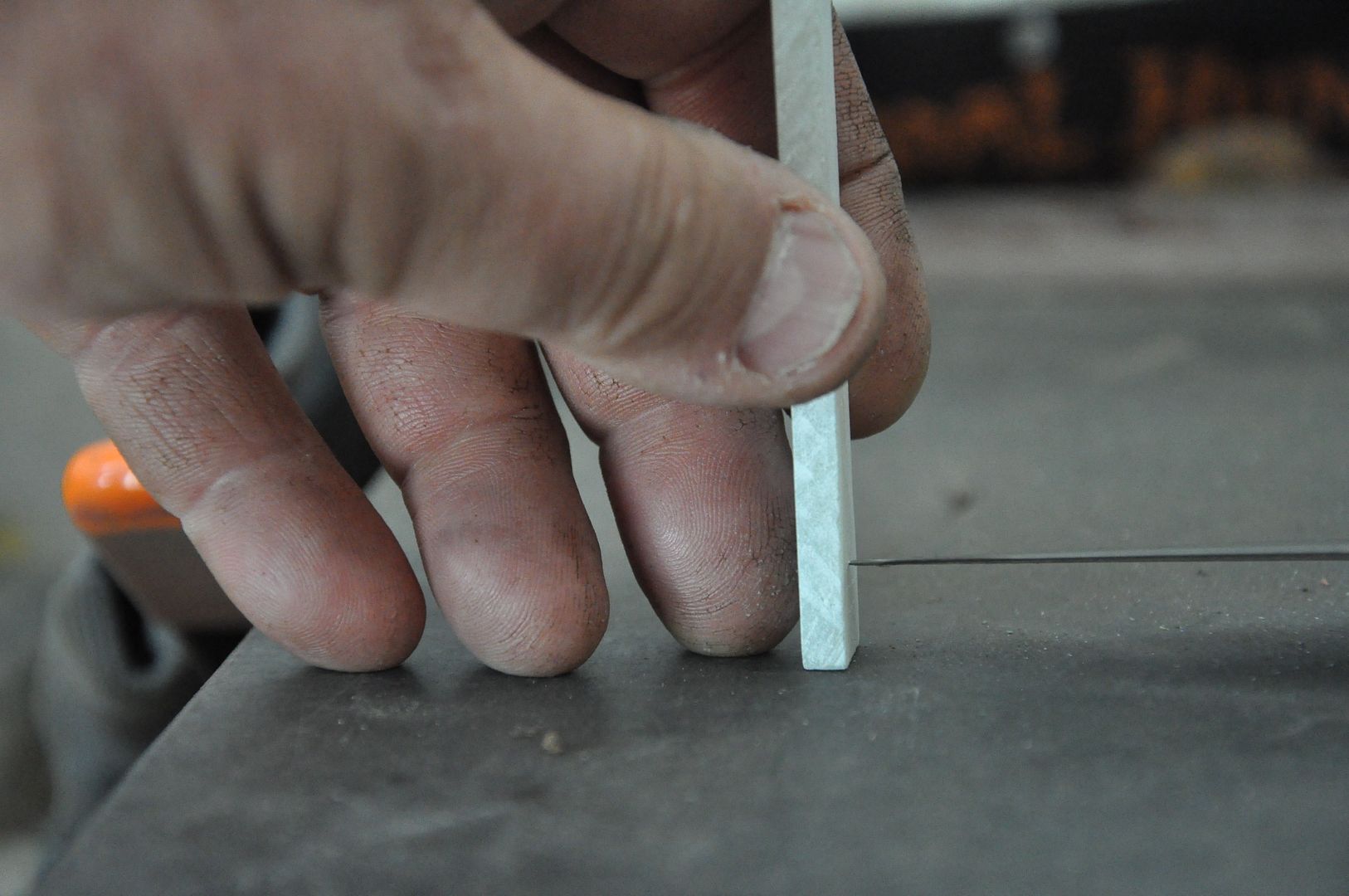

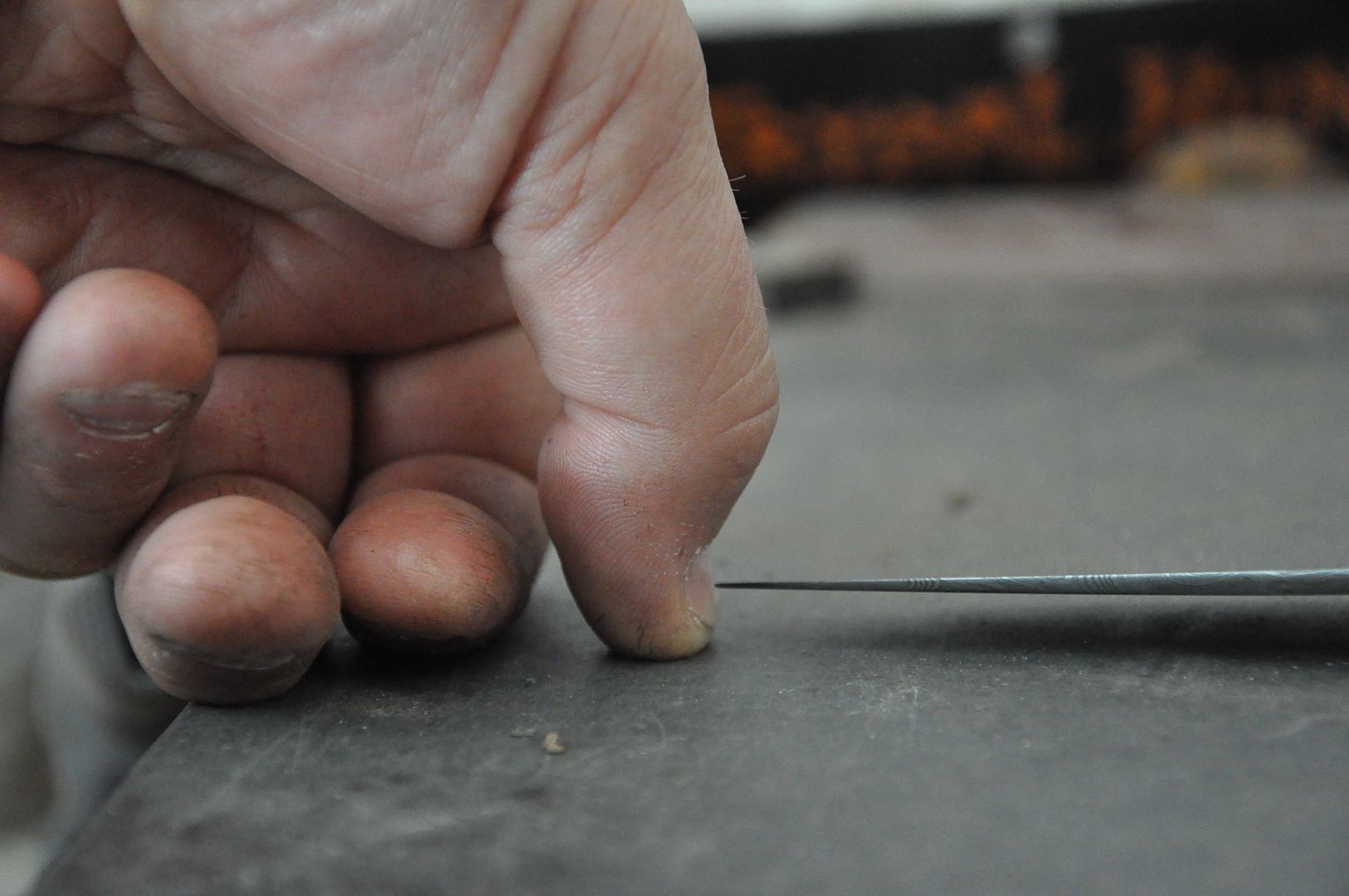

Here is an example of the thumbnail test
now turn it over and do it again.
This was a knife a made a few years ago without knowing about this test. It was off significantly.
You can also do this with a soapstone, just not as readily available as a thumbnail.
Hopefully you can see this was off by about .1". I can see it in the blade handle junction. I was not worried at the time as this knife was mine from the start and I needed to get it done fast. There again end user made the decision. This knife would not be allowed out of the shop today.
Yeah, that is a great test and an easy one the judges can do in the room. They don't take in calipers or any sort of measuring equipment, but if I were a judge I'd have tons of scratches on my fingernails. Especially on the dagger because the tip needs to be in the center four ways, not just two - that takes in the pommel and guard as well. Very tough...

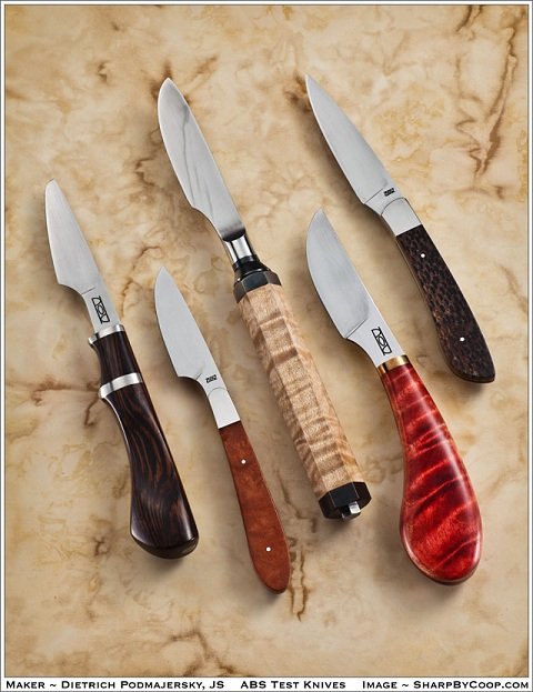

Michael, what defines an ABS Journeyman knife?
I've heard that they probably aren't going to pass another set like Deitrich's wonderful ones, and when I get to JS I'm ok with it being an exercise, with doing it to suit a set of parameters, but beyond looking at successful test knives, what would you say the boundaries are?
Thanks for making yourself available for questions!!
Thanks for the pics. So, first off, I haven't followed anything the ABS has been saying about these knives, but one thing jumps out at me: the width of the ricasso should be the same width as the start of the handle - for flow. Now, if it is true that the ABS won't pass knives that look like Deitrich's in future J.S. tests, well...
