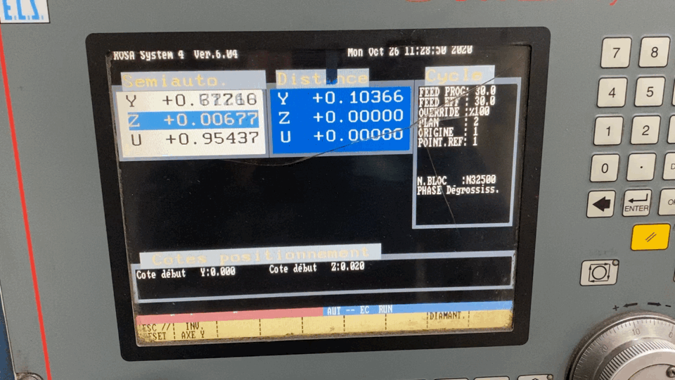

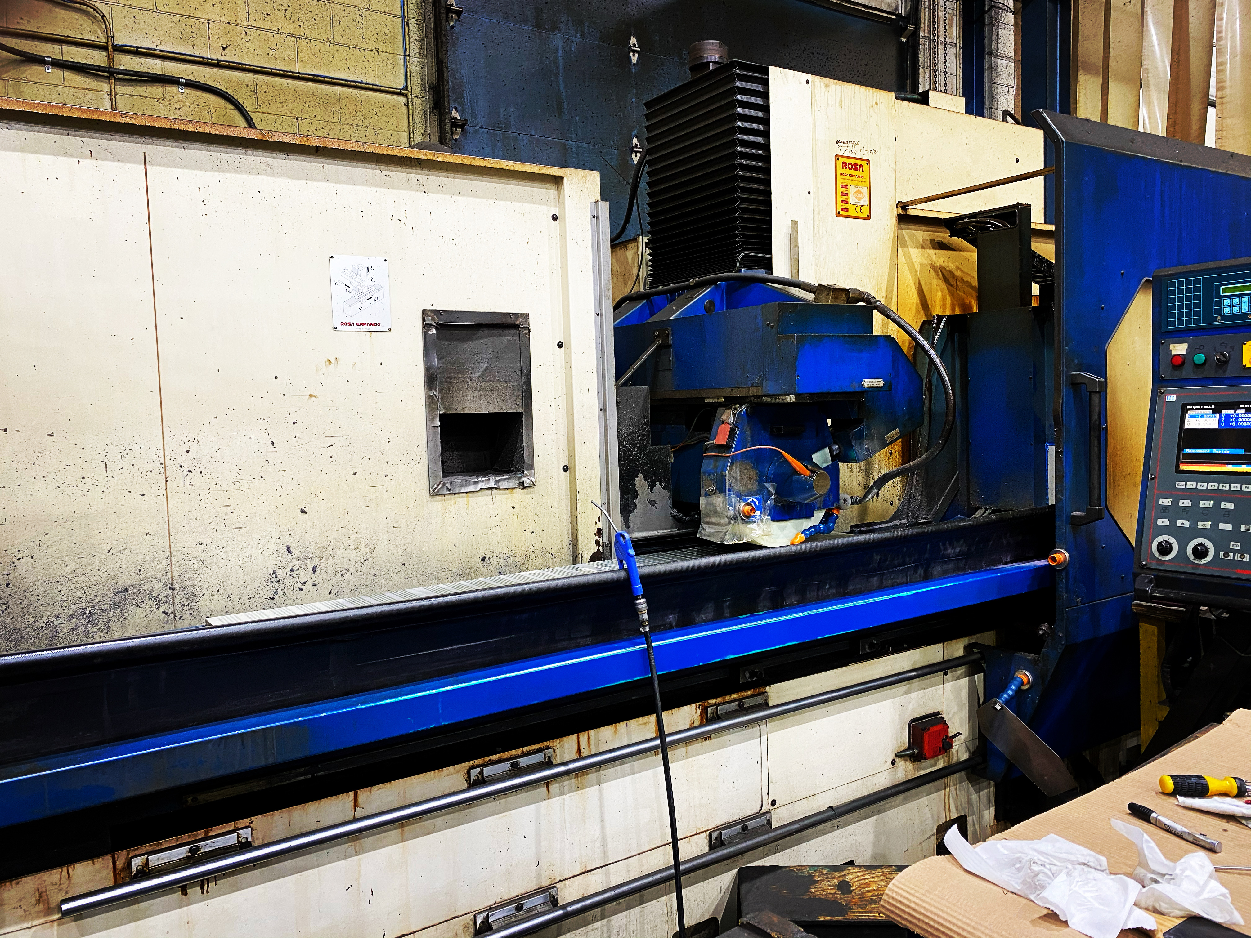

So, i wasn’t satisfied with the unevenness of the washers due to hand sanding. So, i will do it, professionally. Took the washers to my job and ground it on my surface grinder.

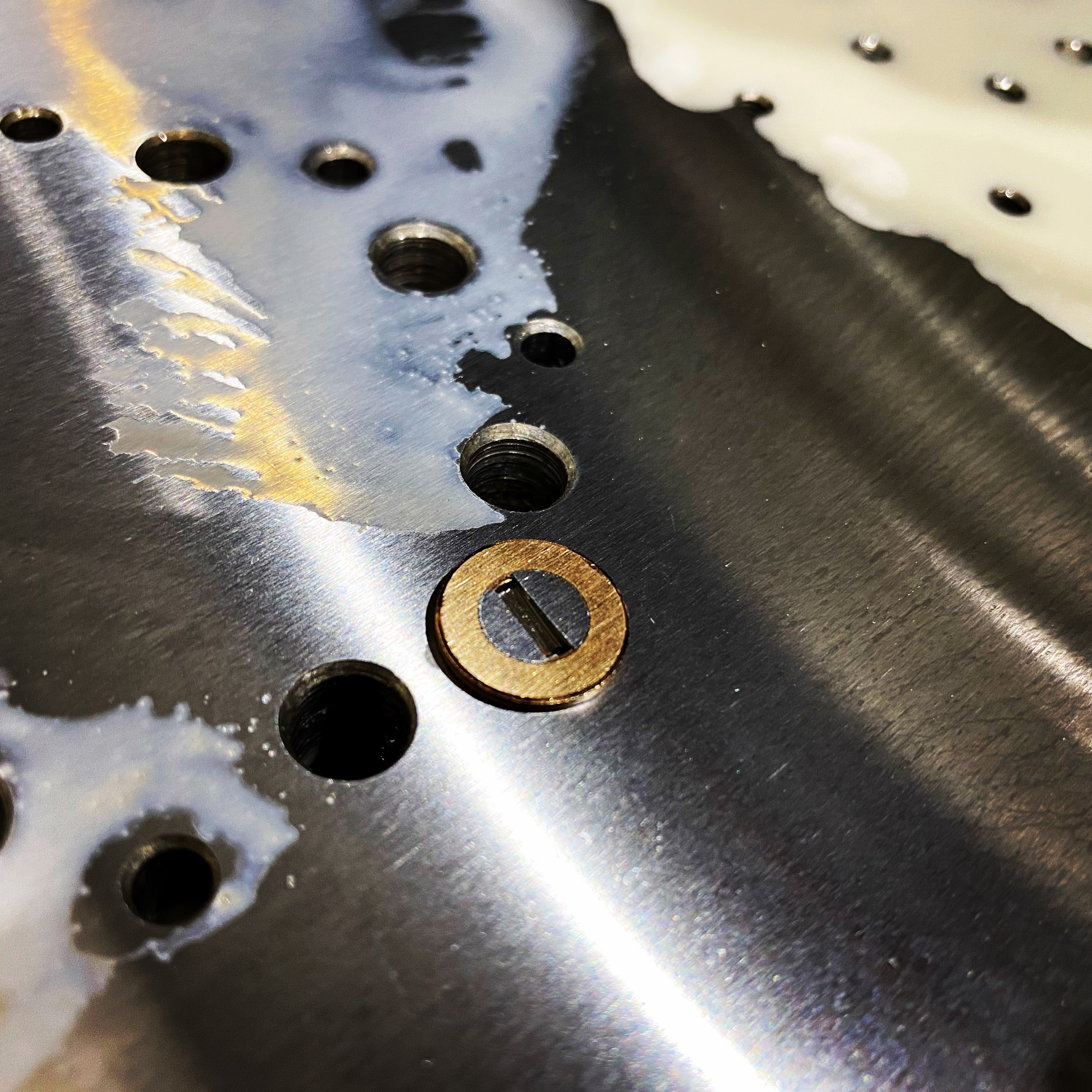

I, then, fix the washer onto a fixture to grind it off, since its non-magnetic, it wouldn’t hold on my magchuck table.
Then, proceed to grind.

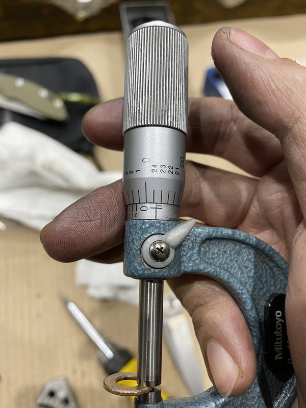

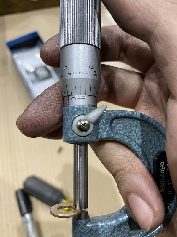

The tolerance, when i sanded at home was inaccurate with a cheap caliper. The true tolerance with a 0-1 micrometer, are:
0.0052" -0.0002"
and
0.0486" -0.0002"
Overall, im satisfied. It now has the tolerance of a CRK with tuned washers on both side.

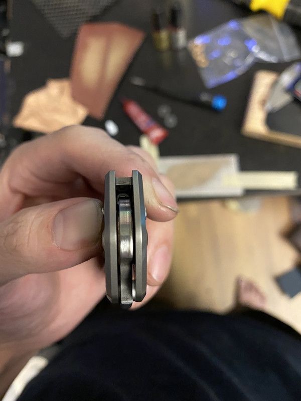

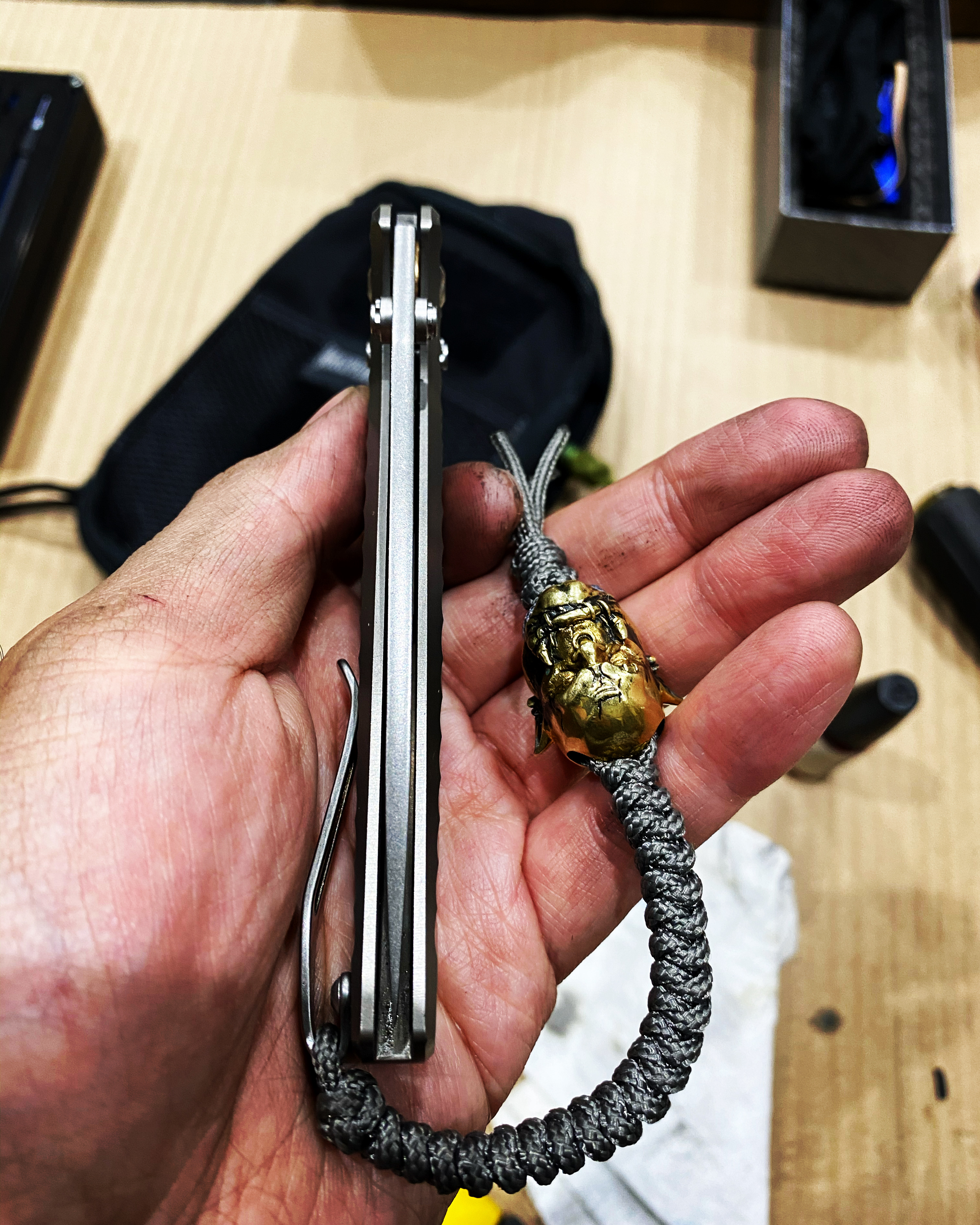

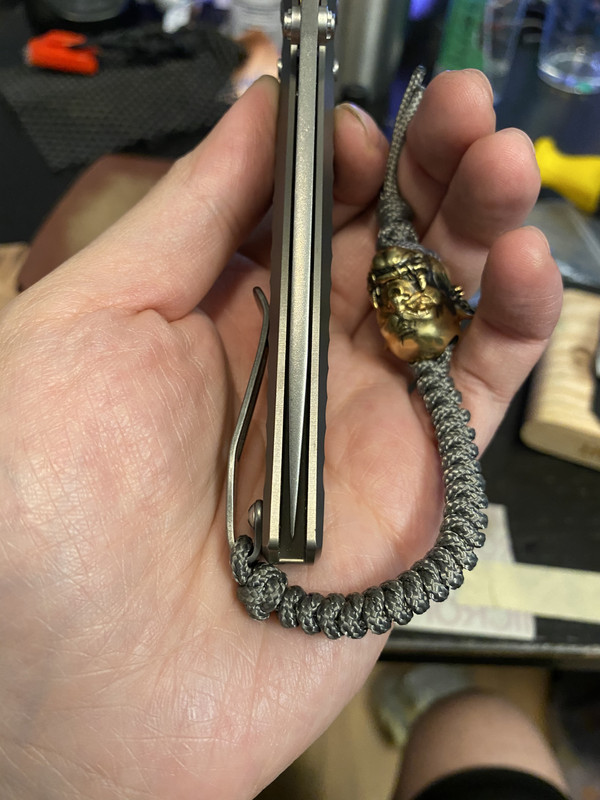

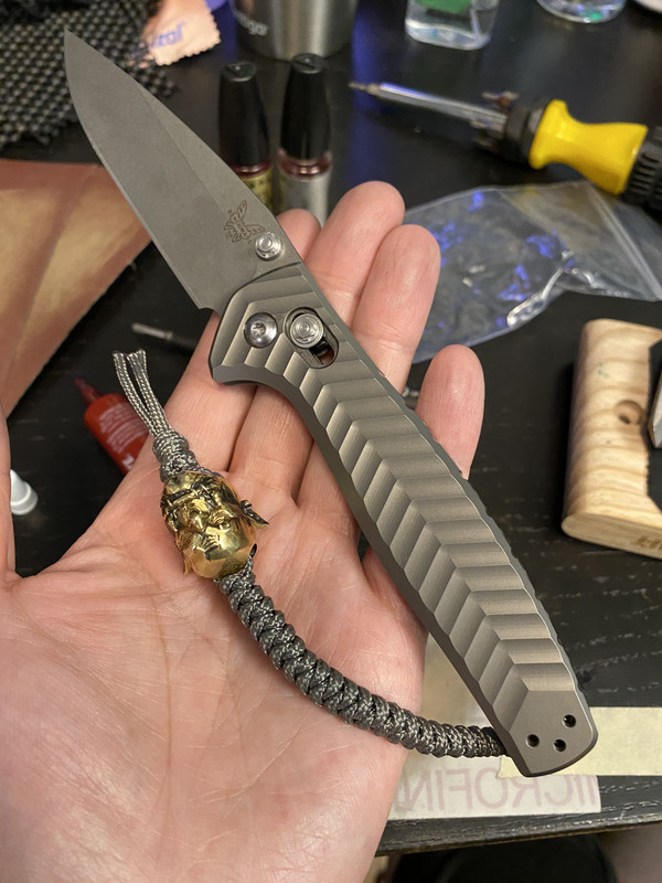

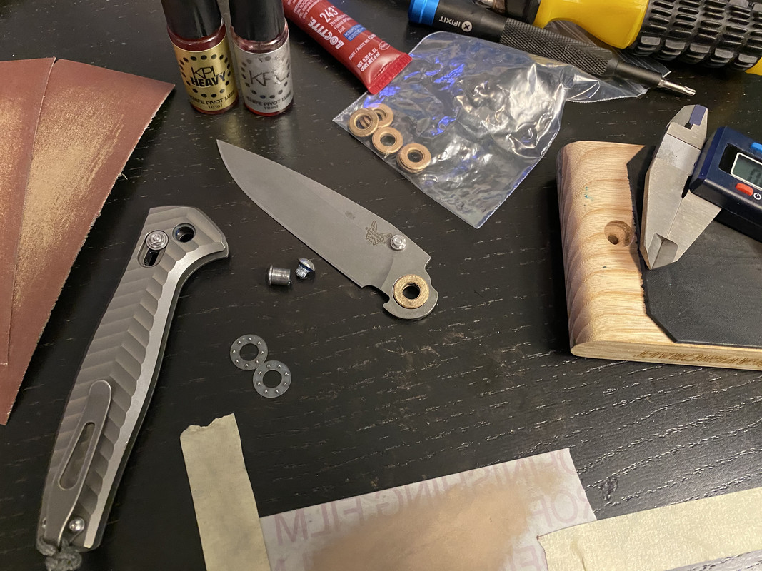

I swapped my Anthem bearings with PB washers :D. The bearings was great and all but the blade is off centered and it creates some deep grooves and bumps (from over tightening at BM factory) inside the scale. The only way, to fix it, was to swap it to PB. The size of the washers are 1/4 id x 1/2 od x 1/16 thick. One side of the recess was deeper and the other was shallower. Overall, i had to sand one washer down to 0.046" +/- 0.001 and the other to 0.048" +/- 0.001 to recenter the blade, that is 0.014" to 0.016" or 1/64 of sanding. Action is super smooth but not drop shutty as of yet. At least, i don’t hear the bearings rolling on titanium anymore and it’s perfectly centered with no bladeplay in any directions.
0.0052" -0.0002"
and
0.0486" -0.0002"
