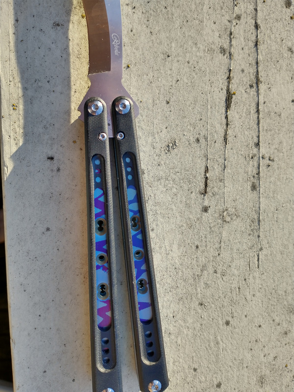

sure! It’s a friction folder on PB washers so you can set it pretty tight and still have it open smooth. The Copper back spacer acts as the blade stop in both directions. I started building these a few years ago with the Gen 1 which was laminated G10 all hand made:
Gen 2 was a CNC’d Micarta laminated version with a G10 backspacer:
Gen 3 is a complete screw together model with a Copper backspacer, these are very popular:
Mr Wells beat me to the Liner lock version so I’ll have to step it up for the Gen 4, maybe a TI frame lock with a Micarta or Carbon Fiber show side :cool:

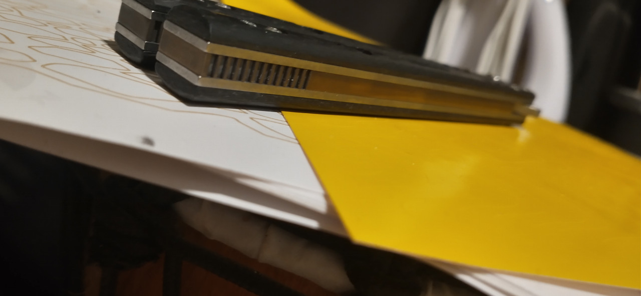

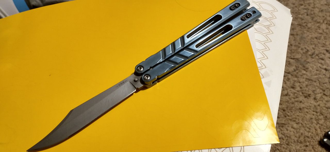

Picked up a new ZT 0640 this morning from the local blade shop, as well as a second Piranha Amazon. Started checking the parts bin and found some spare titanium standoffs that matched the originals width perfectly. Swapped out. Also tuned and centered the blade, it came off center in the box new. Also found that on the Amazon the thread hole offset for the clip is the same as a Benchmade. Decided to toss a deep carry satin clip on it. There is a fish on the show side, butterfly on the clip... at least the thing sits slightly more deep in the pocket.
