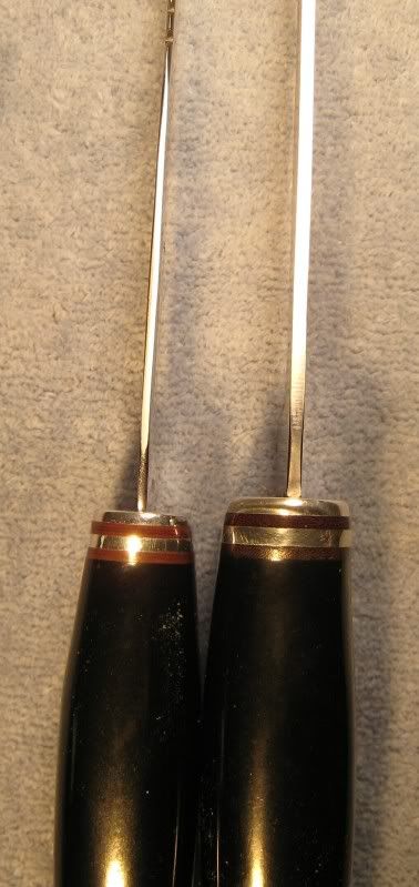

Hey Telechronos,
You mind showing picture of one of your early thin fishermans vs a thicker three liner similar to 300's top-down photo of his three 3-liners?
Thanks gw

Flatlander:
Here is a pic of an early BUCK scaler alongside a BUCK 121 USA knife. I cannot speak to later dated models since my collecting stops before the knives were date stamped.
You, however, can see a significant difference in blade thickness. I have a suspicion that the dated blades were even thicker.
Hope this is what you are looking for.
Telechronos:):):)
Thanks for the photo above Tele,
I have never seen what the thickness of the 121 was back when it was a filet knife. I always wondered what Buck was thinking to market the 121 as a fishing (Filet) knife when it was just to thick to flex like a good fishing (filet) knife should. Now I know, it was a thinner knife and looks like it did have good flex....way back when!

Hey Telechronos,
Thanks gw[/QUOTE]
I'd be happy if you just mic the two and post the figures . Thanks DM
David:
On the scaler, you must bear in mind that they were hand ground so there is a 10/1000 variation along the blade. Generally, it is between 50-60/1000 with the thickest point being at the guard.
On the BUCK 121 USA, at the guard, it is 78/1000, along the blade it is 76/1000, much more uniform. But that is after the production methods at the Magnolia Plant had been significantly refined.
Not being a machinist, I'll leave it to you to put it in decimal form.;)
Telechronos:):):)
You numbers got me curious Tele. Me thinks your decimal equivalents would be .078 for 78/1000, and so on.
I measured the 2-liner I have and the thickest part of the blade near the guard was .056 +/- .001.
Peter
Peter
The 2 liners were hand ground also. I measured one of my two liners and got a nearly uniform .051 +/-.001. I suspect that the variance in thickness may also have to do with the forging method used at the time.
With the one and two liners being hand ground, I suspect that there is a variation from one knife to the next. Frankly I haven't taken the time to mic the others that I have.
Telechronos:):):)
I measured one of mine a three liner . On this one the letters of the stamp are small espically the usa and the 121 extends up into BUCK . It ran .081 to + 1 on most of the blade . Very interesting ! So, the two liners are more like a 1/16th . DM

Telechronos, Red spacers those are cool.Thanks for the picture
comparison .:thumbup:I did not know that they were so then .

Tele, Thanks for the photo and the measurements .
JB, Looks like a good supper . I can smell it from here . When the wind blows just right ;) . I didn't know Buck had changed that model so much thru the years . Even changed the name now . I'll have to echo Hawk's sentiments on this 121 post . I've learned a lot . Sometimes these things keep developing and checking in is a must . Hawk, I noticed the stamp on yours is just like mine . Note how the numbers extend up into the word Buck and the small usa . Also, I've noticed that this model sharpens up quickly even with it being modified 440C which I think is because of the thin edge geometry . You don't have to shave down a thick edge bevel . Nice leather work Jack . DM
