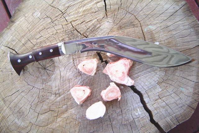

and now the original authentic pictures as taken by Yangdu today:
I'm speechless. Lovely!

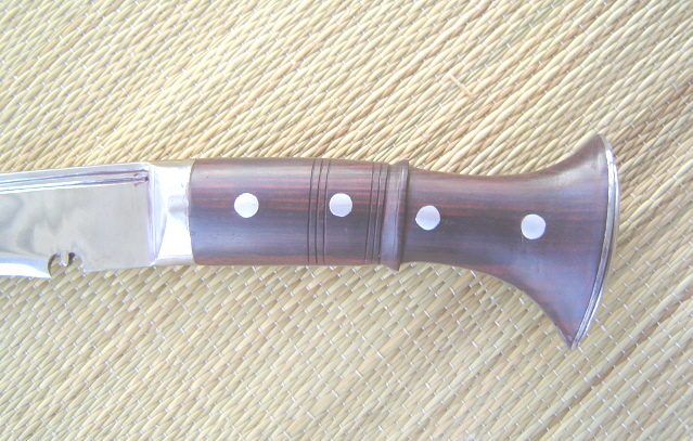

Check out this handle. I've never seen anything like it. 4 pins!
Whoa! Bones. Look at those FULLERS. Whoa baby!!!

Good Lord man! that is awesome:thumbup: I very much like it:) What is the primary difference between this and a standard 20 inch AK though? So I take it that this beast is a custom made to your specs?
Well, I have a chiruwa 20 inch ang khola khadka (CAKK) that's pretty awesome.
I WILL compare the two, but I believe this one has more pronounced and longer fuller, a longer handle; I suspect there's some spine differences... and it might be wishful thinking, but I think the bonecutter should be wider and more leaf shaped.
We shall see huh?

Looks great to me. I like the beefed up handle. The length to weight ratio seems right on to me. Looks perfect to me not too heavy and has gorgeous fullers to boot. :thumbup:
I guess it ultimately would come down to how big the handle is. I don't have huge mitts so that is a concern for me.
If the intention was to reproduce the Bonecutter design that I have it doesn't even come close.:thumbdn:
That just looks like a big Ang Khola stretched out.:rolleyes::p

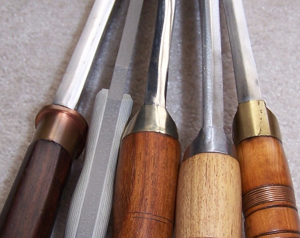

R to L: Bonecutter, Dick Singer Samsher, FFBM, Sherp, and HI Bolo with FB handle.
R to L: Bolo, FFBM, Samsher, Sherp, Bonecutter
Spines L to R: Bolo, FFBM, Samsher, Sherp, Bonecutter (look at that Bonecutter, its almost as thick as my Bolo)
One more image just for fun. Can you see how wide the edge bevel is on the BC?? Its over 1" wide. Thats what makes this khuk penetrate so well. The only khuk I've owned that comes close is the HI Samsher. Which, IMHO, is HI's best model for chopping and for looks.

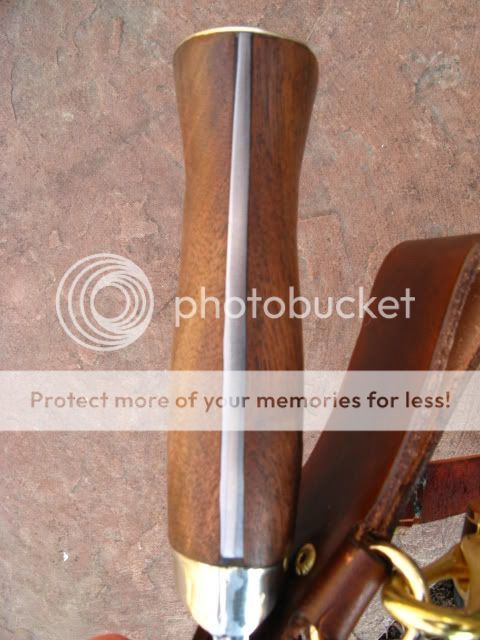

I don't have a BC to compare but I can offer my handle insights.

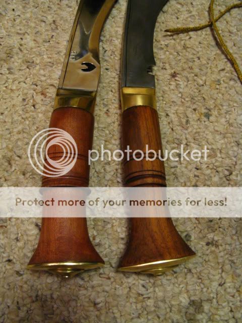

This handle done by the Sarki shop for an M43 is ideal IMHO. The top of the bell is reduced and the handle has a nice contour.
My Gelbu Special for example had a WAY too thick handle. It protruded from the bolster significantly. I had to reshape it and actually make it slimmer than the bolster in order to fit my hand correctly.
Here you can see it compared to my WW2 which has a perfect handle for me.
Here it is after the reduction.
The version produced does look like a modified AK. The curve just doesn't match the original.
