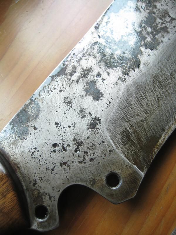

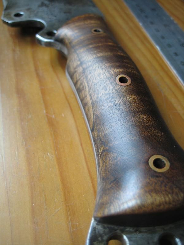

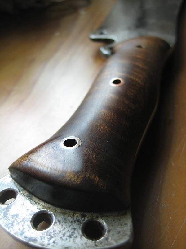

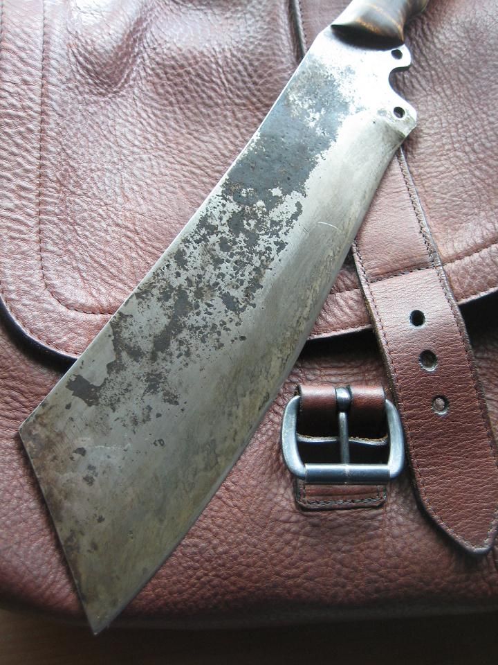

I got this one off the bay last year intending to make a chopper out of it & have done some work on it in preparation & finally took some pics yesterday while working on a knife handle.
It had some badly broken wood scales held on with steel pins..they weren't worth saving so I trashed them & will rescale it in either rubber from a tractor wheel flap or some nice oak I found on a pallet.(leaning towards the oak,it just looks better)& brass pins.I also have a hickory handle from a sledge hammer I could use.
I was thinking about the rubber because of the unevenness of the forged flats on the handle,the rubber will fill the gaps I'm thinking,but I could just fill 'em with epoxy when gluing on the wood I suppose.(and again,the wood handle would look better)
I really want to reduce the weight so am thinking about cutting it off at the line I marked on the blade & cutting the tip at an angle from the back of the hole to the tip of the edge & maybe shortening the handle to the third hole.
It is just shy of 3/8" thick at 11/32" & weighs in at 2.85 lbs without scales,with an OAL of around 17".
And it has a nice taper to the blade & tang as you can see.
It's quite the beast to be swinging for any length of time & I would like to use it while camping,but I'm not sure if I should cut it down.
So what do you cleaver lovers think,should I keep it close to original or cut it down for a user?

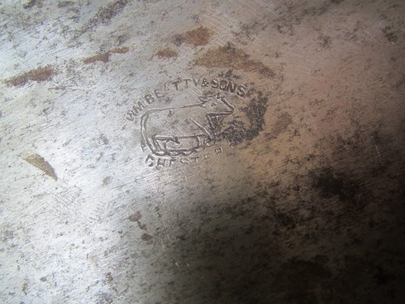

It's marked..
Village Blacksmith Interprise Special
Solid Steel Forged Dallas Tex
Watertown Wis
9

I'd leave all that metal on it. The extra weight near the hole gives it a more powerful chop, and the handle as it is now could work for a two-handed grip (not so common to find them this way without paying a lot more). Just my 2 cents.
.....but I'm not sure if I should cut it down.
I wouldn't it cut down. You need that mass out at the end for it to be a decent chopper.
Yeah--leave that puppy alone! :D I vote for the rubber scales. Nice and utilitarian. Nothing says it can't be a user without cutting it down. ;)
Ok.. thats 4 for not cutting it down.

Personally, I say having a tapered tang, the length, and the fact it's about the right thickness, I'd sculpt that into a hardcore cleaver/tomahawk hybrid. That's just me though. ;)
Yup,something like that is what I wanted to do,but I wanted to leave the markings on the blade.
Maybe cut it vertically at the 5" mark & say to hell with the markings.I want a user not an arm abuser.;)
And make an Ulu out of the cut off end.Hmmm...the wheels are turnin' now.:eek:
