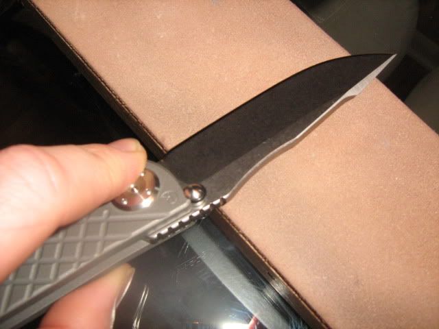

In my last post I mentioned pressure points, with the use of small amounts of pressure in specific areas you can follow the angle and curve of the blade easily. Picking your angle will mainly come down to how you like your knife to cut and the abilities of the steel to manage such angle. Almost all steels will be able to handle much lower angles than most think, given proper HT its not out of line to say that 10 degrees per side 20 inclusive would be fine for most folders/pocket knives. Some steels will see more deformations and small compression points (those things most call chips) but because the angle is already low it means you don't need to remove as much steel to fix and resharpening takes less time.
Following the curve of a blade is probably one of the harder points of sharpening because their seems to be more of a fixation on angle. Its fine to know what angle your sharpening at but if you can't properly follow the curve you end up with tips that are not sharp, belly's that are not sharp when the tips are, and uneven bevels along each side. Did you ever wonder why when using a jig sharpener you'll see the tip get wider on some knives? Its because the jig is following a single angle on a single axis basically creating a cone shaped circle. Think of it like a X and Y axis, the X being the angle per side and the Y being the shape of the blade ie. re-curve, tanto, large and small belly blades. If you have a scandi ground knife its easy to learn the proper way to follow the curve of the blade because it lets you know on a large scale where you missed. Another good example of how the angle changes throughout the curve is if you take a dinner/salad bowl, flip it upside down, then lift it at a angle so just one point of the rim is touching the counter. Now roll the bowl around its rim but keep at your tilted angle. That feel in angle change in a 90 degree section of the bowl is the same as in a belly of a knife.

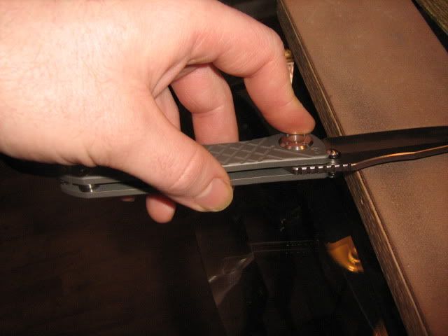

2 movements and 2 to 3 pressure points are all that's needed to sharpen a knife. The first movement that we all understand is moving the blade down the sharpening surface, the second and very important one is lifting the handle vertically from the stone. Lifting the handle is one of the key points to keeping your angle and curve correct. The first pressure point and the one I find to be most important is down pressure in the choil area, along with the lifting of the handle this is basically all you need to know to get your bevels correct. I know, sounds way to easy.
The next pressure point or 3 is your thumb and remaining fingers, your thumb will support the back of the blade from dropping and steady your angle so the pressure from your index finger is the only real pressure you are applying. Your thumb and index finger almost create a twisting motion of pressure forcing the edge to stay in position on the sharpening surface.
The last and optional one and the one I don't have a pic for is placing your freehand on the blade. You can use a single point of contact like placing your index or middle finger in the belly and applying pressure when the handle starts to lift.... Or spreading you fingers across the blade to control bevel pressure where you want it. I use this method when using benchstones but its not really a option when you are holding both stone and blade.
A LOT of freehand sharpening is about feel, its the feel of what you are doing that is more of a guide than anything.
I hope I have done a decent job of explaining this as its not easy to put into words, please ask questions if not understood.

As the sharpener you are the artists, you continually shape and refine your work until its just how you envisioned it. I like to keep my grinding in the center line of the blade, if you were to draw a line down the center of the spine then cross section the blade in half the apex of your edge should be at the other end of the center line.
I don't count my strokes or do one side then the other, I work on each side a little bit at a time. I feel this method of not over working one side too much prevents mismatched angles and leades to a more uniform bevel formation.
Once the main grinding is complete all the following steps are simply for refinement of the set bevel. How far you refine the edge depends of how you like your edge to cut.
For stropping/polishing and like all other steps I follow a close grit reduction without skipping abrasives. As shown in the thread, after the EF 9 micron hone I use the 6 micron paste then the EEF 3 micron hone followed by the 3 micron paste. To continue the progression 1, 0.5, and 0.25 would be the path to the dark side ;)
Before you strop you need to know the difference in abrasive size from your stone/hone to your polishing strop. Example: two knives, same steel, same edge angle, one finished to 600 grit and the other to 10k grit. You now polish each blade with 0.5 micron 50k grit compound, which one is sharper, more polished and more effected by the polish?
