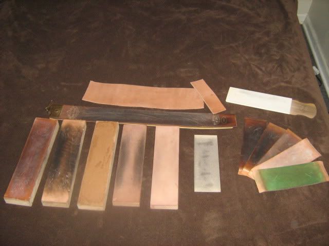

The newer steels in pocket knives will take MUCH longer to sharpen than your kitchen knives, even longer if your sharpening tools are of a softer abrasive. The 8-12 hour thing is because of the steel and all the final polishing that is involved in getting a edge to that level. In total its about a 9-11 step process with 3-5 of that being the polishing, the first 6 is the stones. After that though touch-up only take minutes with a strop or finishing stone.
Hard to say because I only get to work on them in my free time, probably 8-12 hours.
All freehand.
14lbs of steel
And a strop or two ;)

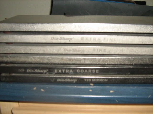

Would you be so kind to identify (bottom to top) each stone please? Some are easy to see others, not so easy?? Also are these the DMT 8 x 3's? I'm only finding 5 Dia-Sharp stones and it appears that you have 6 in your stack.
What do you think of the 6" dual sided? Saves some cash but not as much room.
A man can be handicapped by the wrong equipment. :)
Its the full set of 8x3 stones XXC-EEF, I had the 6x2 but they were too small.
