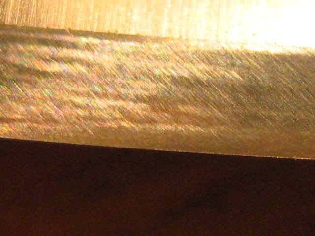

Keeping a consistent angle especially when starting a new one can take some time to get right. Its not always perfect though and 99% of the time it looks more like this.
Freehand

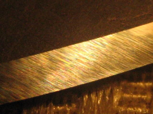

Using a aligner would look more like this
Freehand
lol, gott it!...because the first sample looked way better than what I got free hand and to me that looked pretty good. Nice to see what I can expect once my aligner arrives in the mail. thanks for the pictures, they always help!
