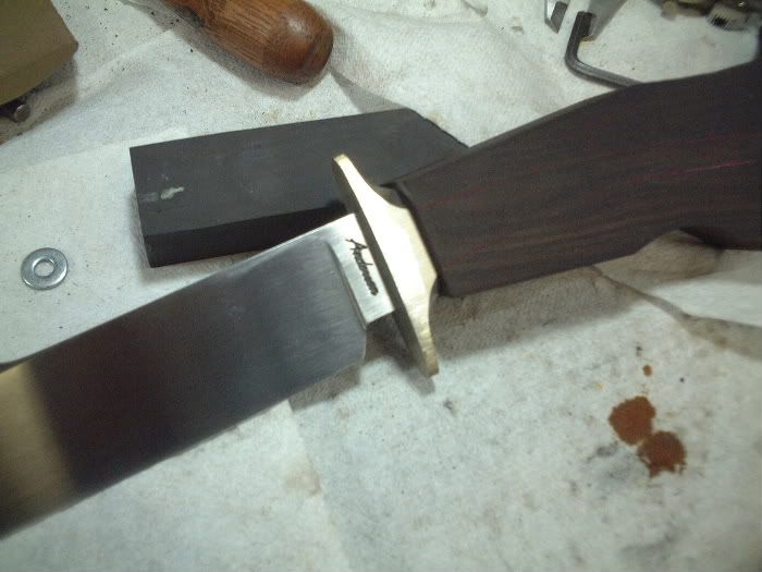

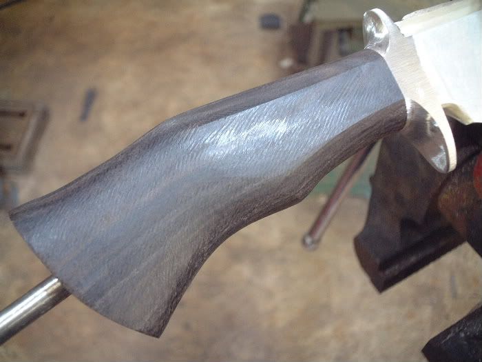

A couple more pictures of how nice it is to work with files. After the Cabinet rasp, I switch to finer 1/2 round/flat files of two different teeth configurations and things are so easily controlled it's almost fun to do it.
I just keep gradually working toward the guard, and letting that predetermined shape guide me.
I built that vise station out in the middle of the room so I could attack my handles from all sides. I built that knife vise so it sits on my sanding bench, and I can quickly remove it to the vise station as well. It's really easy to see the knife from all directions when it can move infinitely.
Notice the pile of Blackwood on the floor at my feet - it's not dust! It's chunks of wood.
That file digs it off in a hurry.

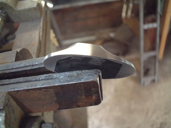

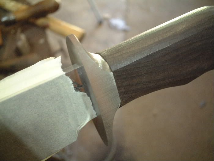

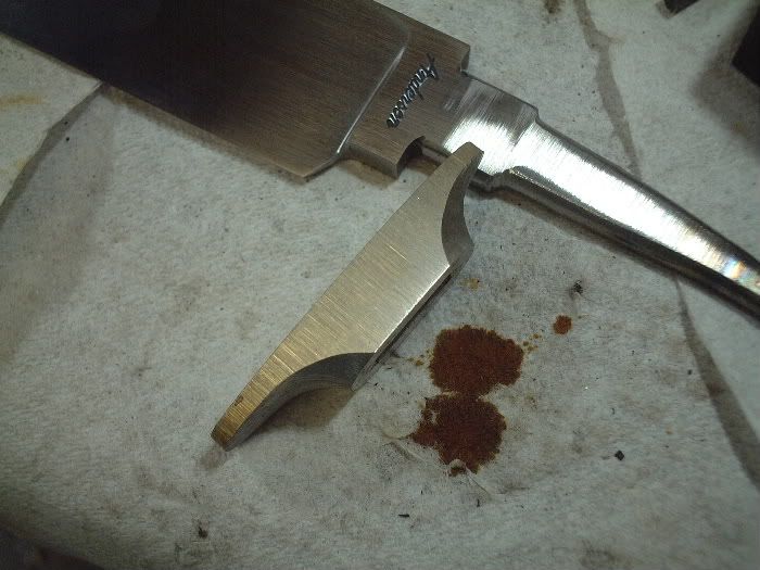

Now I can focus a little bit on that guard.
It's nice to be able to work on parts independent of the whole:

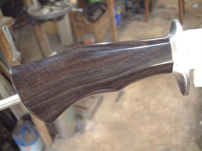

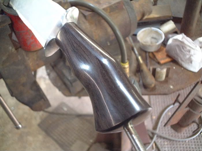

I wanted to clean up the butt some and thought it looked cool polished in contrast to the remainder:
I took the handle to a 2000 grit and a quick buff - this really accentuates any latent filing/sanding marks:

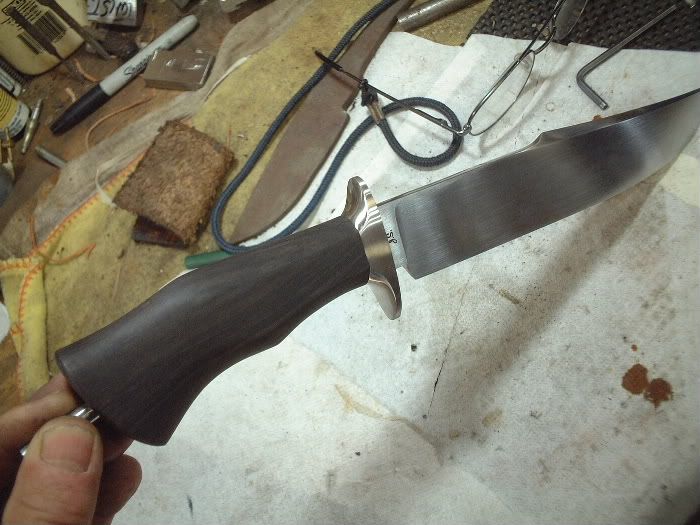

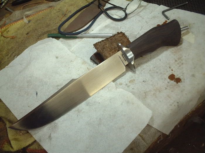

Here's how she looked when all shaping was done:
Tomorrow I will go through a quick run-through of the creation of the finial and finalizing the guard, but until then, here's a little preview:

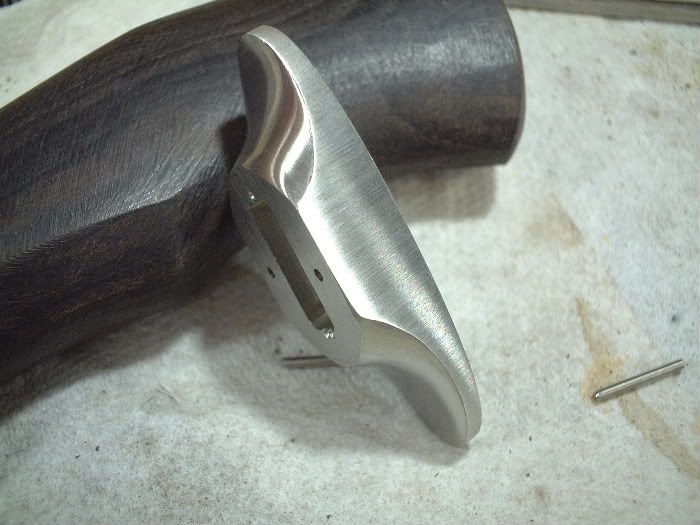

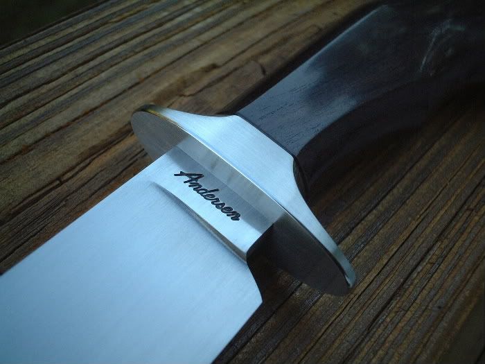

I then give the guard a better shape:

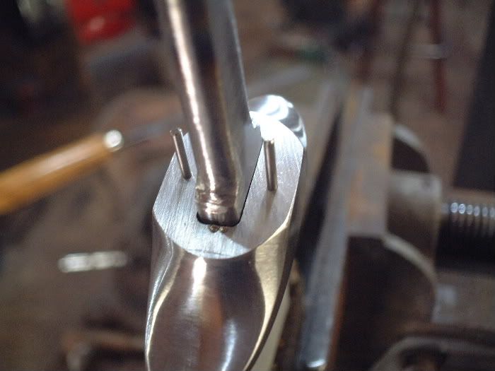

And have pinned it to the handle with .625" stainless dowel pins:
I have difficulty imagining how to drill for the pins to line everything up spot on. It seems like it would be easy to drill the guard as it is flat with two opposing parallel surface for the front and back sides so drilling would be exactly perpendicular, but how do you line up the handle and drill it? It is already not just a square rectangular block so clamping it up so the drilled holes would be exactly square and exactly in the same lines as the drilled holes on the guard would be hit and miss for me. Also, what size drill bit do you use for what size rod stock?
