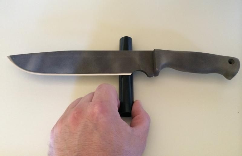

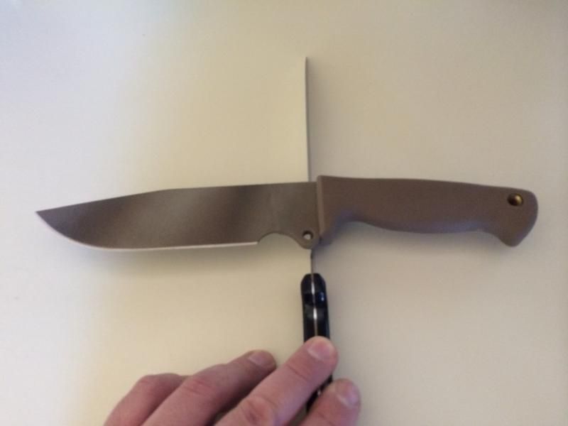

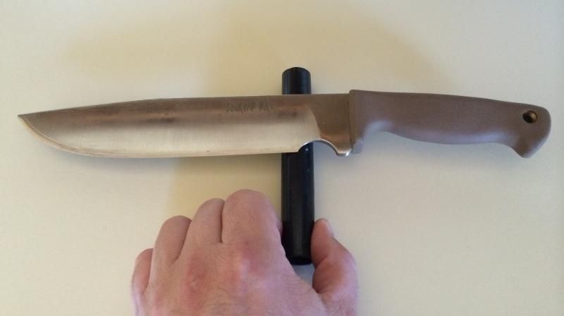

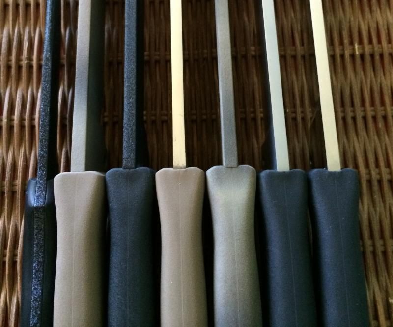

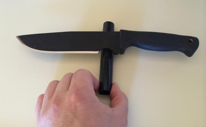

Here's what I got for measurements from the knives I had handy (My CGDF and my Battle Guard are with norcalblacktail right now).
B10LE choil, B10 DCBB no choil, Battle Rat, Satin Battle Rat, Camp Tramp, Euro-6, Gen-1 RMD. Told ya I like Res-C.:D:thumbup:
(last pic in reverse order)
Here’s are the measurements for each blade…(disclaimer, these are my knives and some have been whooped on and re-sharpened)...
Model = Thickness / Blade Length / Blade Height in front of choil
(on the SBR, CT and E6 I also measured right at the clip transition on the spine)…
B10LE w/ choil = .218” / 10.125” / 1.625”
B10DCBB no choil = .203” / 10.125" / 1.625”
Battle Rat = .250” / 9.375” / 1.750”
Satin Battle Rat = .218” / 9.25” / 1.718” & 1.750”
Camp Tramp = .234” / 7.375" / 1.812” & 1.781”
Euro-6 = .265” / 6.812” / 1.625” & 1.593”
I measured the thickness on the spine directly in front of the handle.
I also ranked them by "FEEL" from most blade heavy to most neutral. Here's the pic of that order...
BR, CT, SBR, B10LE, B10DCBB, E6 and RMD (I kinda wish I still had my SOD, but NO REGRETS)
UPDATE: I had a different order when I first posted this info, but I just went in again after dinner and did another side-by-side "feel" test. The SBR and both B10's are sooo close in feel, that it's hard to tell much difference. The CT felt a smidge more blade heavy tonight than it felt earlier this afternoon for some reason....maybe I needed more "Iron" in my dinner meal.:D:thumbup:
I can't remember where the Battle Guard ranked in the "Feel" arena (I want to say between the SBR and CT, but it could be between the B10LE and the SBR). Even though it's not here, the CGDF is the BEAST of the bunch with it's Massive hunk of SR-77 sitting out in front of its Res-C goodness!!!
I also took pictures of the balance points of the blades and I'll paste those into the next post...
Here are the Balance points for each blade (MAN that E6 was hard to balance on that knife edge!!!):eek:
I confirmed with a straight edge both B10's and the SBR are FFG's...So if the B8 really is a TRUE .220" blended zero convex grind...it WILL be thicker than my B10's and may feel identical to the Camp Tramp!!!:thumbup::thumbup::thumbup::thumbup::thumbup:
