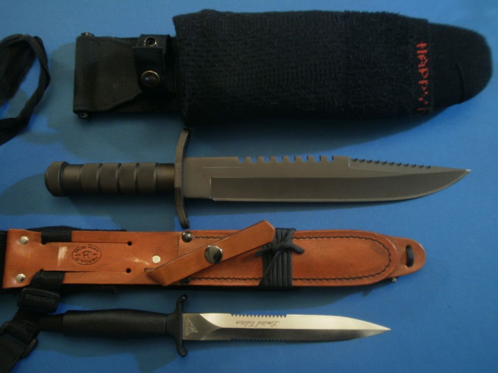

Now that I think of it, there was another widely available "mid-range" Hollow Handle that was around 9" (8.4" plus the 0.6" handle "extension" you can see) and yet also way above teenage-market crap: I should have known, because that is the one I actually bought as a teenager in 1985!: The Aitor Jungle King I, early version, with a beautiful slim leather sheath, available for only one or two year from 1985 before being replaced by the clunky plastic sheath: I never had any interest in the box-like plastic sheath, as I already carried inside the waistband even back then...: Mine was like the one on the right:
With the oversized handle devoid of cord it actually felt a little like my current Colin Cox... Handle capacity was huuuge...
The downside was the very low flat-ground sabre grind: Sadly it was an extremely dull knife that was very difficult to sharpen owing the unfavourable low-sabre geometry with no hollow grinding: Had it been hollow ground it would have been much better... Today maybe REK could raise the bevel, or thin it out to an acceptable level...
The sawback and the sheath were the two best things about the whole knife: Even today I would rate the original triangular (push reversed) sawback as one of the best I have used, though it tended to "fill up" a little...
I wish I had known about the Parker K692 back then, as the dullness of the Aitor is still a searing memory today (I grew so frustrated I lost interest in large fixed blades for quite a while after that)...
Looking back at the Buck 184 collector's site, I realize that my "no name" version of the Parker Cutlery K692 is actually not really "no name", but simply a less openly marked "Oryx Raider II Survival Knife", which apparently was made from the 1980s into the 1990s.
http://survival-knife-184.com/copies/copies.html
Nothing in the sheath to prevent the knife from slipping out by over an inch, so I wasn't losing much by having no sheath with mine... The modified BMF sheath I now use for my "Raider II" happens to be also from the same 1980s period... You can just make out the transverse-mounted AAA Maglight at the top of the belt loop: A perfect fit!
I really think it is great that they did not simply scale up the Buckmaster to 9": It is surprising to me they went all the way to 9.8", which seems counter-intuitive...
I never understood why they chose 7.5" on the original Buckmaster: It must have been a limit set by the military... If they had offered it in two sizes, I would certainly have got the larger size back in the 1980s, even if it was just 9".
The BMF went from 8" to nearly 9", and I'm sure it gained a lot of sales over the Buckmaster because of this, as it was its main competitor... The BMF is still a nice knife, not too thick edged, but 9" is a bit too small for me nowadays.
So far the only other "Big" mid-ranger I can come up with is the old Aitor... There are probably other mid-range HHs of that time, but they are mostly of a stock thinner than 3/16".

Just got my Colin Cox in... Well packed and well made, no issues there...
Unfortunately, the knife itself can't compare to the first Cox I have... It is well made but 2-3 issues really hurt it, not present on my first one:
First issue, the worst, is that the edge geometry is 0.040" at the bevel shoulders (0.020" on my first one, just like a Randall!), and the hollow grind is rather shallow, which makes thinning the bevel worse.
I had bought this knife hoping the bevel was comparable...: No such luck, it is about like my Chris Reeve Jereboam One piece, which I got rid of...
The sheath looked thin but was actually very well made, and the strap is fully tight to the knife: A pleasant good surprise...
Second bad issue: The tube used for the handle is not thin walled like my first Cox, but rather unnecessarily thick, like well over 1 mm, or over 0.040", the result being that, despite being a 10 inch blade, the knife has terrible balance, the center of gravity being backward from the guard which is amazing for a 10" blade of 1/4" stock... The pommel is hugely heavy, and probably all steel, so that plays a big role as well...
To give an idea, the Lile Mission balances well over 1/2" into the blade. Just magnificent in comparison... My broader blade Cox balances about 1/4" or more as well.
The knock-on effect of this is that my new Cox knife feels very, very heavy, especially in view of how narrow the blade is: Even the Reeve balanced about in the guard, or a hair in front, and that just felt like an anvil, while the exact same weight Mission feels like a large feather...: This "anvil" feel is the same effect on my new Cox due to the narrow design of the blade: That poor rearward-heavy balance I suspected would be the case, but I hoped the handle walls would be thinner to help things out...
There's nothing else in that class to buy anyway, so maybe I'll sharpen it and use as a beater to save on my other knives... The compass was dry-type and works very well.
To give an idea, even the uranium-like Oryx Raider II balances maybe 1/8" into the blade, and feels fun to carry in comparison... I would say the new Cox is barely one or two ounces lighter than the 27-28 ounces Oryx, but, incredibly enough, it is heavier than my earlier Cox below, owing the thick tube handle walls: If you are heavier than this monster below with an empty handle, and with a shorter and much slimmer blade, that is not really promising...:

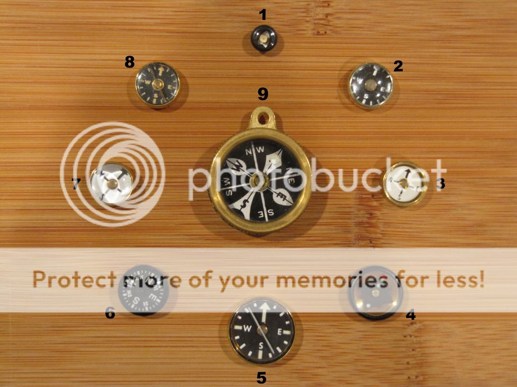

Here is my mini compass collection for comparison. The Waltham (#2) is the most rare and highest quality, as far as finish. The bottom edge of the brass case is nicely rounded.
1) Karl Mfg., .25" brass, dry, non-luminous, USA (1990s)
2) Waltham, .50" brass, dry, non-luminous, USA, used by Randall (early 60s - early 70s) and by Lile in the original 13 First Blood knives (early 80s)
3) Marbles, .50" brass, dry ,non-luminous, USA, used by Timberline (late 80s)
4) Pyser-SGI, .60" brass, dry, luminous, England (? - present)
5) Marbles, .75" brass, dry, luminous, USA, used by Timberline (early 90s)
6) Tokyo Compass, .55" plastic, liquid, luminous, Japan, used by Randall (late 90s - present)
7) Marbles, .50" brass, dry, non-luminous, USA, used by Randall and other custom knifemakers (mid 80s - late 90s)
8) Marbles, .50" brass, dry, luminous, USA, used by Randall, Lile, Timberline, and other custom knifemakers (70s - mid 80s)
9) Marbles, 1" brass, dry, luminous, USA (mid 90s)
Yes mine is like your #8, with identical lettering and center axis, except that yours appears to have some letters in a kind of "yellow" off-white. Mine is all-white.

I agree wholeheartedly... Incidently, your "1911" hollow handle knife is next on my "bucket" list, as I am a big fan of it... :)
I don't really see it as a "pure" Survival Knife however: I think it is a pure fighting knife with a versatile "survival" option...: The 3/16" stock certainly points that way...
I love the way the long clip drops the point in a pure fighting style... I think everything about it is just the way I would have done it for a soldier's knife... :)
