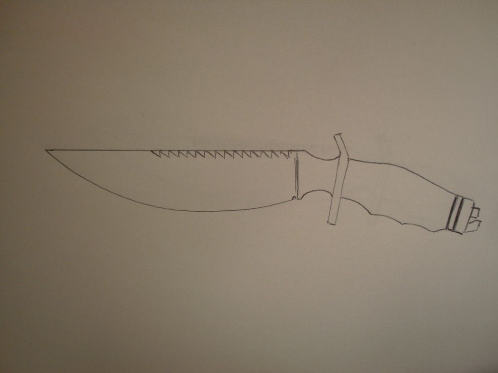

I also came up with a rough outline of the design I mentioned earlier as to what I think would be an "ideal" Survival Knife (the mechanism depicted on the pommel represents the fixation for the slingshot):
I don't understand how a recurve has only downsides.Recurves are designed to shift the weight forward making them excel at chopping. Different variations of the bolo knife have been used for survival for 100 years. They must be doing something right.

I'm confused again.Your design seems to be the exact opposite of what you like in a survival knife - a knife with a forward heavy balance. Your design reminds me of the Dartmoor Survival Knife, but the Dartmoor's belly is in a much more useful location for chopping.
The Bolos you show have almost no recurve in any area they are intended to use, so they don't suffer much: All they do is provide a dull unsharpenable 2" section near the ricasso...
You don't have to use a recurve to flare the blade. It is the flare of the blade that shifts the weight forward, not the recurve.

The Dartmoor has a 7.25" blade, while my drawing easily has a 10" blade... Surely, despite the added weight of the Dartmoor saber grind, you cannot be saying there would be any comparison in chopping efficiency? Given the mass of the Dartomoor's handle, it must barely be blade-heavy...
Putting the belly far forward can only be of use on a very long blade over 11", and with a lot of flare. Knives below 11" cannot rely on the blade weight being spun to be efficient... Compare the Kukri-like BK-4 against a BK-9 and it cannot even compete, despite the Bk-9 being near the bottom of the barrel among large knives because of its thin 3/16" stock and heavy full tang handle...
For efficient chopping, knives below 11" that are pointy cannot rely entirely on being spun: They must use wrist locking to one extent or another to bring some of the weight of the arm into the cut. If you take the Cold Steel Trailmaster, which is about level or below the BK-9 in chopping performance, this is a knife that cannot be wrist-locked at all because the handle is so thin it moves around in your hand (to the point of etching the hand full of red dots from its new style round checkering violently moving around within it), which ruins entirely any attempt to bring the weight of the arm into the cut... Because of this, the Trailmaster forces you to spin it to use the weight of the blade alone, which is greatly helped by the stick tang and the heft of the 5/16" stock blade: The knife is actually quite pleasant in this mode, giving an impression of efficiency, but the actual performance is miserable compared to knife of the same weight, like the Lile "Mission", which can be wrist-locked thanks to its fat handle...
Wrist-locking is less pleasant but about doubles the chopping performance: The requirements of emergencies are not the same as for knives that are used all day for non-emergencies: It is illusory to assume that everyday chopping comfort translates into actual maximum performance for the same size: If you spin you either have to go much larger and blunter-tipped (although the SP-53 is a reasonable size at 10" and 23 ounces, and is one of the few that can probably really do it, but it is quite blunt-tipped), or you have to settle for dreadfully shallow bites (over twice as shallow in the Trailmaster compared to the Lile Mission)...
Since wrist-locking is unpleasant on impact, the way to alleviate this (besides a very thin 0.020" hollow ground edge which "softens" the blow the best) is to spin the knife slightly, and hit as close to the guard as possible: This is about 3-4" into the blade, which is roughly where the drawing I did peaks its belly: If you understand wrist locking there is nothing mysterious about the design I did...
I used a Full Flat Grind in the design to optimize the sawback, but the same design probably would work even better as a Saber Hollow Grind if you don't mind 3-5 more ounces, and a less effective saw...

Gaston, you're just showing your ignorance on the subject. Your lack of understanding about recurves and blade design, (as evidenced by your knifelike object which appears to be a farm implement from an 80's European action movie set in the future) is ridiculous.
You should go full scale production with that "knife" you concocted and I'm sure you will sell many to the competition survival-chopping slingshotting crowd. The same with the "balances at the guard" business. Knifemakers can balance the blade just about wherever they like, within reason, and for general use knives (almost the very definition of a "survival knife") at or right in front of the guard is what most people want.
And it works, keeping hand fatigue down and making what might otherwise be an unwieldy blade more manageable by counterbalancing it. Your obsession with chopping is fine, do what you want with your knives. But know that most of the people reading this thread are not falling for this drivel you're spewing as though it were gospel fact.
A quick look at your knifelike object you drew raises a number of serious issues. But you should find this out for yourself by attempting to make one of those things. Best of luck.
I dont think anybody has ever designed a blade looking more ill suited for chopping.

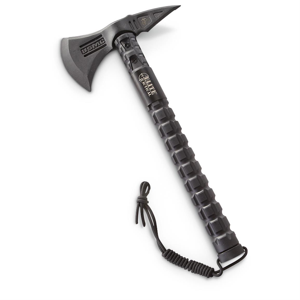

Thought of Gaston when I saw this...The Ultimate Survival Chopper! :thumbup:
