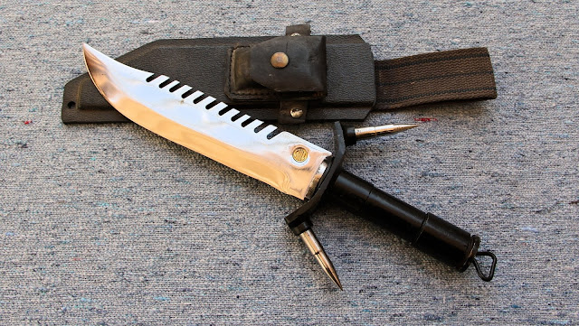

Did a bit of testing of the Voorhis vs the fighter-like re-ground Cox, this under heavy rain a few weeks ago, and got some surprising results...

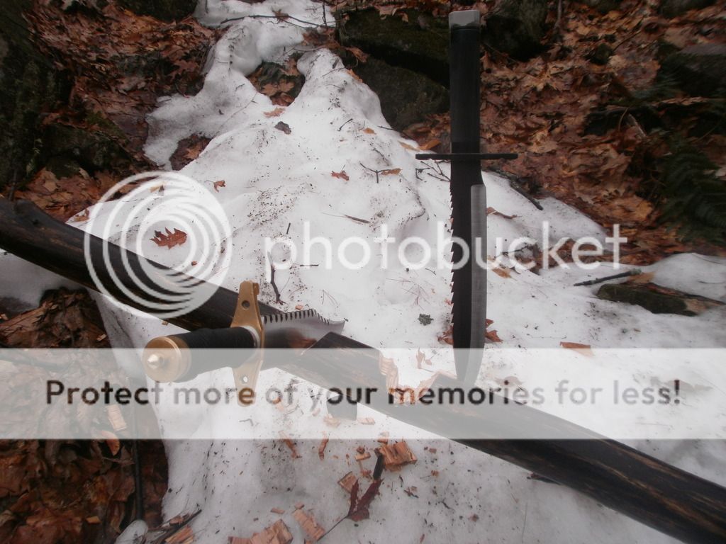

Despite the disparity in size (11.25" blade vs 10 1/8"), and the broad 2.2" plus flat grind vs the barely 0.75" sabre hollow grind, the difference in raw chopping power was only about 25%. At 22 ounces the Voorhis may have been significantly lighter than the Cox around 25-27 ounces...

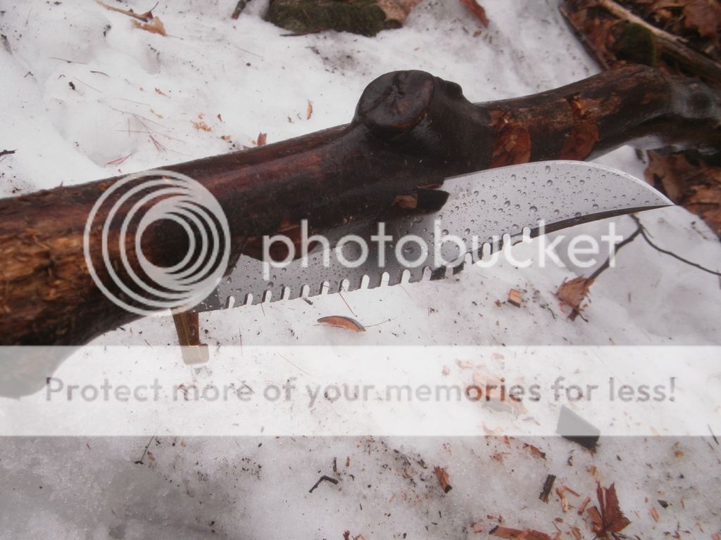

The bigger difference was the rain: Rain causes really broad flat grinds with thin edges to stick in the wood! The effect is so severe the knife cannot be beaten out, but rapping the wood exactly opposite to the edge itself (flipping the whole thing upside down) liberated the knife instantly...
This happened twice in a row so it definitely was not a one-off: The sabre hollow grind showed no such effect. The effect would be less on the lighter Lile Mission: This knife is simply too big and would require a really light touch to avoid this...

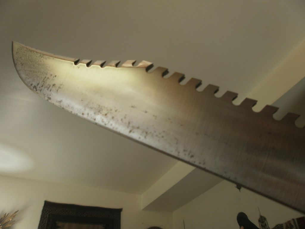

Before I could get back home the 5160 steel was of course heavily pitted, there being no way to wipe it dry under rain...: This is going on the auction block...
The Patriot leather held up very well, helped by the fact that the socks kept most of the moisture away(!)...

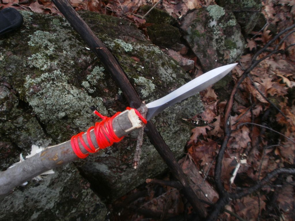

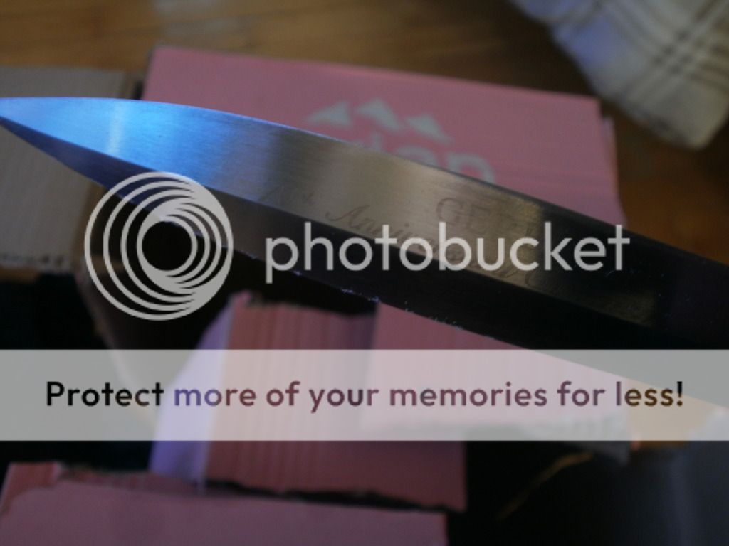

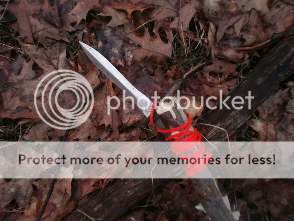

On another occasion I tested a new "split stick" attachment method for a spear tip dagger, since tying up alongside the shaft proved marginally OK, but not secure enough for repeated throws. The guinea pig this time was a Mark II dagger, whose S30V steel made it incapable of holding its apex straight, even while cutting light cardboard...: The nail test after just a few cuts shows there is basically no depths to which this steel will not sink... Probably that skewed apex will hang on forever, giving fair cutting performance, but still...:

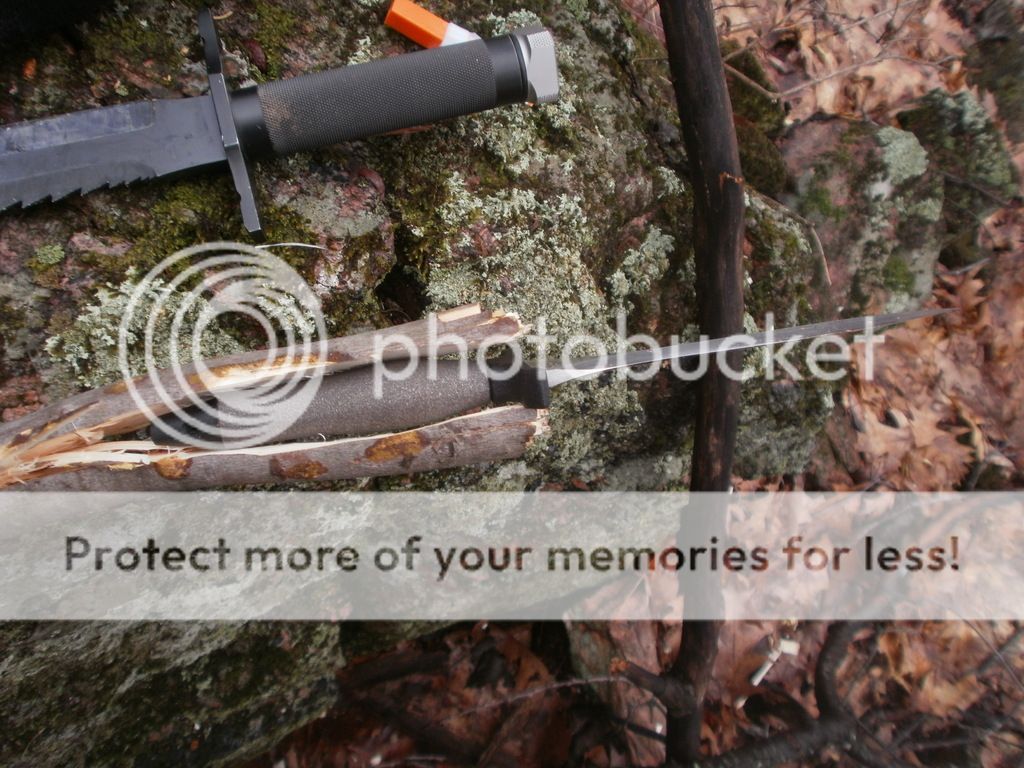

In any case the idea was to test if a non-removable handle could be tied securely: The Colin Cox did a good job, but I can't imagine how awful it would have been if the whole knife had not been re-ground by REK...:
Surprisingly the extra-fine point survived throwing quite well, but the overall idea offered only a slight improvement in stability...:
There were other problems too: Splitting a stick large enough to "swallow" in a complete handle meant it was too large in diameter to throw well, and the weight of the rain sopping into it made it a terrible spear to throw... I now think only task-specific nails can offer a useable solution, including a large rigid nail fitting tightly through a hole in the exposed tang (if the handle is removable for the split-stick option), or a large lanyard hole (if the handle is non-removable, which imposes the simpler alongside position).
Unfortunately the Mark II dagger has its lanyard hole parallel to the blade axis, and the Gerber Guardian II has no lanyard hole at all... To be fair the Cold Steel Bushman is probably a way better and simpler solution to all of this, but I just don't like it, so I'll keep fiddling with alternatives
