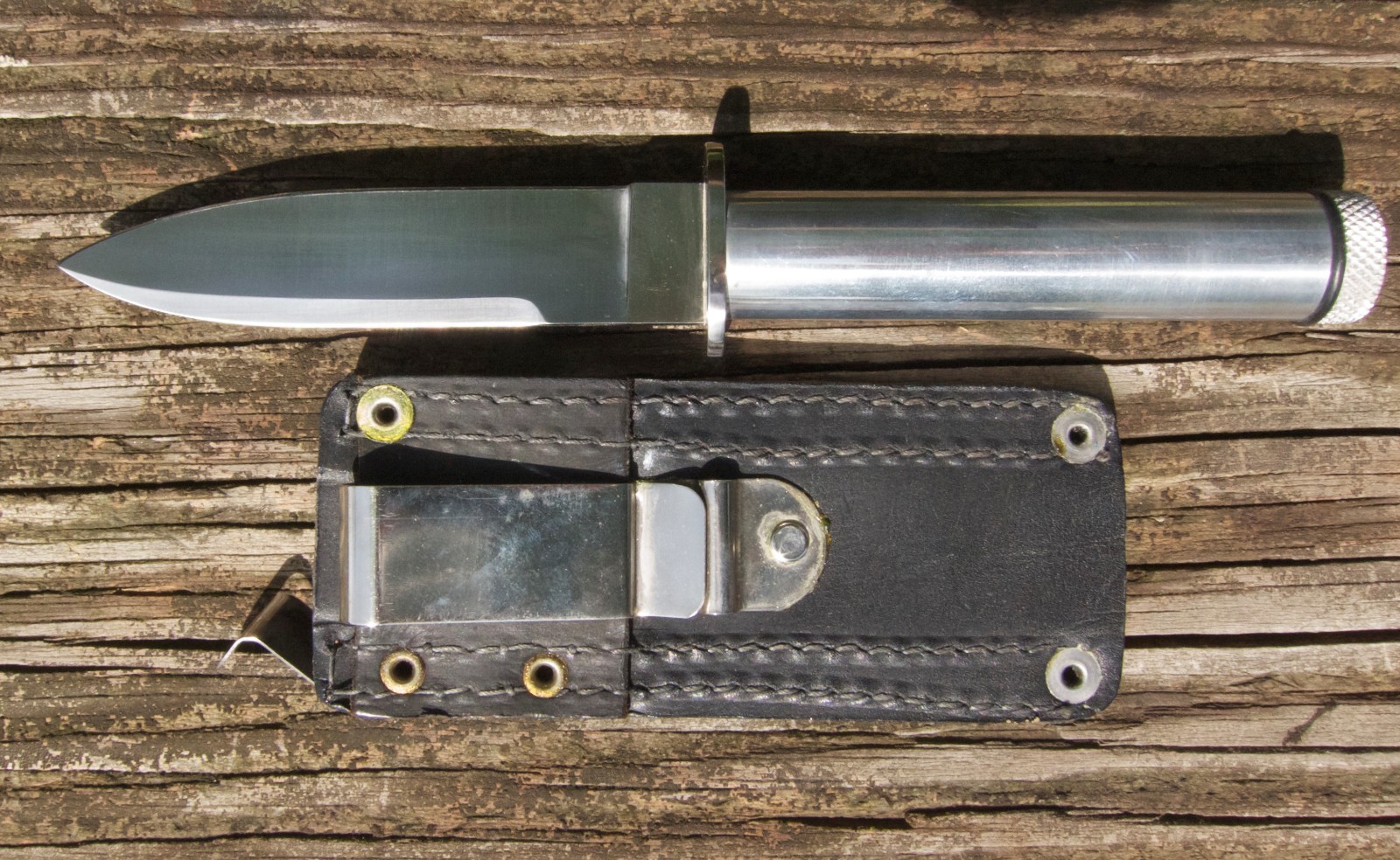

Does anyone own a Quicksilver knife by Dan Thornton? They were around in the early to mid 80s. I always wanted one, but they are hard to find. Blade is 4.5 inches. Handle is aluminum.

Interesting design, particularly the blade.

Damn, guess I've got a new grail knife to chase. Do you have any more info on these knives? Can't find much on google, anything you could tell me would be much appreciated.
