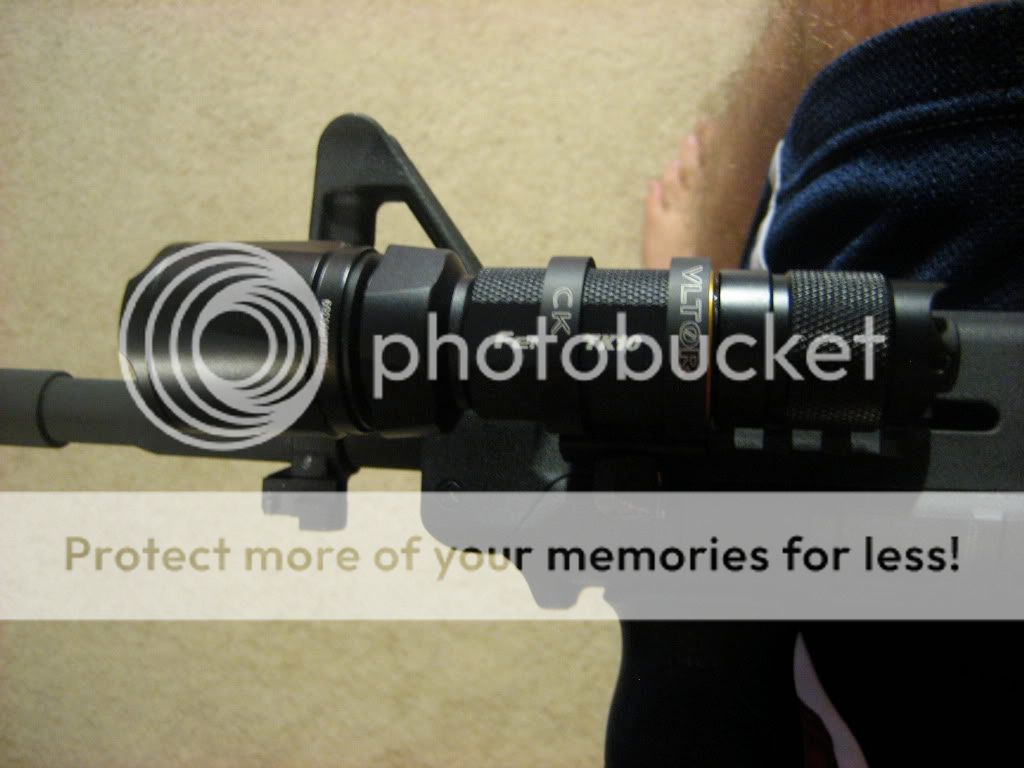

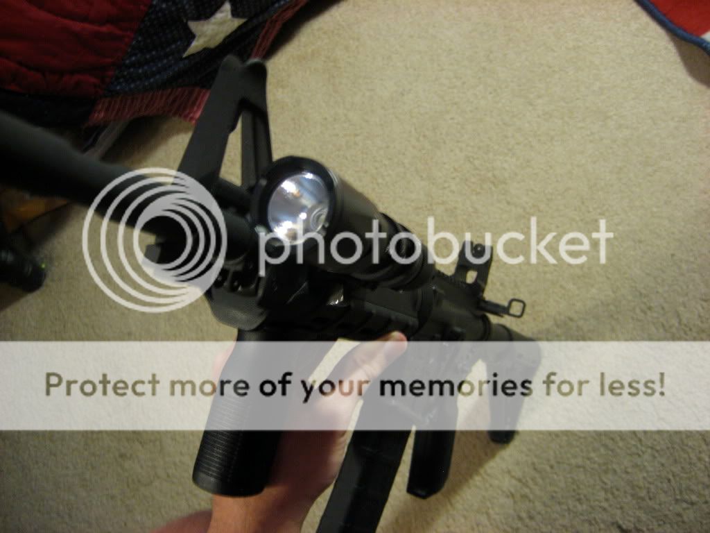

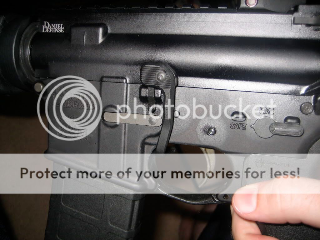

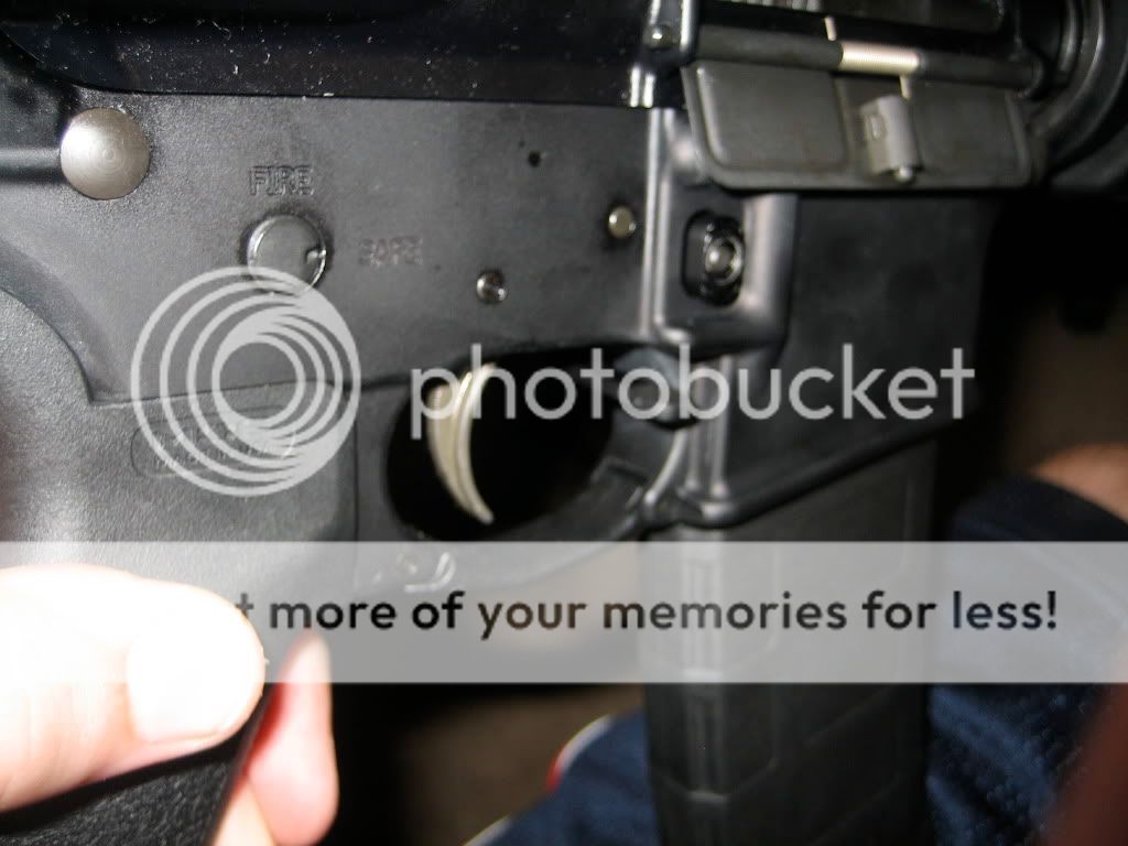

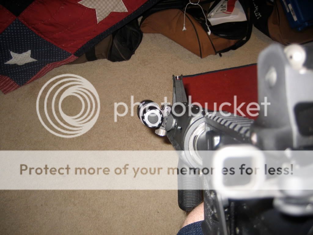

Heres an updated picture:
Fenix TK10 225L flashlight
Vltor SM-CK mount
Magpul BAD lever
Badger Tactical charging handle latch
Next up is sling...

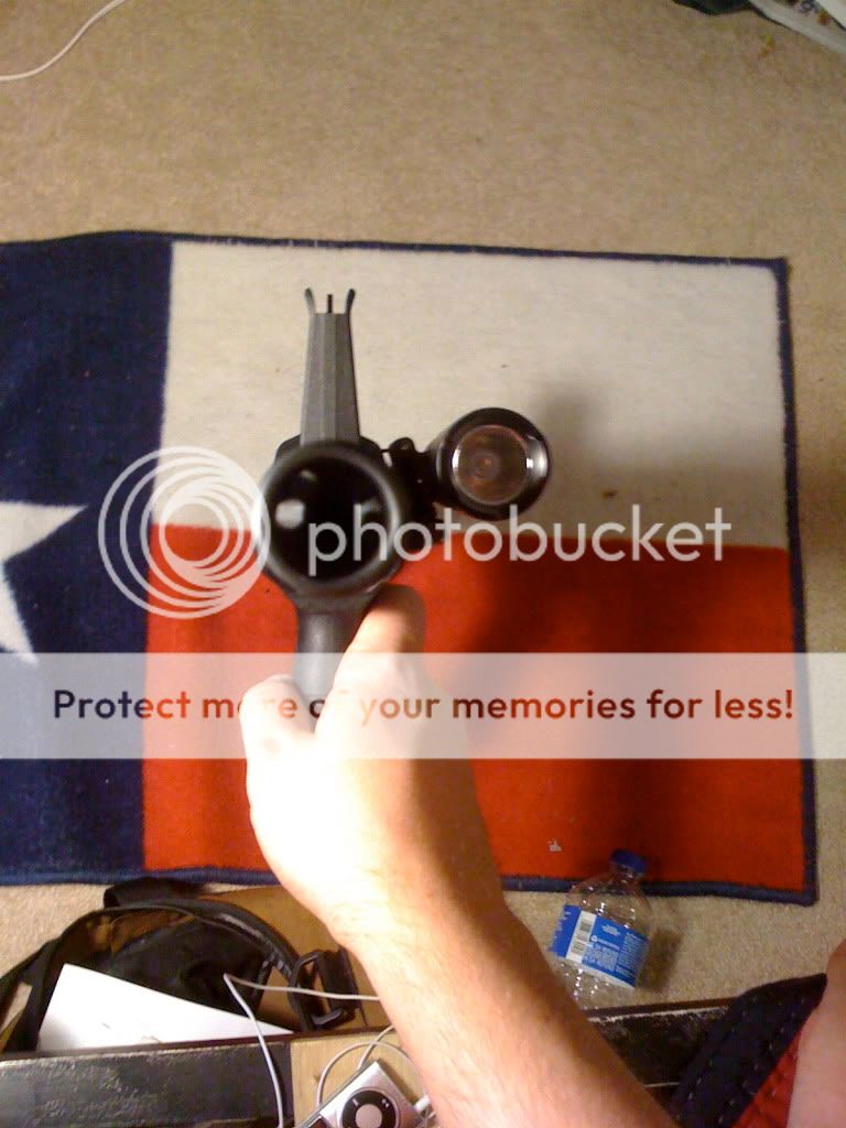

Picked up a Surefire G2 LED in a trade and got to play around with it in an abandoned industrial building at work. Really nice light. And, since this is an idiot's guide........

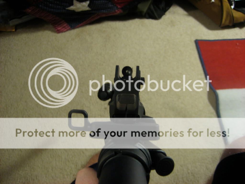

I picked up a Troy fixed rear battlesight. I mounted it nice and secure with blue loctite, or so I thought, drove the hour + to the local range and it worked itself loose w/in 20 rounds. GGGAAAAAAAHHHHHHHHH! Last night I degreased all relevant parts with some denat alcohol, using a bigger gob of loctite, and remounted it by cranking on the set screw like a teenage boy who just found a hidden stash of Playboy mags, and jamming it forward against the rail plateau. Hopefully all is well. If that works, and I get a chance to order the MOE and VLTOR stuff to mount the light, I should have some nice progress pics.
yeah, it happened to me too - the troy front sight and the grip screw. now i use loctite and put witness mark on every screw.
Paint pens are your friend! Witness mark everything you can.
Loc-tite is your BEST friend but it must be used correctly and liberally. You have to let it dry on the threads for a bit before you screw everything back together. Use lots of it. If you loosen the screw, reapply it before you tighten it down again.
