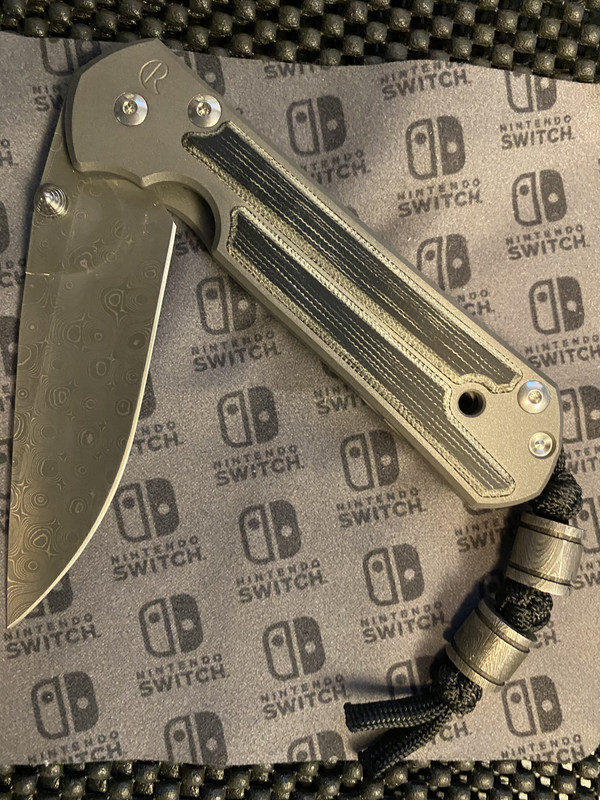

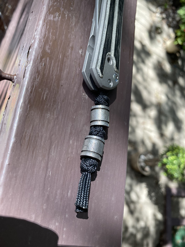

I’m looking for a good color to go with spyderco burnt orange.
Anyone have any suggestions?
