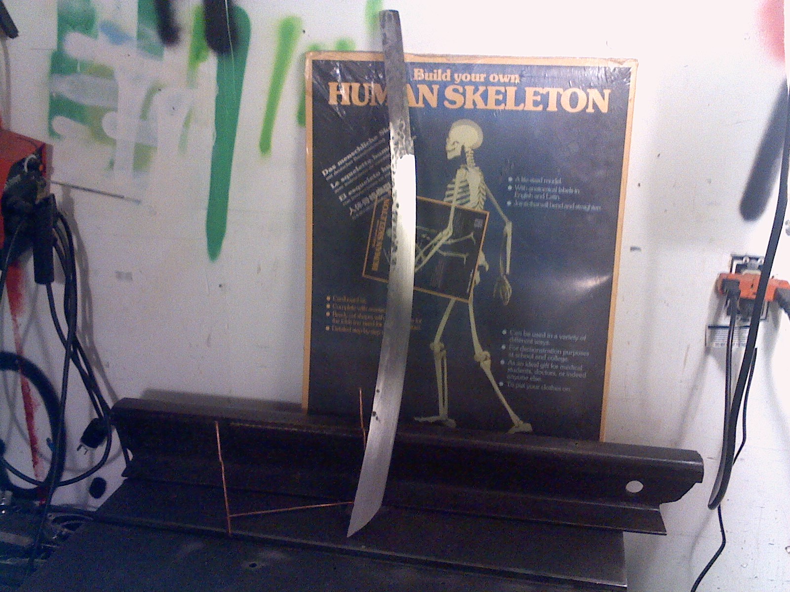

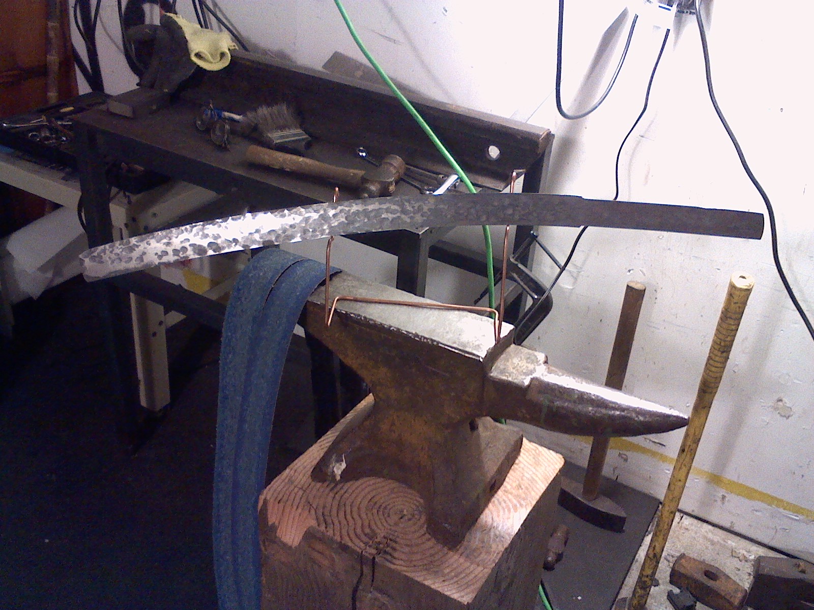

An Undergrowth Organizer is normally about the size of a machete. Now, a great customer whose brazen enthusiasm and snide hilarity is nearly matched by his large stature has want of a full-on sword-sized UO. Below are some wip photos of his exact blade being made, that show the current state of the grand attempt to develop the beta titanium sword blade, made as a weapon of old days past.

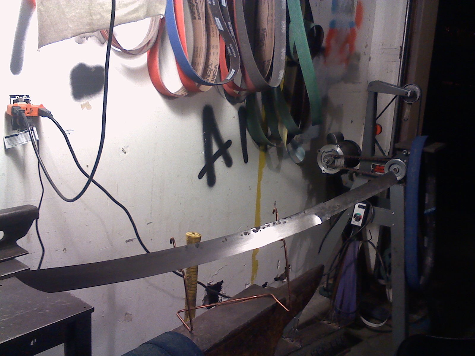

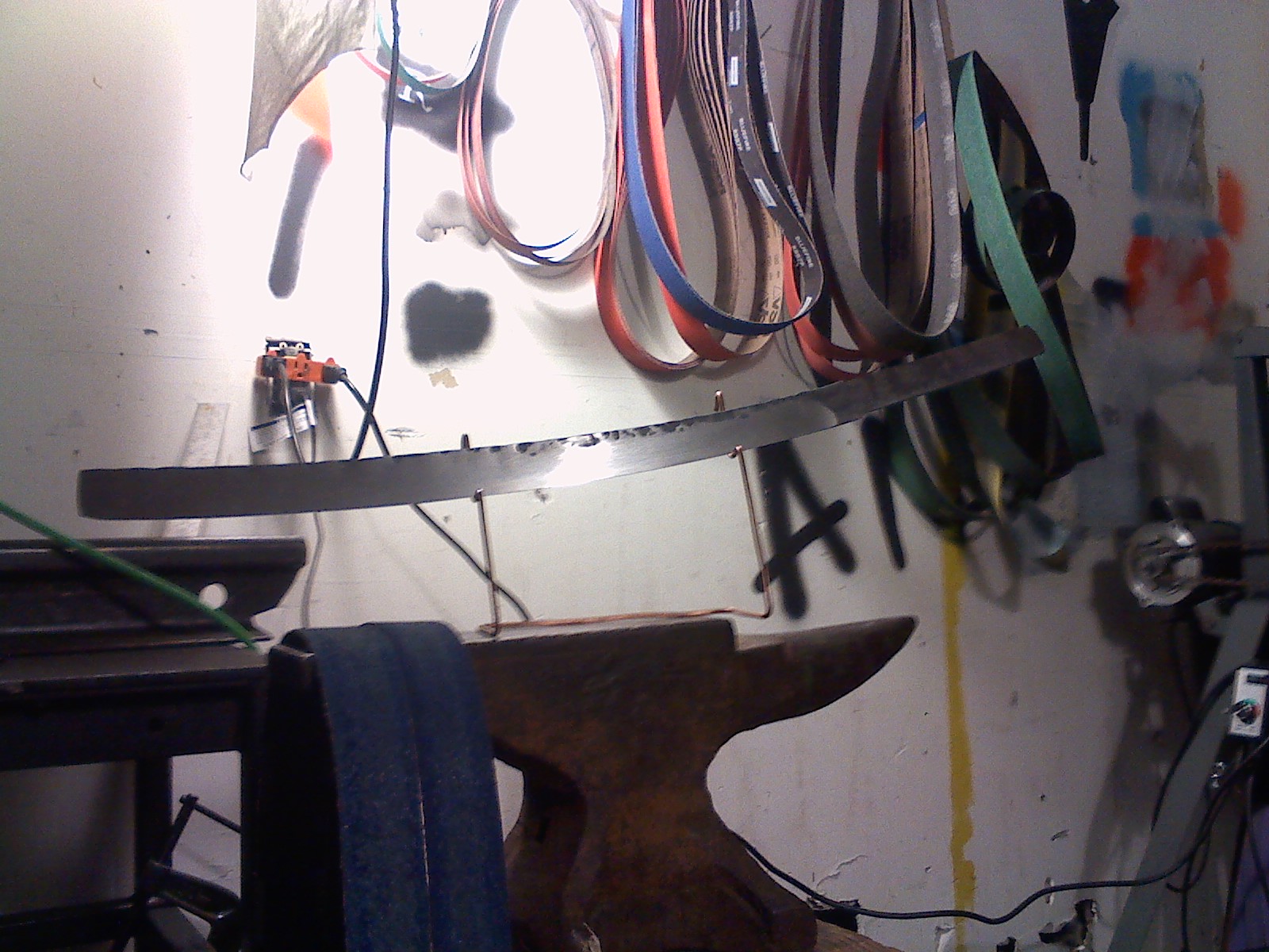

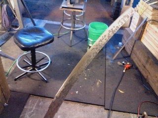

After a bar is forged into a proto-sword billet with a sword shape encased (with distal taper), the high spots of the silhouette are knocked off.
A dig into the edge begins the blade-grinding process.
I work it into a B.A.R., or "Big-Ass Razor," leaving room for refinement.

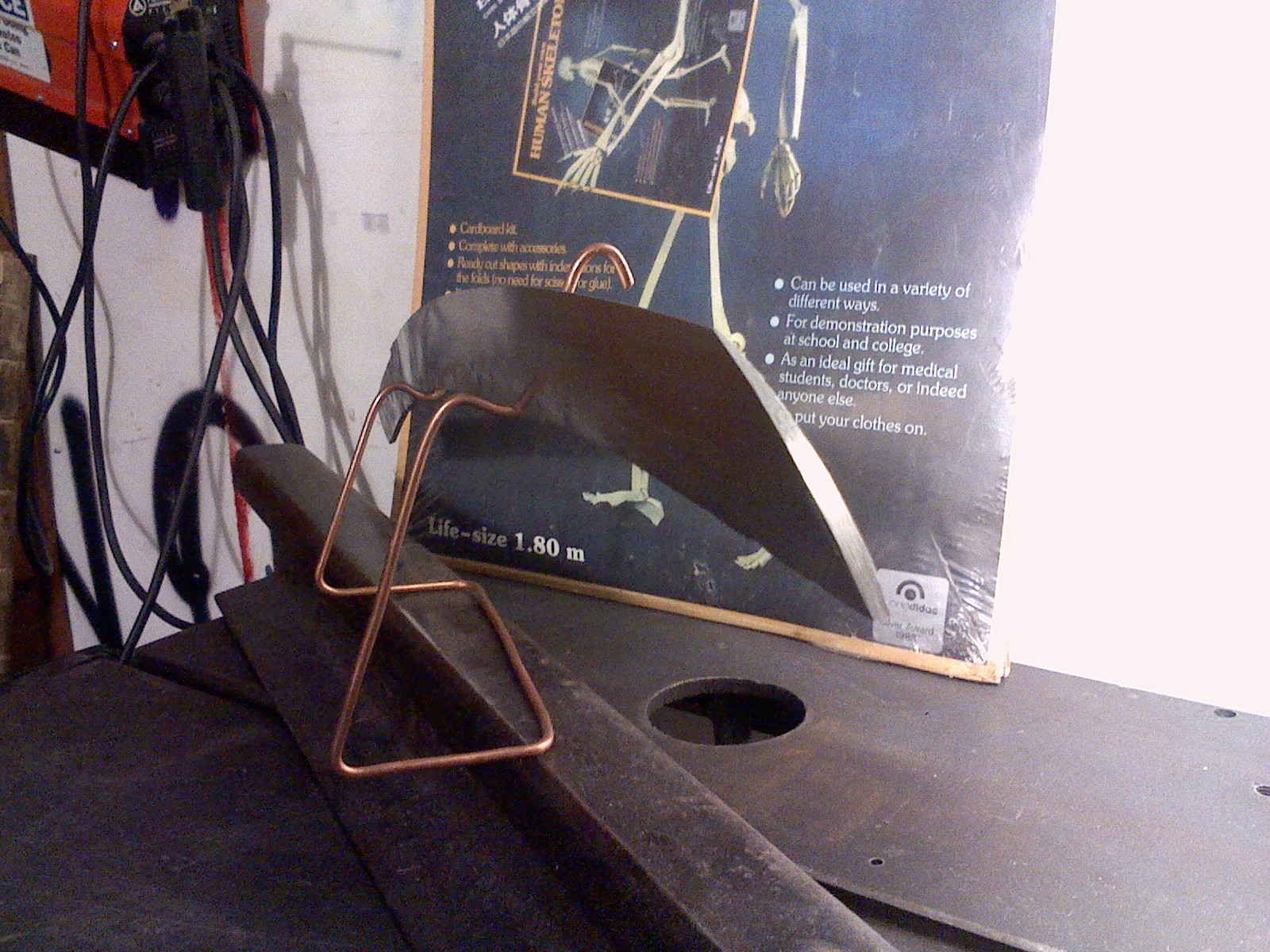

When it's getting close, the tip profile is shaped.
The tip is still blunt in preparation for heat-treatment.
Here the blade has been worked at 50-grit, and is almost ready for a mark, followed by a bit more refinement at 100-grit, then heat-treatment.
Thanks for looking, more photos to follow on this project.

Looking forward to seeing how this project comes out. What's the longest blade you can make with your current setup?
Everyone needs a BAMS! This particular edged monstrosity is destined for Bladeforums member [CLASSIFIED], a robust and unusual character.
Crimsonfalcon: The longest beta ti blade (as in cutting edge) I can make now is about 28" max, plus a grip of any length. The one above is 22" of curved edge, just over 30" total length.

Kohai999, ominously I have a 70%-forged, vaguely katana-shaped billet that is almost 40" in length! :D

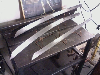

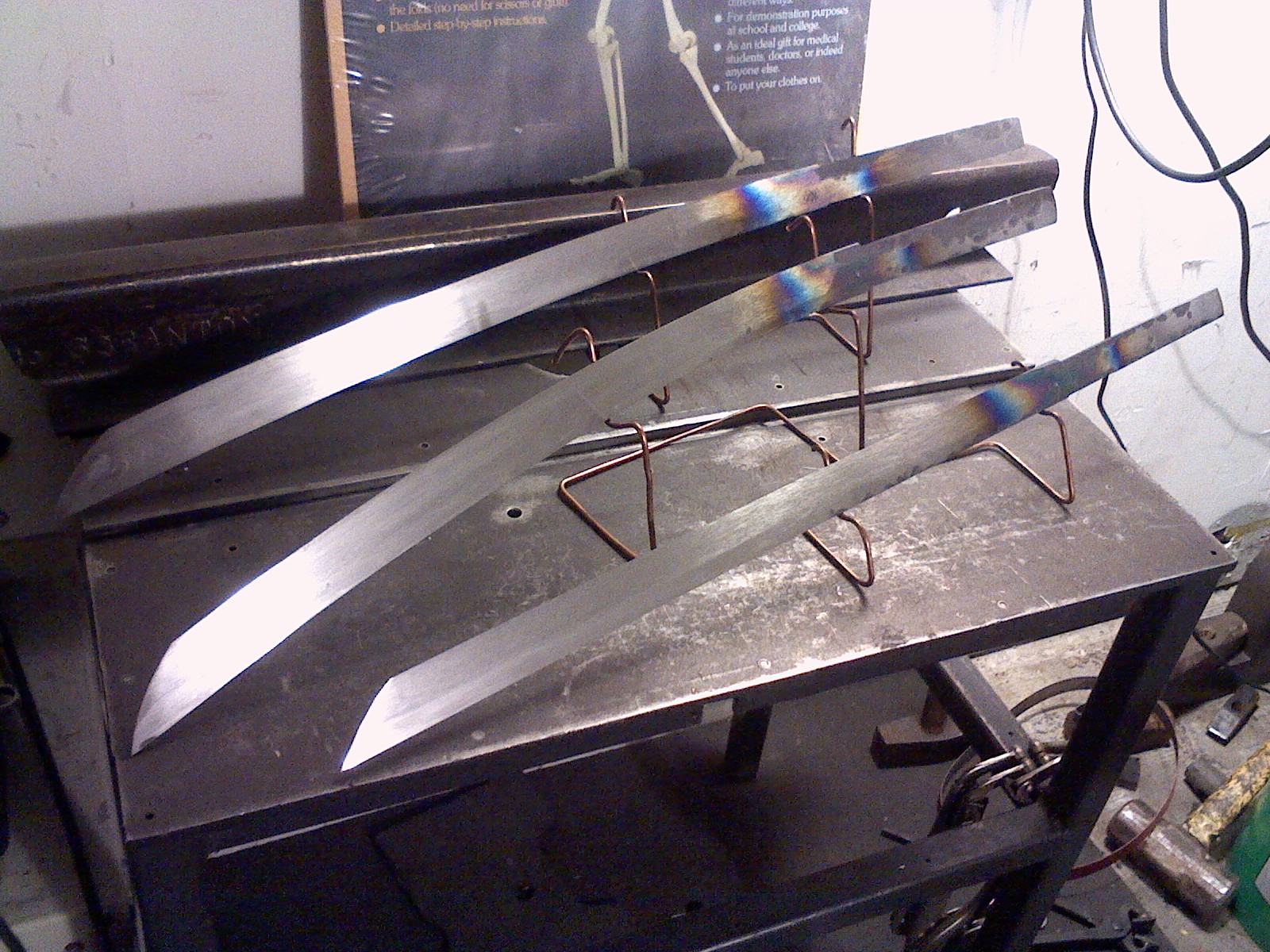

After more grinding, the subject blade (center) has been marked, along with two others. Now there will be more light grinding before heat-treatment, followed by more blade grinding and tang shaping! It's easier to make everything look more "crisp" if the final grinding is done after HT.

Sloth: These swords are all more than 30" in length, but a normal Undergrowth Organizer is about that size!
