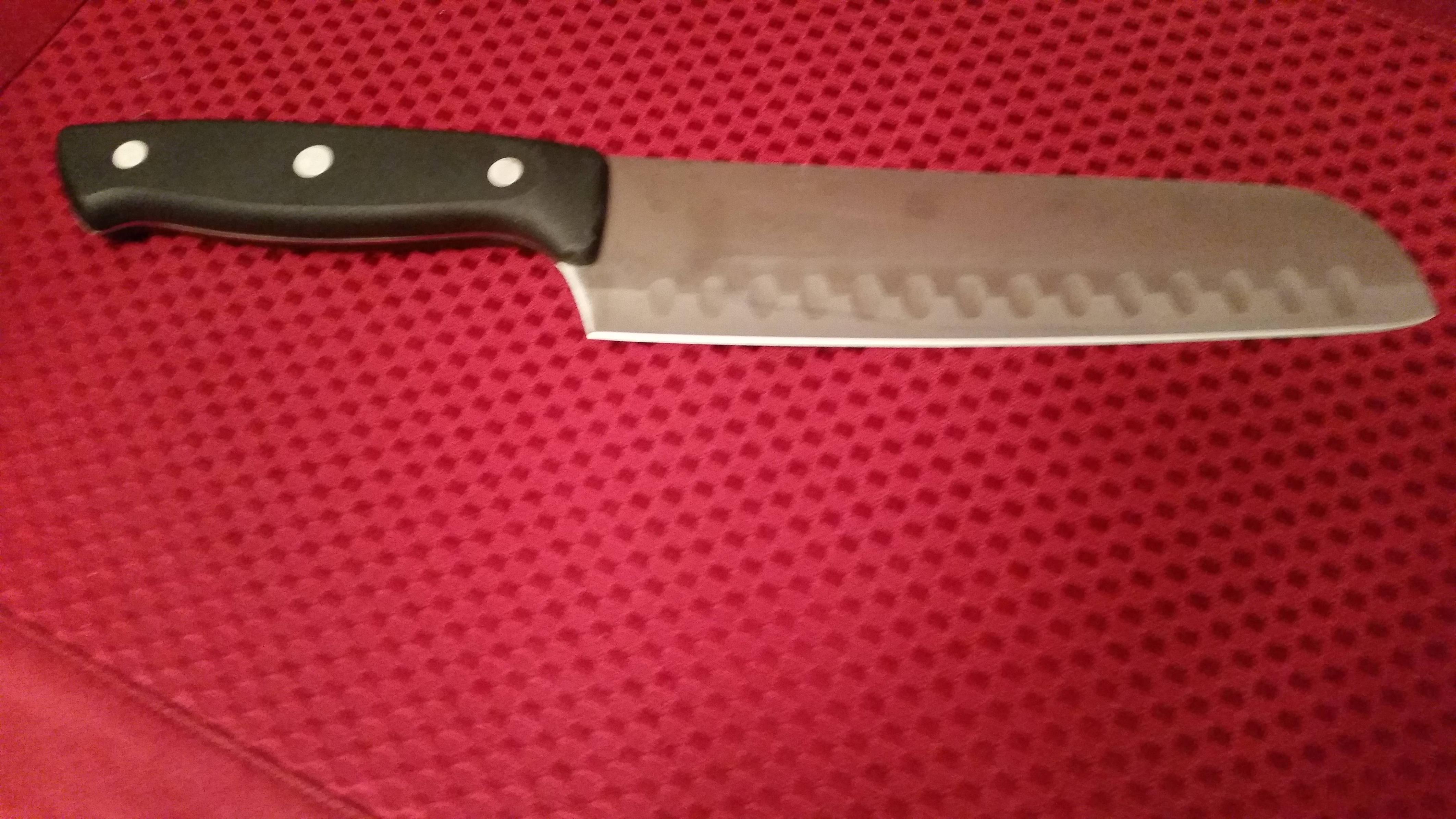

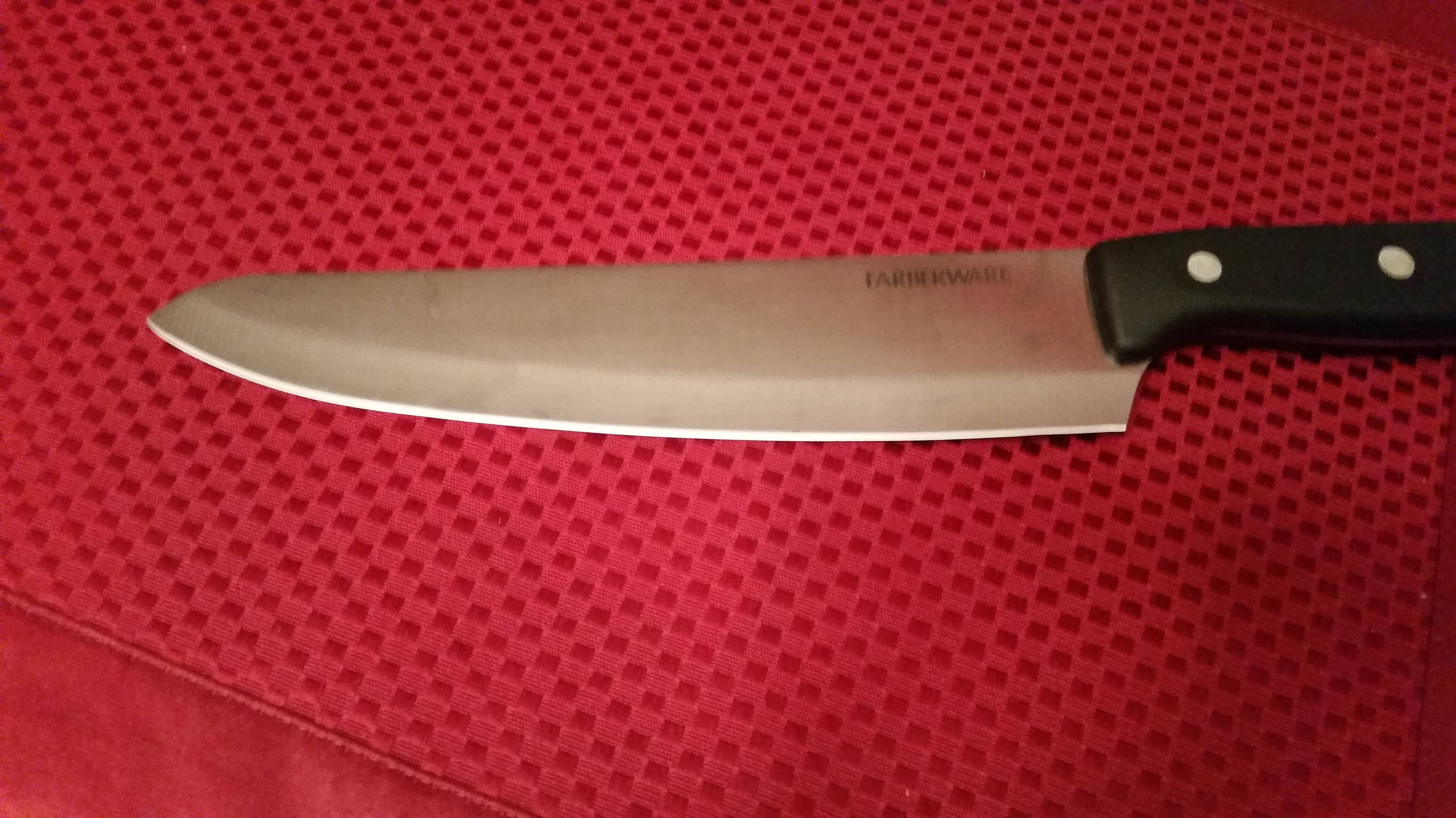

Ok so I just learned a valuable lesson, kitchen knives are NOT as easy as my outdoor knives...good thing I started on a cheap Faberware set.
I think this is from a combination of the 17° angle, thinness of the knives and less quality steel compared to my thick outdoor knives at 25° with I'm assuming better steel...dunno what Faberware uses.

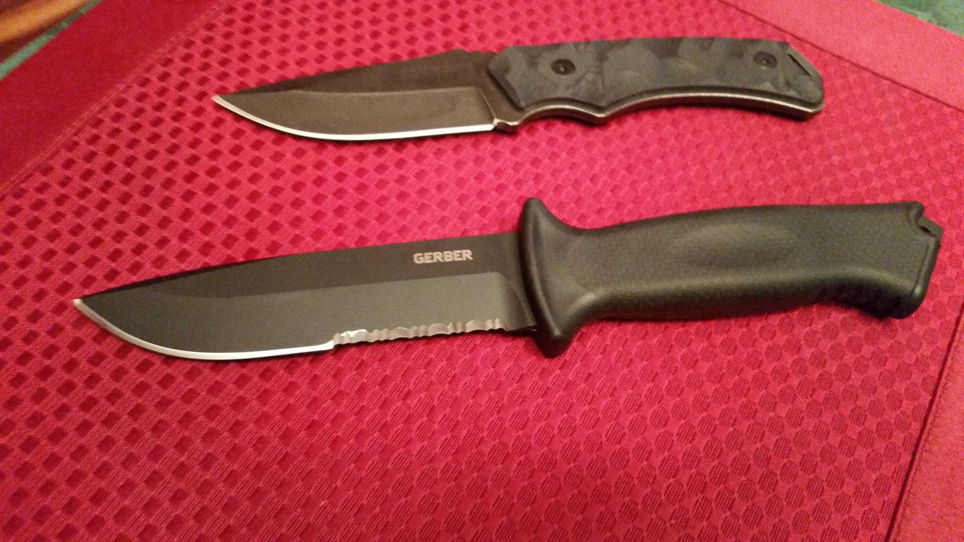

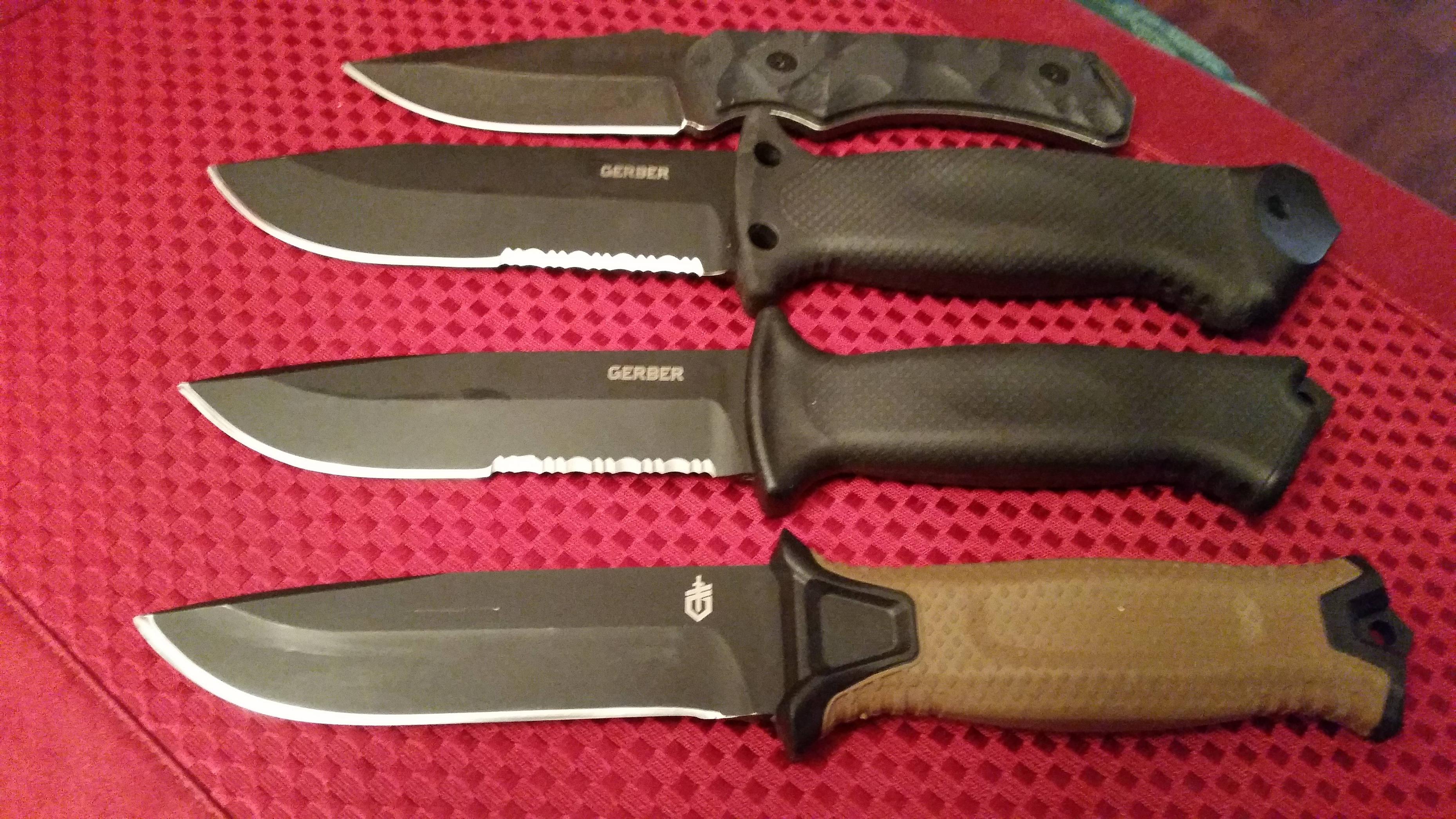

I'll have to keep practising before moving on to the good kitchen knives. The outdoor knives I feel comfortable with and blast thru em. Just did my son's prodigy, my wife's prodigy, an lmf2, and a schrade schf 14 I just picked up in the amount of time it took me to get 1 kitchen knife fixed lol.

You've just experienced what kind of blades I've been working on with my WSKO! Beaten to death blades that take longer because the edge is essentially flat. In many cases you can't really even call it an edge anymore because it's so flat and blunt.
You'll get used to judging this by examining the blade before you start. I look for a reflection on the cutting edge. The more easy it is to see the reflection, the more dull and flat the edge is and the more work it will require.
The good news is you got a respectable edge on that blade. Good job. :)

Yea with some work I got those 2 with a respectable edge. The real challenge is the small steak knifes (non serrated ones) the blade height is much shorter and they're in rough condition with chips in the edge. The blade height thou is what's proving most challenging, I can't rest it against the guards like the larger blades.
It might be time to try out some freehand without the guides. That's how I do all my blades on the WSKO.
In the more severe cases (deep chips, etc), I cut the edge into the belt at around 60 to 75 degrees. Not quite flat, but almost. In those cases, I'm seeking to grind out the chips and establish the shape of the blade first. Then I form a new set of edge bevels at the correct angle. Hopefully your steak knives aren't quite that bad off. But if they are, you cant do it. Just takes time and patience.
