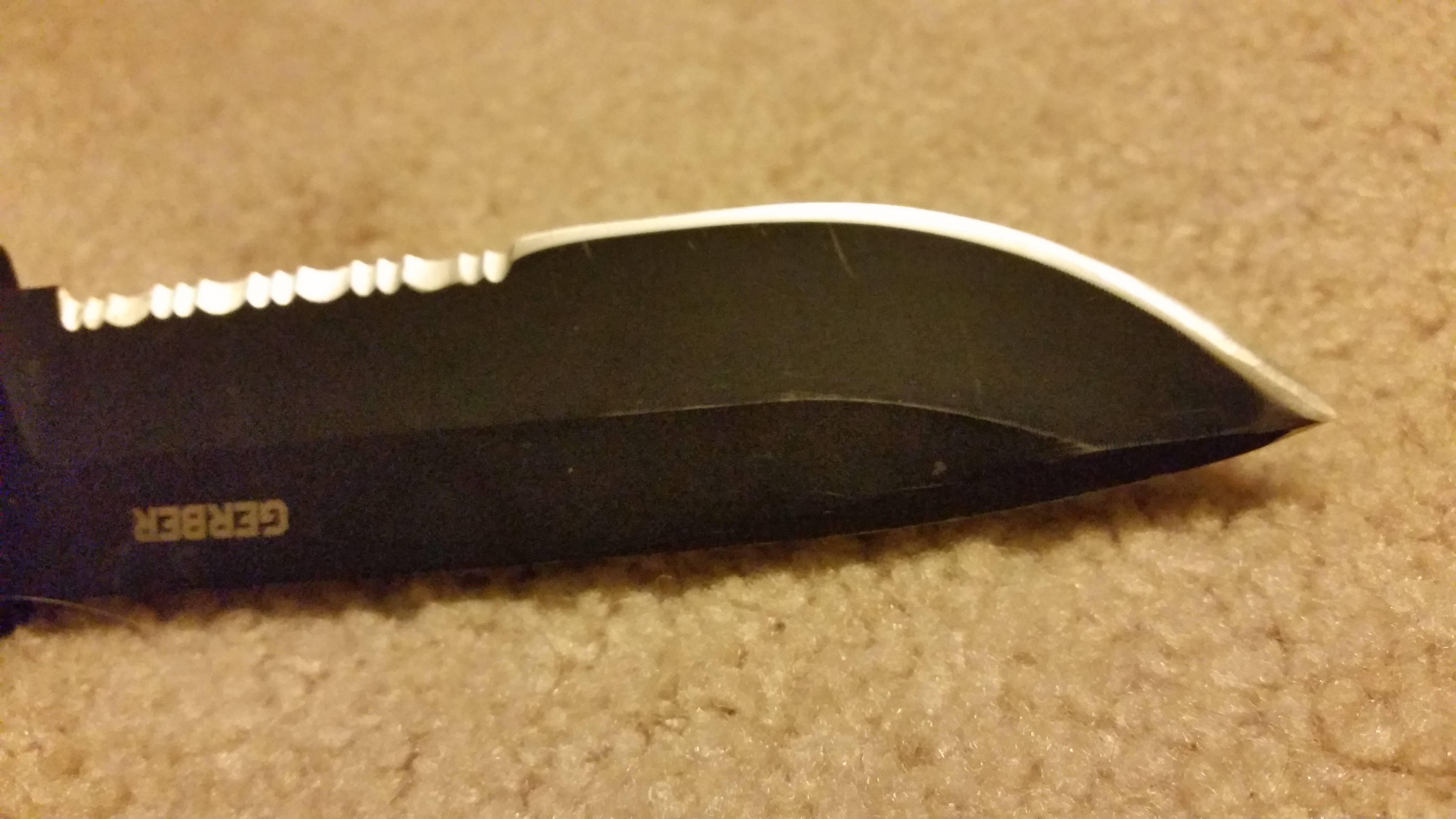

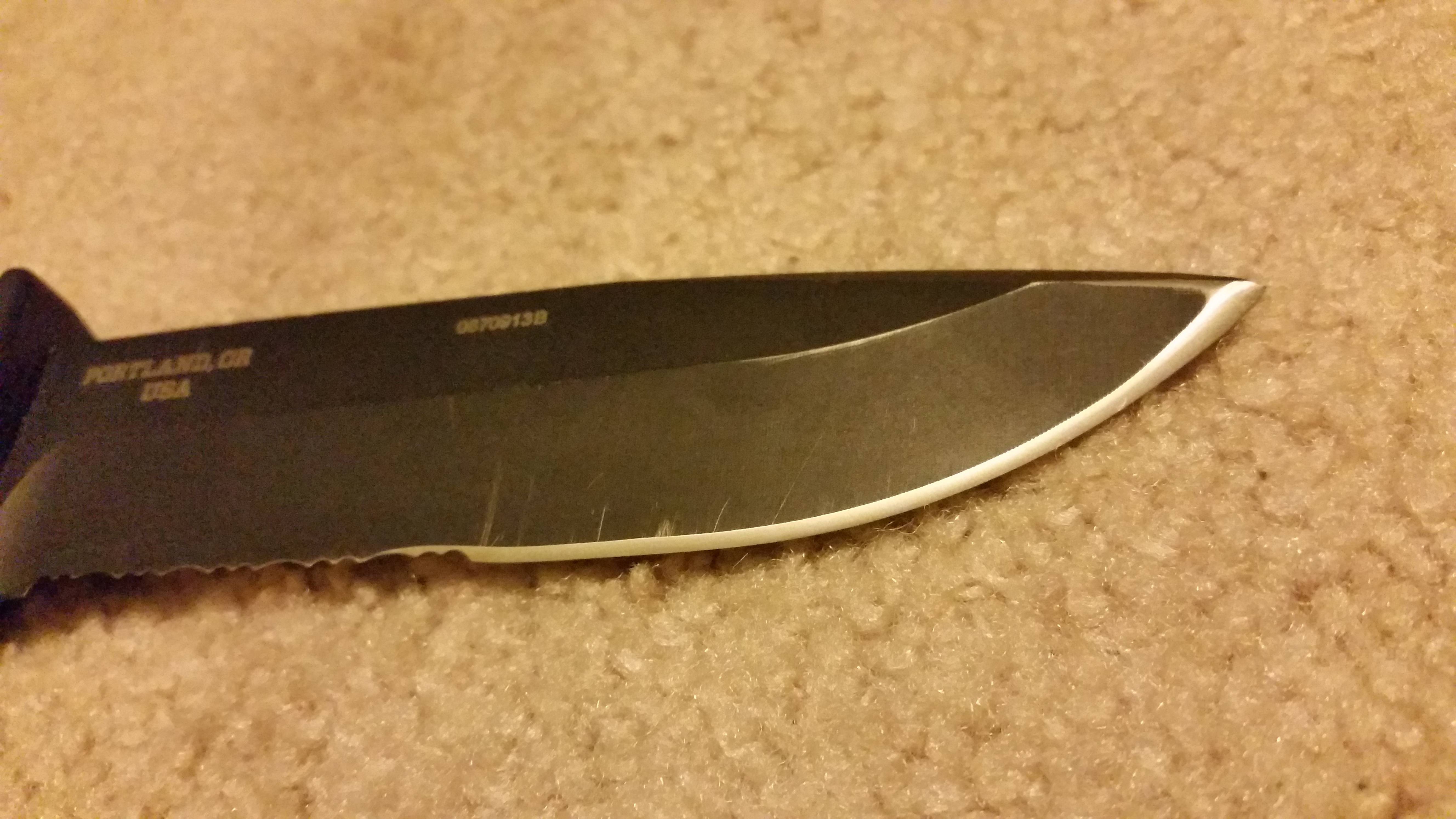

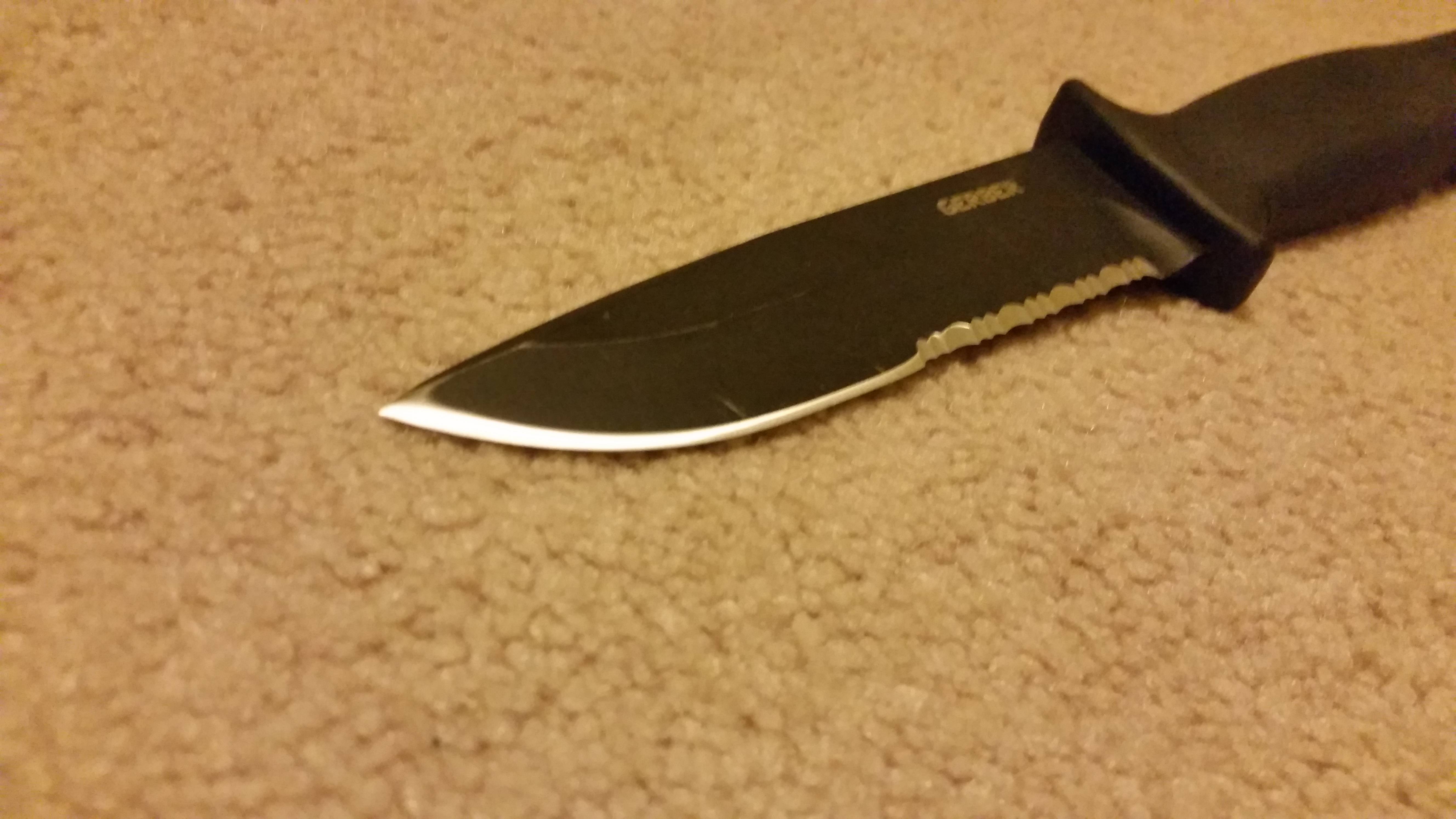

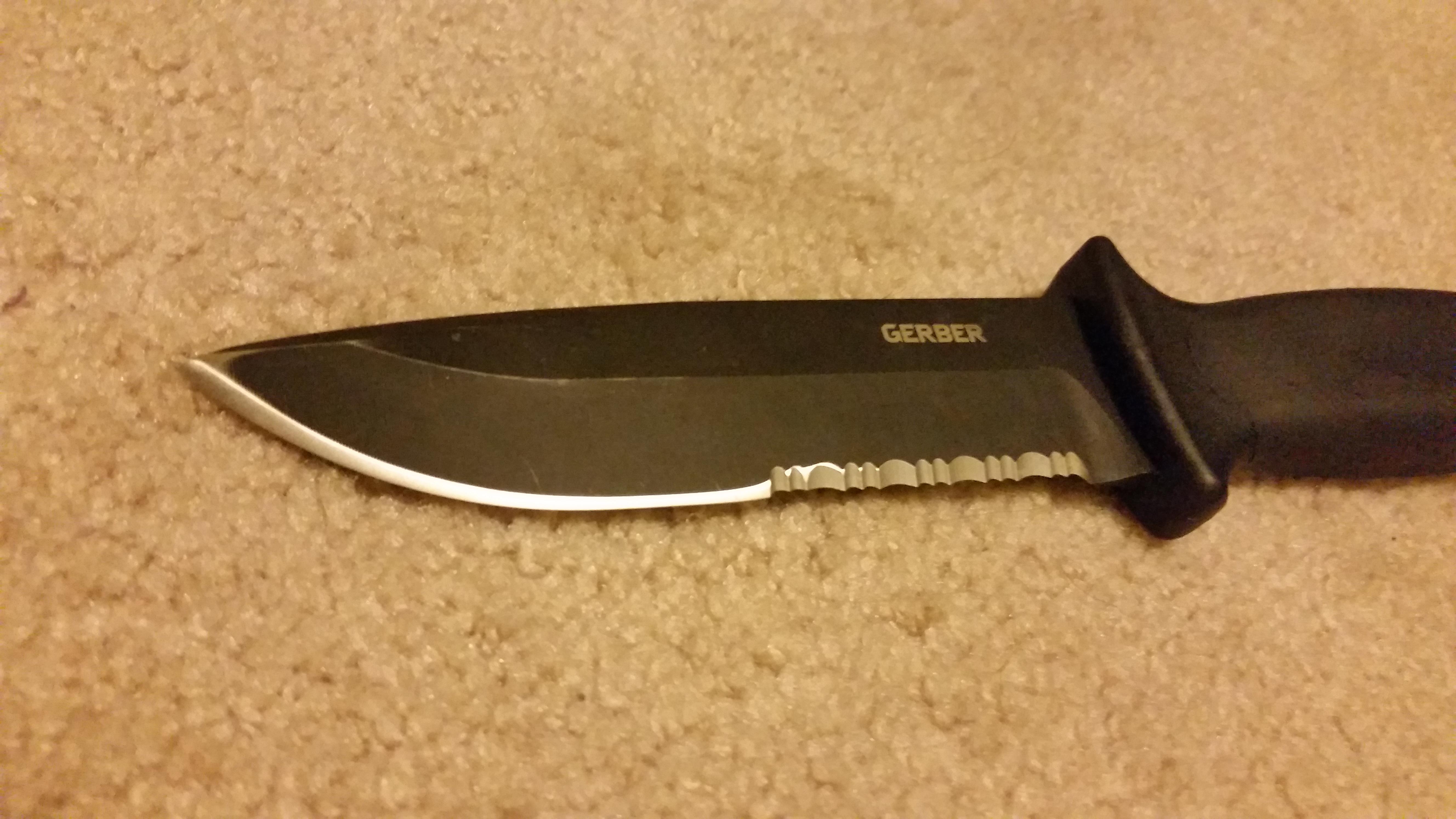

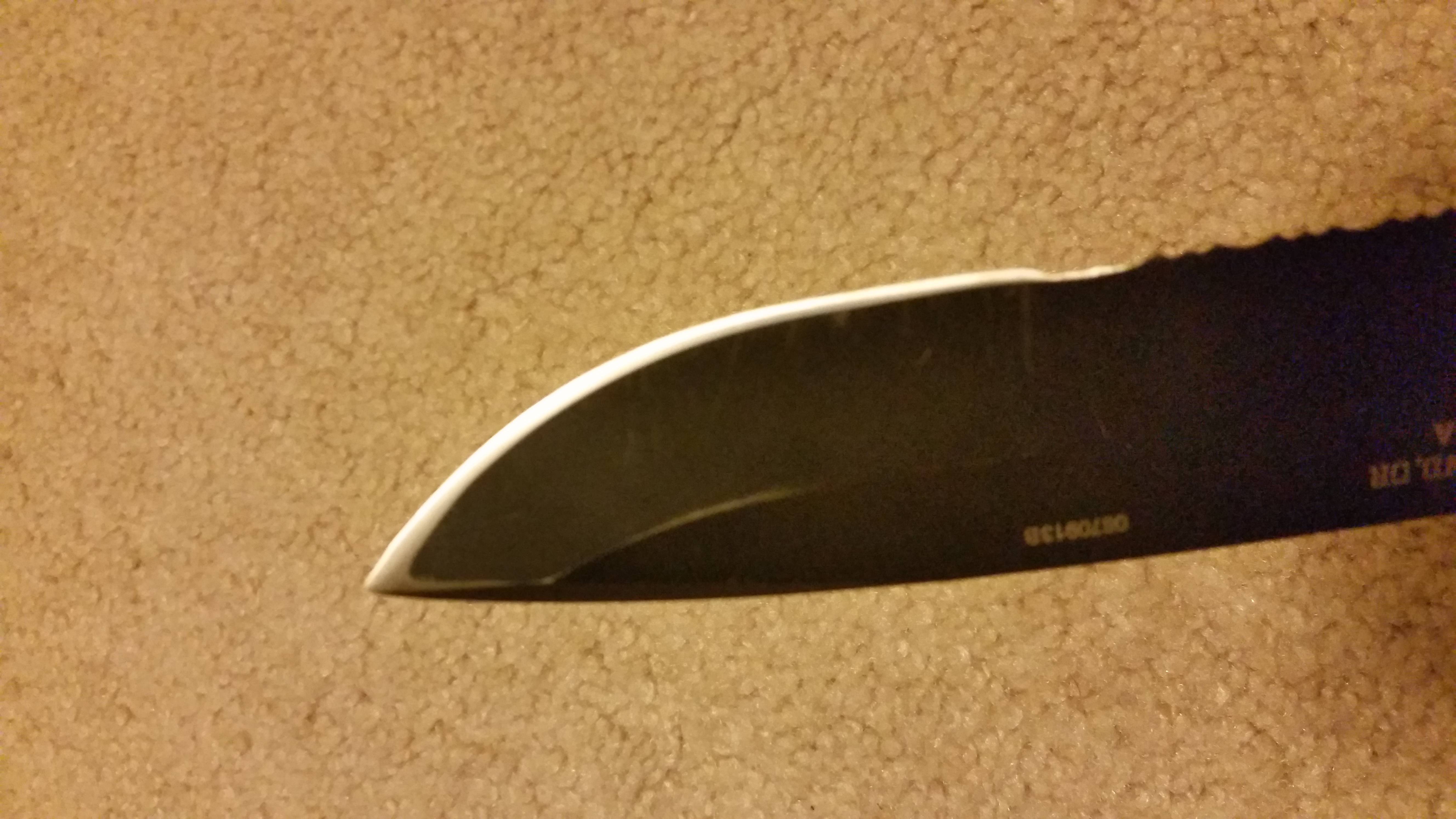

Ok I can't express enough how much of a life saver this machine is, my 12 year old step son asked me to sharpen his prodigy for him today.
I thought it was strange since I Just sharpened it a week ago, but told him to go get it.
I take it out to the garage and get everything set up, thinking it only needed touched up a lil I had placed the fine belt on in preparation.
Here's where my jaw drops, I unsheathed the knife and was in complete shock. This thing didn't need sharpened it needed major help, the tip was snapped off about 1/32" and all along the belly there were chunks missing from edge deepest one being almost 1/16". I don't know what the hell he was trying to cut or chop thru but whatever it was it was obviously harder than steel. I wish I'd taken a b4 photo of just how bad it was...
This would've taken forever to correct with stones and probably wouldn't have tried. After about 30 minutes of grinding steel off, I've managed to not only clean up the edge but restored the tip with the worksharp. I actually found myself free handing most of it especially around the tip.
This machine is a must have for anyone who actually uses there knives or has a kid like mine. Lol

That's basically what I had to do and why I ended up free handing a good bit. After like 20 passes using the guides it just wasn't removing the amount of steel I needed. I cut the edge into the belt to grind out the the chunks missing and reset the edge...
I'll have to look into those other belts, especially if this becomes a common occurrence with his knives...thou a few more sharpening sessions like today his poor prodigy won't be much of a knife anymore lol
Here's the after shots of the prodigy...I could've gotten the point a lil better, but I'd spent enough time on it already, taken off a lot of steel already, and figured he was just gonna muff it up again anyway so it was good enough.
